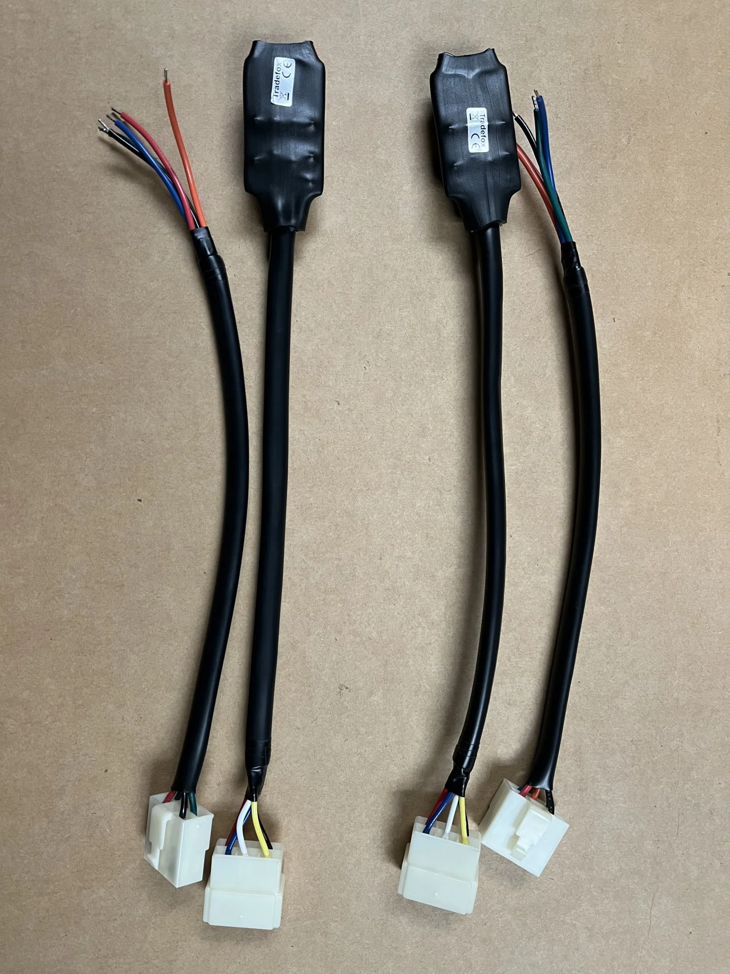

Juts got a couple of more of these modules, if some of you are interested in getting one.
It is a really nice feature, if you use your turn signal....

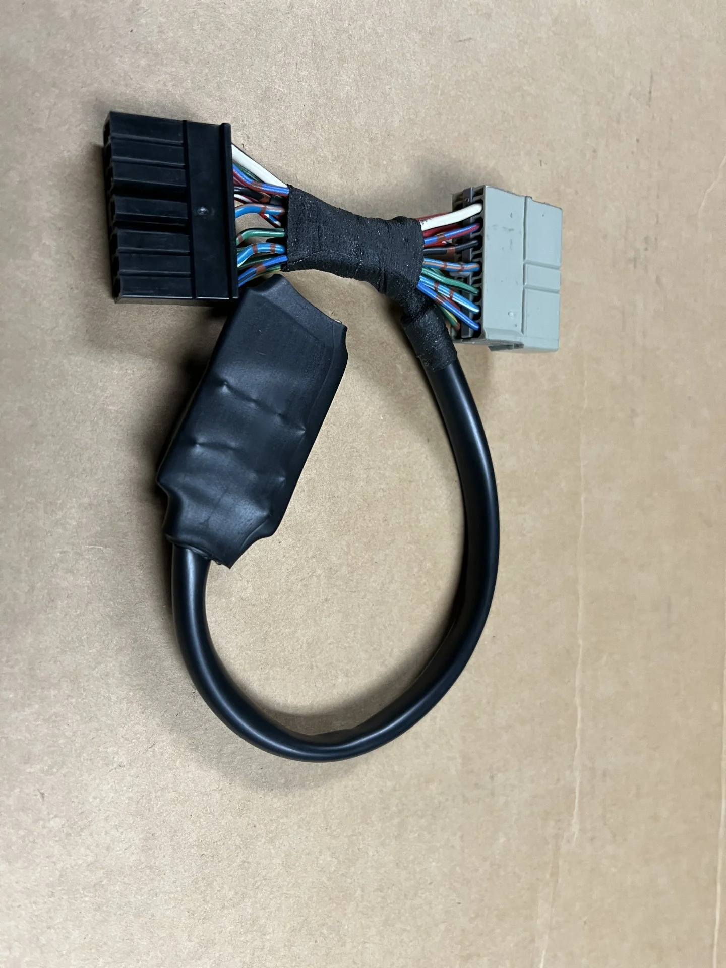

More than one of guys asked for it, so here it is for the 60s and 62s.
A true Plug & Play solution for the one-touch turn signal.
No cutting or soldering on the OEM wiring harness.
It takes about 2 minutes to install, no tools needed.
Just unplug the turn signal connector and plug the module in, you’re done.
You can get to the connector under the steering column without removing any AC duct or cover.
( you can see the connector in post #1, picture 1)
