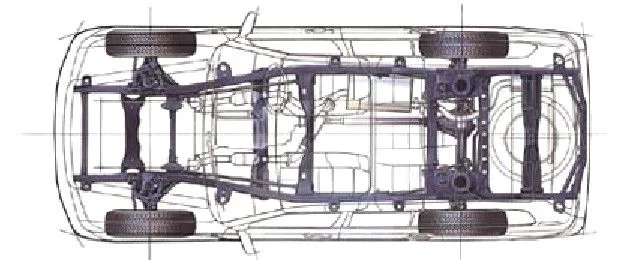

Also found a decent drawing pic to reference.
How does the crossmember mount idea sound?
I also like the idea of raising the crossmember in the same manner as the spare tire mod to tuck a tank a few more inches up into the hundy butt.

So the rear cross member is not needed to provide frame support?
The spare tire crossmember is indeed a structural frame support. I believe there are 9 in total. The lifted spare tire mod, as many do with spacers would also reduce it's effectiveness. By how much? Nobody knows.

I did not know that. It seems pretty flimsy to provide any kind of structural integrity.
"Kondo's team completely re-engineered the FJ80's ladder frame, adding three extra crossmembers (now nine) and beefing up the side rail structure. Each crossmember is set into the rails using new bracketry, which Toyota calls a flared-flange-type joint (see Illustration). Frame rail wall thickness has been increased to 3.2mm, and the boxed rails include internal stiffening plates welded within their front 48 inches. Kondo claims this helps maintain frame integrity during a frontal impact, keeping the front end from "folding up" into the passenger compartment.
Kondo says none of the Cruiser's frame components is hydroformed nor does any Toyota program currently use this increasingly popular method of metalforming (see June '97 AI, p. 57 and Dec. '97, p. 40). The new frame surpassed the benchmark Range Rover frame in bending and torsional rigidity, claims Kondo (he did not reveal actual frequencies), while boosting overall rigidity by 5096 versus the old FJ80's frame. The stiffer frame allows more compliant suspension bushings and body mounts, helping to improve the new Cruiser's ride comfort. Two types of body mounts are used: compression and lateral-restriction."
This picture is not from this article but it shows 9 cross members. :meh:
