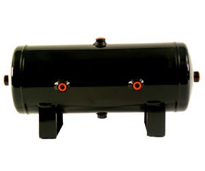

This tank might be a good fit in place of the spare tire.
Since my spare is still mounted under the rear, does anyone know if this would fit?
Can it fit above the rear crossmember?
Tank dimensions are:
Length: 19"
Diameter: 6"
Height when standing on legs: 7"
