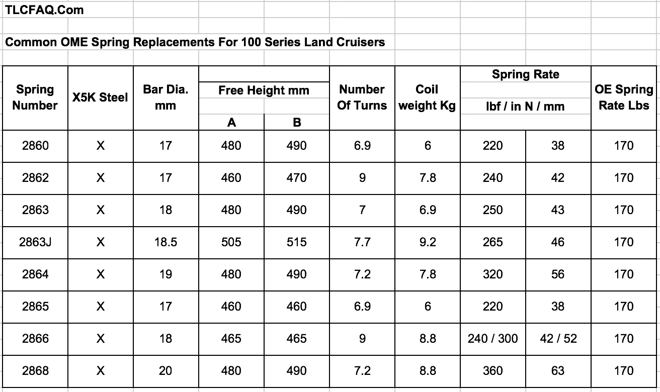

With the spring chat is the spring rate the amount of weight the setup can carry overstock?
i.e. for the 860 spring at 220lbf/in that is 50 lbf/in over stock.
Trying to figure out which direction to go. My setup probably is 50lbs over stock constantly and about 400lbs over stock when loaded for trips. Ideally I don’t want to lift the rear too much, but not sure there is a good solution since the weight difference is so great.
2865 and 2860 not gonna ride nice with a bumper, and also sag.
2866 or 2863 is gonna be the golden ticket.
Will just need to figure out how much weight you have and explore your options.
I've got 2865s with 300lbs and its a rough ride. They are rated for 250lbs and I am slowly re-installing my bumper. I am at about 200lbs now and I can feel the rough ride coming back.
I am converting to Dobinsons which seem to be the only option on the market that has a spring that only gives a 1.5" lift and can handle 400lb constant load.
The OME option that can handle the 300lb+ weight adds 2.5" lift causing the stinkbug look or forcing you into jacking up your front end, then naturally bigger tires, maybe a diff drop, longer links, and just going down the rabbit hole of lifting a truck that doesn't need a lift in the first place.
