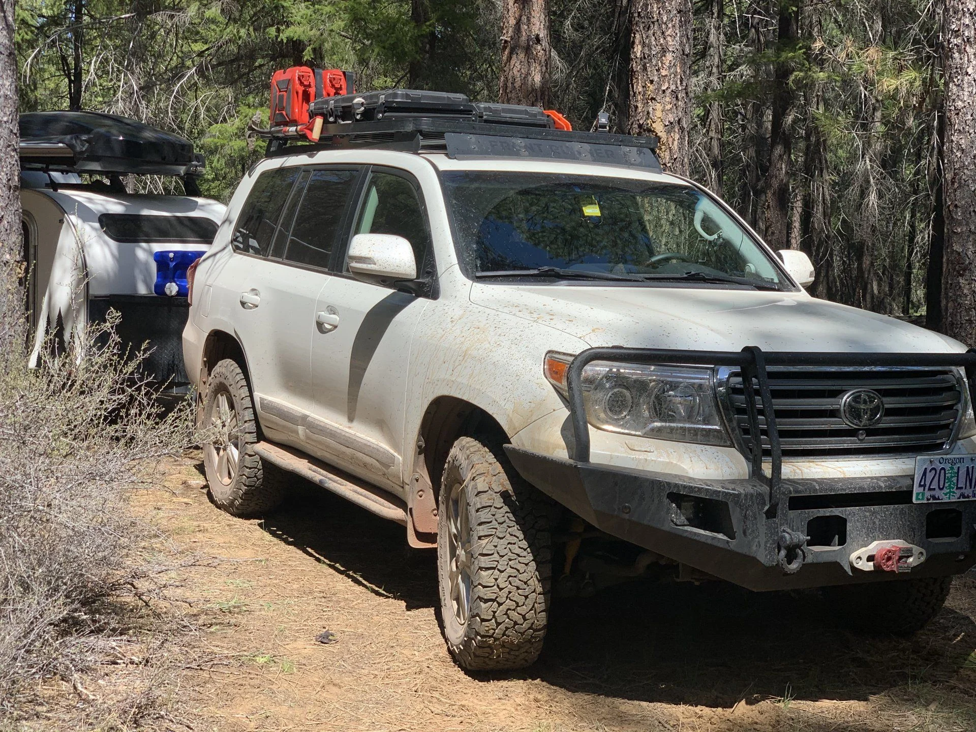

Here is a side shot of my Dobinson kit that's 50mm Front & Rear... I do personally like maintaining factory rake for loading/ towing purposes. Could not be more pleased with its on road and offload performance for the money. I am running 305/65/18 KO2s
