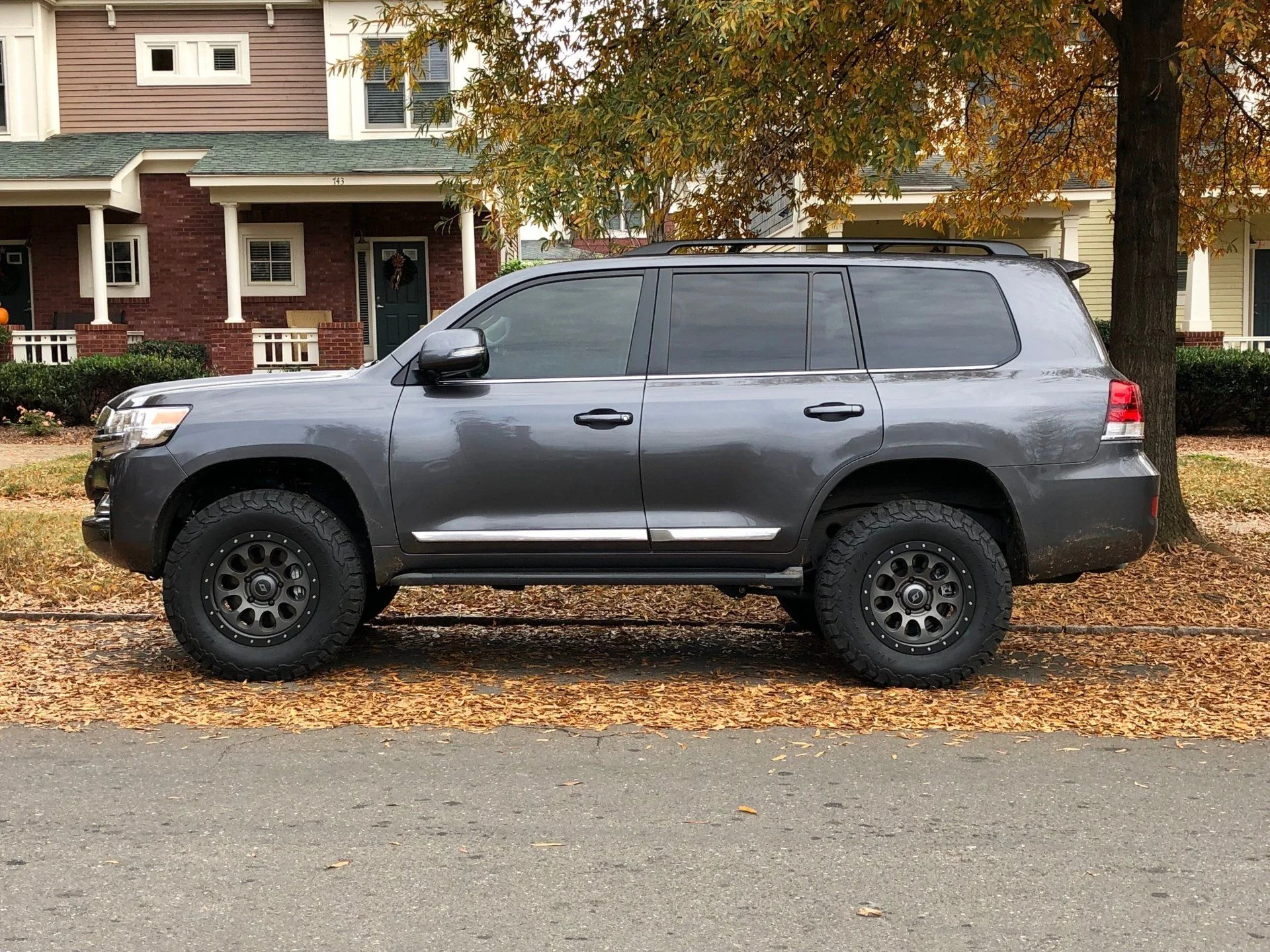

Just to throw out another option that I have not seen discussed on here. I am running the Dobinson "med" kit. offers 50mm of lift front and rear. Could not be happier with the ride quality. I have run OME on my 5th gen 4runner and had zero complaints. I don't think you can go wrong with any option.

Where did you get your kit? Part numbers to share? What tire size in the picture?
Josh @ Apex Overland ordered the kit and also did the install. He is very knowledgeable and does fantastic work.
Set up is as follows:
C59-542 Front springs
C59-545 Rear springs
10mm spring spacer
Dobinson Shocks all around
SPC UCA’s
305/65/18 BFG’s pictured

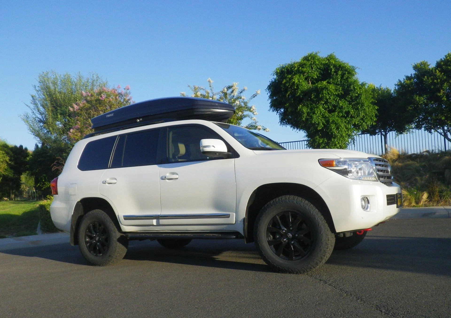

Just returned from a 1200 mile round trip journey traveling back roads that consisted of various types of terrain. This really broke in my new TD suspension (41mm foam cell fronts and 660# rear coils with 41mm rear shocks), and I have to say that the ride is almost as comfy as stock.. even with my KM3's. As stated, it aligned perfectly with no UCA, but I would definitely suggest installing the OEM front coil spacer if you want it to sit level though. (part no. 43136-60020)
