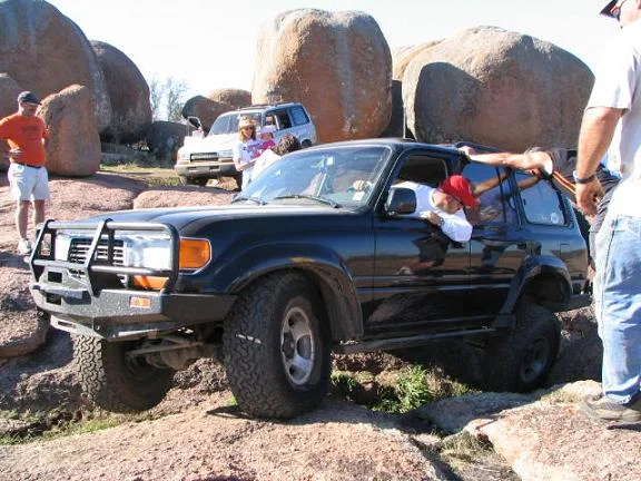

Wife was running this setup. Liked this setup only problems was with 2.5+Mr. Gasket spacer streched one front shock to far & had to goto shocks for
J-springs up front. Oh & wifes running 35's. Since replacing shocks no issues.
My understanding is Mr. Gasket spacers are only for the front, none for the rear. Mr. Gaskets I used to get rid of a unlevel truck.
*If you want rear spacers, might have to give Christo a call.*
Nice flex on the cruiser! I am pretty sure you can use coil spring spacers on any corner of cruiser that is sagging or needs to be leveled out. I just want them for additional lift. I have my Hanna rear bumper which is built for a tank :cheers: , and does weigh a ton! My cruiser looks really even now no rack in the front, would do you guys think? Go with the spacers? To me it just seems like too much weight in the rear with my Medium 860's? Here is a pic of cruiser:
