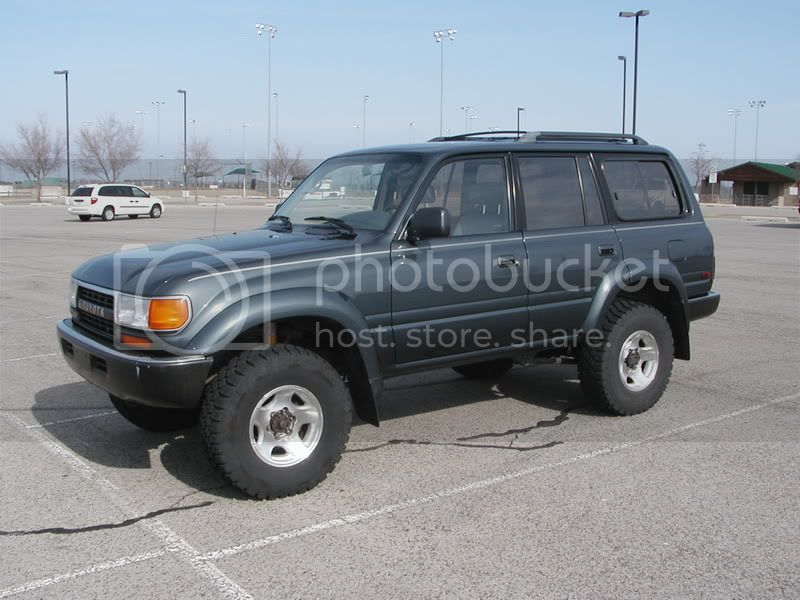

OME 2.5" lift w/ 1" Mr Gasket coil spacers
This is my old '93. OME 850/863 w/ Mr. Gasket 1" rubber spacers on the front only.
What size tires are those? 33's or 35"s? They look like 33's.

How did the handling differ when you added the extra 1" Spacers? I have heard from some its fine and others its squirly, your two cents?
Thanks
Handling is still the same from when I didn't have the spacers on. I don't think there should be any issues with with just a 1" spacer. After all it is only an inch :) ..
Adding that additional inch can still affect caster. It can take a "drivable" vehicle and make it very "loose"
yes, but with a 2.5" lift, it should be fine, plus I do have the OME castor correction...
