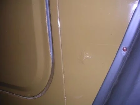

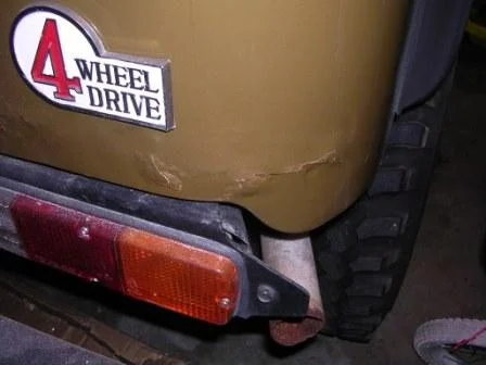

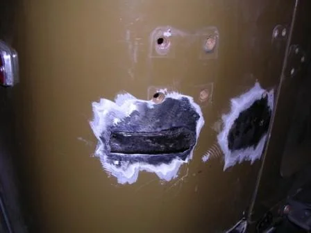

But of course there was the body, which I had sized up as "doable" when I bought the truck. We'll see. Pics below

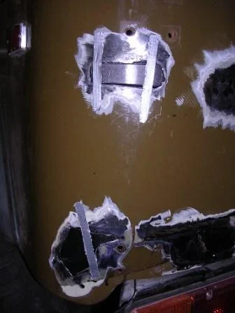

So obviously I got impulisive and just started into the driver's side behind the tire carrier where it would not be too ugly. I quickly learned that when you see something like what is in the pictures above, it means that all kinds of scariness might be living underneath. With the help of Randall's nifty cutoff tool and a couple of grinders and wheels, I discovered severly cancerous steel and disgusting necrotic bondo. Time for chisels and the auger, then back to the power tools
This truck had been hit with the pancake makeup years ago, then had rotted, then had been very superficially redone by the PO. The rot is at the contact points, so under it are the various tub supports and lips. Thus there are two layers where you have to look for solid steel. It started shaping up after I got aggressive. I hit the inner braces with some converter

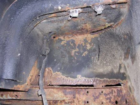

The view up into the rear from underneath really tells the whole story. Rust was worst right at the seams.

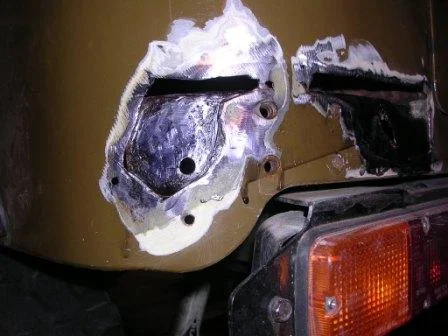

I cut out a few patches to get an idea of what the welding was going to be like. The curves aren't quite right, but the pieces fit well and I do believe this will work.
Good thing I am taking off some time at christmas, I am going to need it.

dave.... that is so sad to see. did brad ever say how much he had into it with the body work? supposedly the rot, either all or most of it was cut out and replaced. i am VERY curious as to whether or not this appears to have actually been done - what do you think?
I have seen zero evidence of any cut-out-and-replace repairs having been done. I see lots of evidence of lots of bondo over poor steel which just got more poor as the truck sat uncovered. I sure hope Brad did not pay for proper repair and then got this.

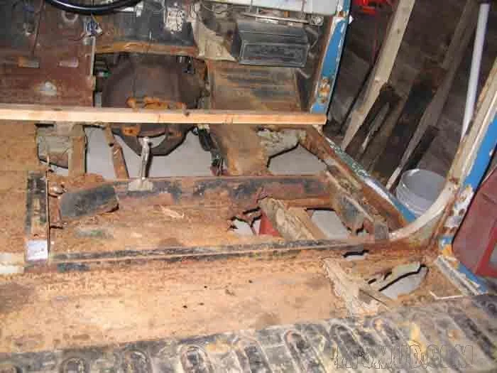

Dave that really isn't too bad. below is what i had to deal with. my new floors were made by the heritage people there parts used to be distributed by $OR but i think now CCOT is the sole distributor. anyway they use a very nice zince steel that is really nice and easy to weld. i welded my floors in pretty easily. toughest part was cutting out waht was left of the old floors. I would seriously consider replacing the whole rear quarter with onne of the heritage fj40 rear quart panels, http://www.heritagesheetmetal.com/ bad metal tends to be deeper than you think or can ever see.

Glad to see you're going about the repairs in the right method. The result might have a few waves but I'll take that and solid over what you're starting with any day. FWIW Bud at Budbuilt has/had some more quarters made up in my design. Before you invest too much time you might consider a complete reskin of the quarters at least. :) Keep up the good work.

I may have been a little flippant before...please know that I am not trying to cast aspersions or even doubts about the work that Brad had done, because I don't know exactly what was done (or supposed to be done) and where. Perhaps the bad spots now are not the spots that he had worked on. All I can say is that I have found no evidence of anything but bondo in the areas I have touched (d.s. qp and d.s. fender) and the fenders were definitely worked on since Bill owned it. Brad might have gotten proper repairs somewhere else.
Thanks for the other supportive words. Yep, I know it could be a lot worse and I am enjoying trying to do it right. No doubt it will be "wavy", but that is fine as I expect to get a few dings along the way. I do think that new qp's would be a good move, but I don't think it is necessary and I know that it is a lot more expensive. That said, I will ping Bud.
