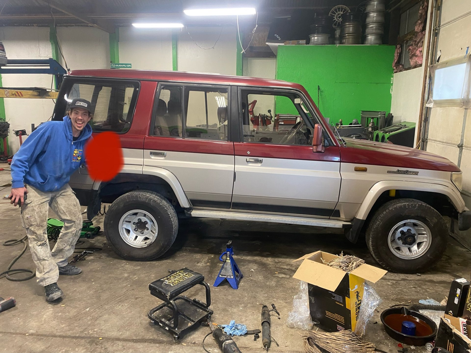

Just had my mechanic install Old Man Emu springs (light) from Cruiser Outfitters. With a couple of guys sitting on the bumper it levels the whole thing out. Outfitters told me to drive it for 500-1500 miles to let the springs settle in... This rake angle seems extreme. Is this normal?? The front springs were almost identical to the originals. The back springs with a little over 2 inches taller. I was expecting an even 2 inch lift across front and back.
Sorry about the guy. That's not me. He was hanging out at the shop...
That looks very similar to the way mine sits with OME Mediums (I believe) in the rear and stock front springs with 30mm spacers. I measured approximately 60mm of lift in the rear with that setup over stock springs. I find it hard to imagine that coil springs will settle out much, especially compared to leaf springs, but I could be wrong. Were the frame end radius arm bolts loosened and then retorqued once the rig was on its own wheels again?
Thanks for sharing your experience. I don't know about the frame end radius arm bolts. I'll ask the mechanic. He replaced all the bushings as well. So Imagine he tightened them up, but I don't know if that happened in the air or after.
Now that you've got me thinking about spacers I may measure the required lift on the front and buy spaces to square things up front to back.

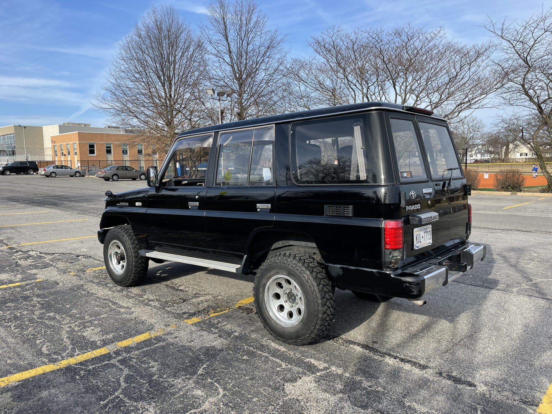

I have a similar raked look with the newly installed ARB/OME setup on my LJ78. Went with new OME shocks as well. Originally the lift was pretty even, but whatever settling occured made the front sit lower than the rear.
Same here. I have the OME medium springs and my back end sits a little higher than the front. I don't mind it.
Thanks for the reply. I like the black and your wheels too. Are those wheels specific to the 70 series or is there another Toyota that has the same bolt pattern and cut out for the hub lock?
Wheels meant for the 4Runner and 80 Series Land Cruiser, FJ Cruiser, etc. will fit :)
Check out this site for info on the bolt pattern and center bore which you can compare with other Toyotas of the same vintage: Toyota Land Cruiser Prado 1992 - Wheel & Tire Sizes, PCD, Offset and Rims specs - https://www.wheel-size.com/size/toyota/land-cruiser-prado/1992/#trim-24-dt-lj78g-jdm-95
