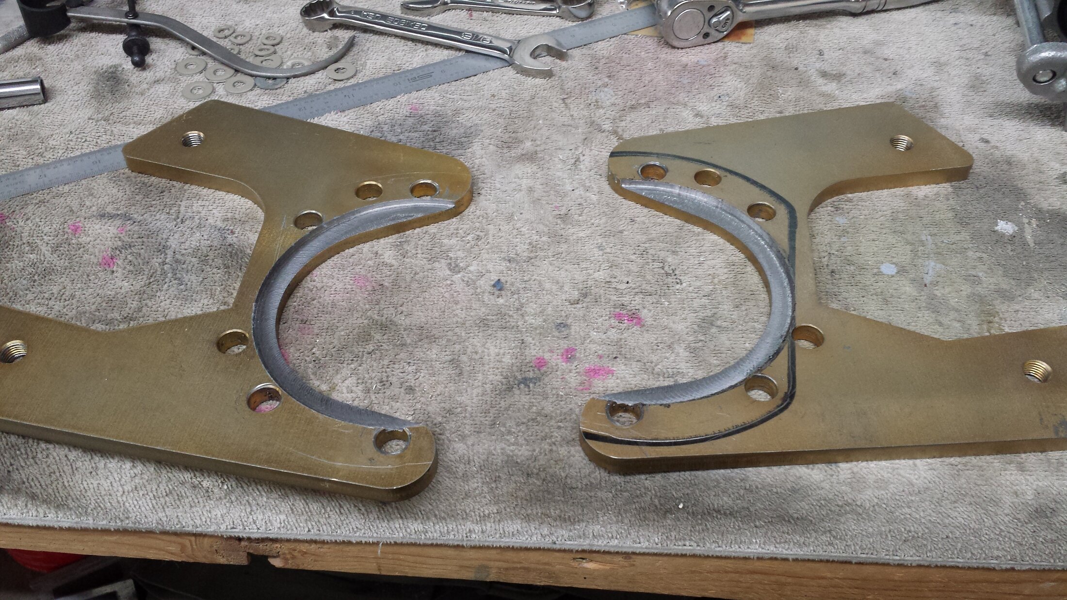

The taller hat would have been great for the rear. The fronts were perfect. I ended up machining the rear caliper plates and using a thinner pad. I went with Willwood 150-8936K-BP10 pads for the Single piston GM metric calipers….they are exactly 1/2”thick. If you go to Auto-Bone, they are like 9/16” or wider.
Picture of rear brake caliper mounting after machining. As you can see, a taller hat would have made a great difference.
The rabbit fit goes around the rear axle flange.
