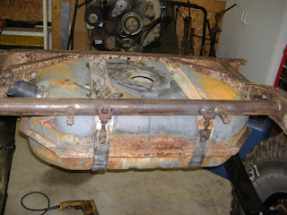

I was doing some digging on this topic recently and found an interesting thread about using a Chevy S-10 gas tank. Not sure if this is something you'd consider but it's worth a look:

Yeah, I've seen that but it wouldn't be my first choice. I really like the Downey/Con-Ferr tanks. That said, it may come to this or something like this if I can't find something better.

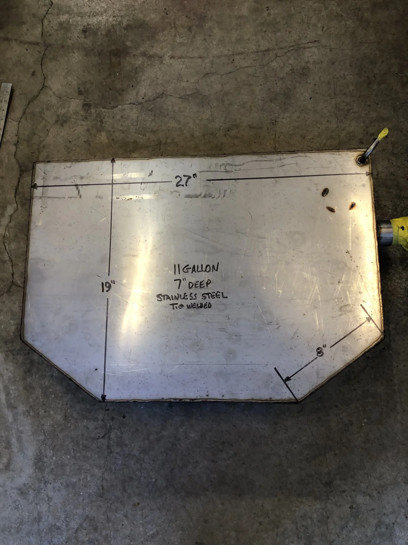

Here is an option, for sale from well known member/seller @pardion . 11 gallons isn't likely enough for it to be used as primary tank, but would be a great aux tank size and stay tucked up nice & tight.
