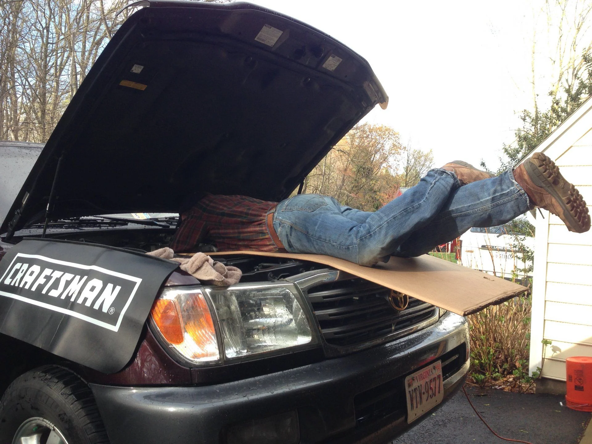

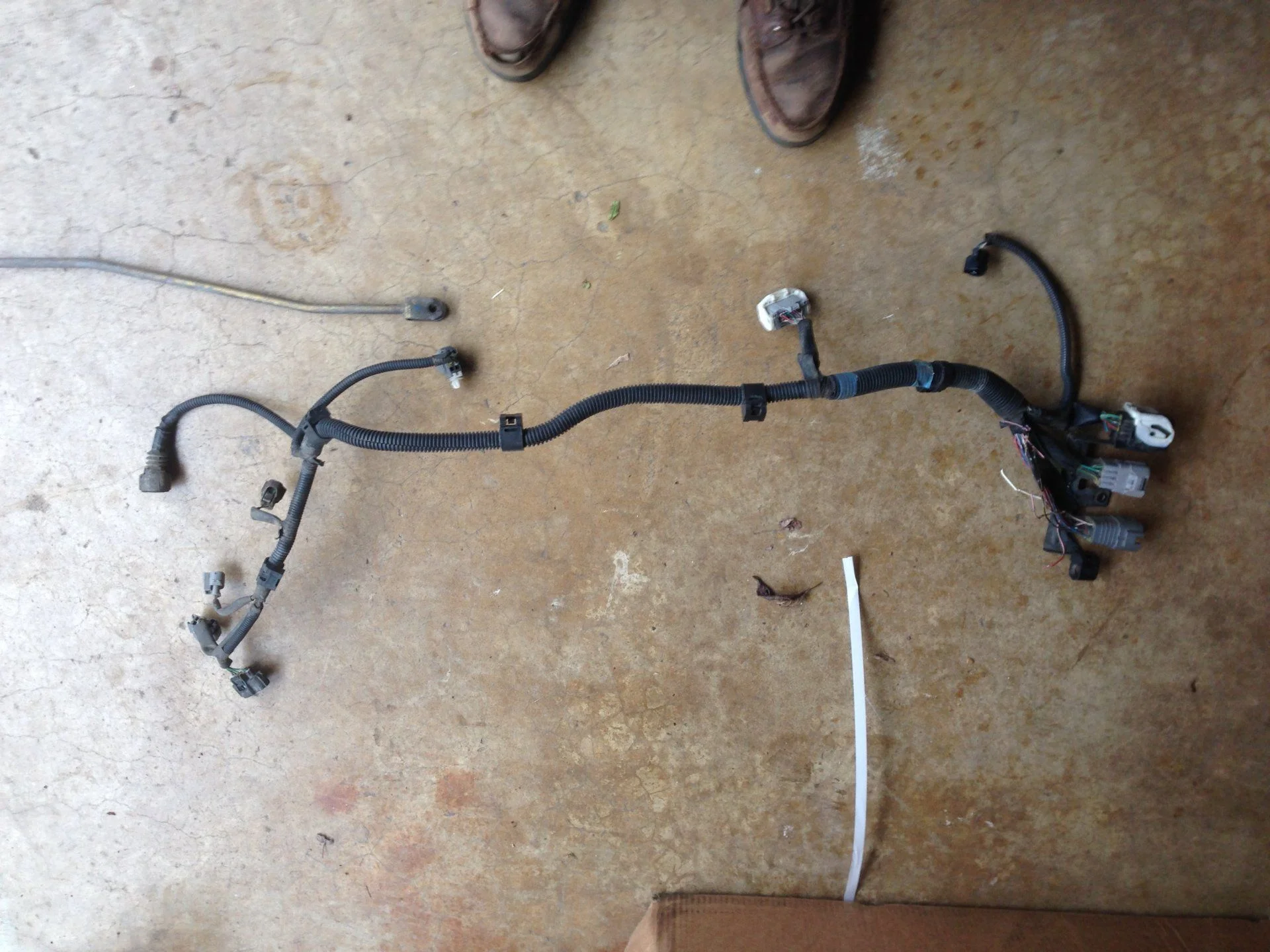

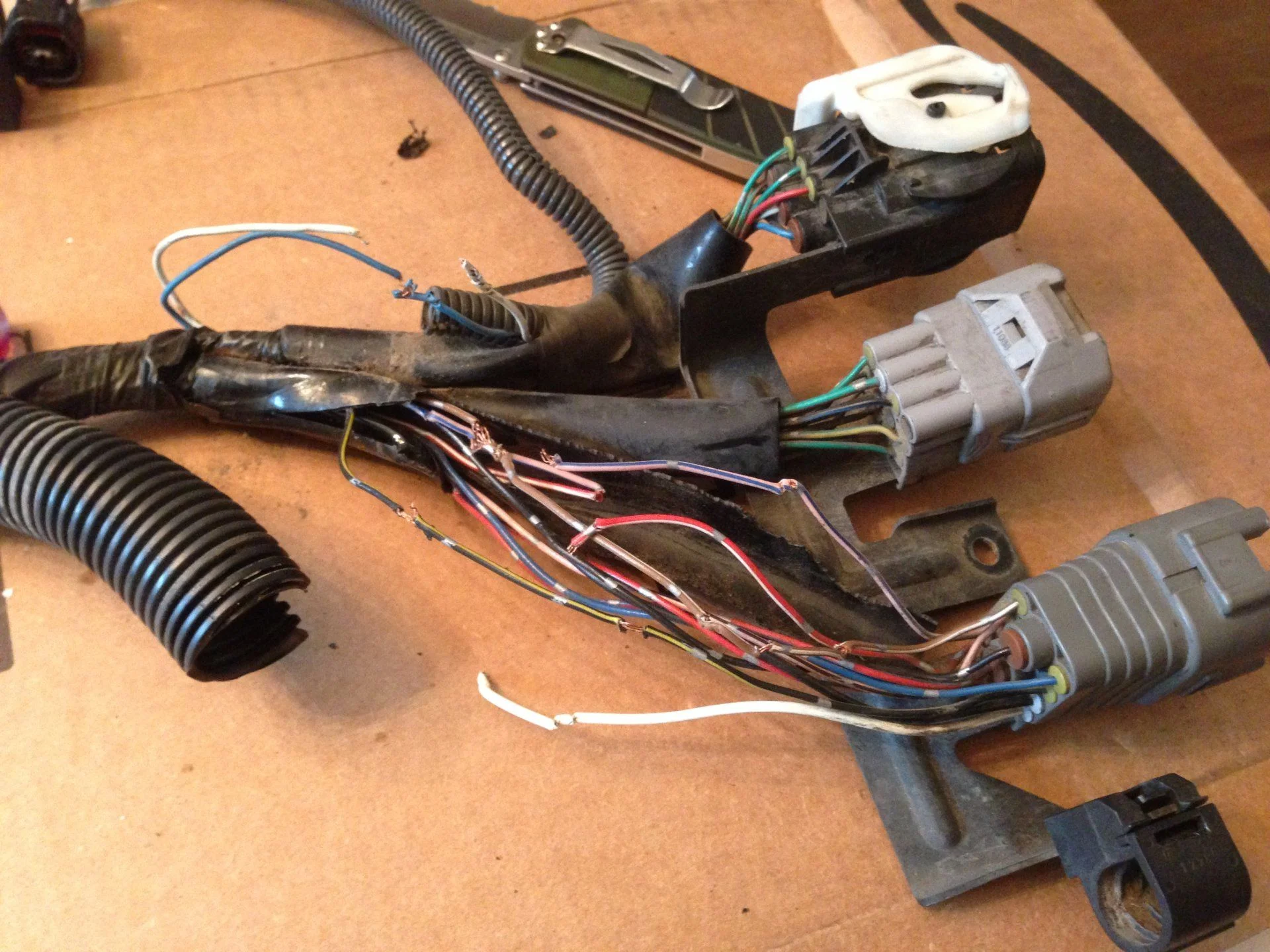

This was my problem guys... squirrels got into my wiring harness on the back of the engine/top of the transmission.
Tough to get to the connectors and you need both hands; this was my solution...
Transmission harness removed - has 11 connectors on it!
