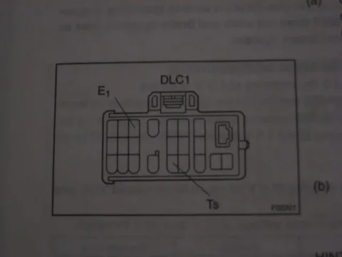

Okay, you have to jump E1 and TS on the DLC1 connector which is under the hood right by the passenger side. IMG_1316.webp
Once you jump the two terminals, turn the ignition key to second position but do not start the engine. You will notice that your dash lights are going crazy. Concentrate on the VSC light. Count how many times it blinks before it stops for about a second and starts to blink again. For instance, if it blinks twice then stops and blinks once, that is a code twenty one. If you get code 36 and 39 then you have to reset the yaw rate and deceleration sensor. Heres how to do it.
