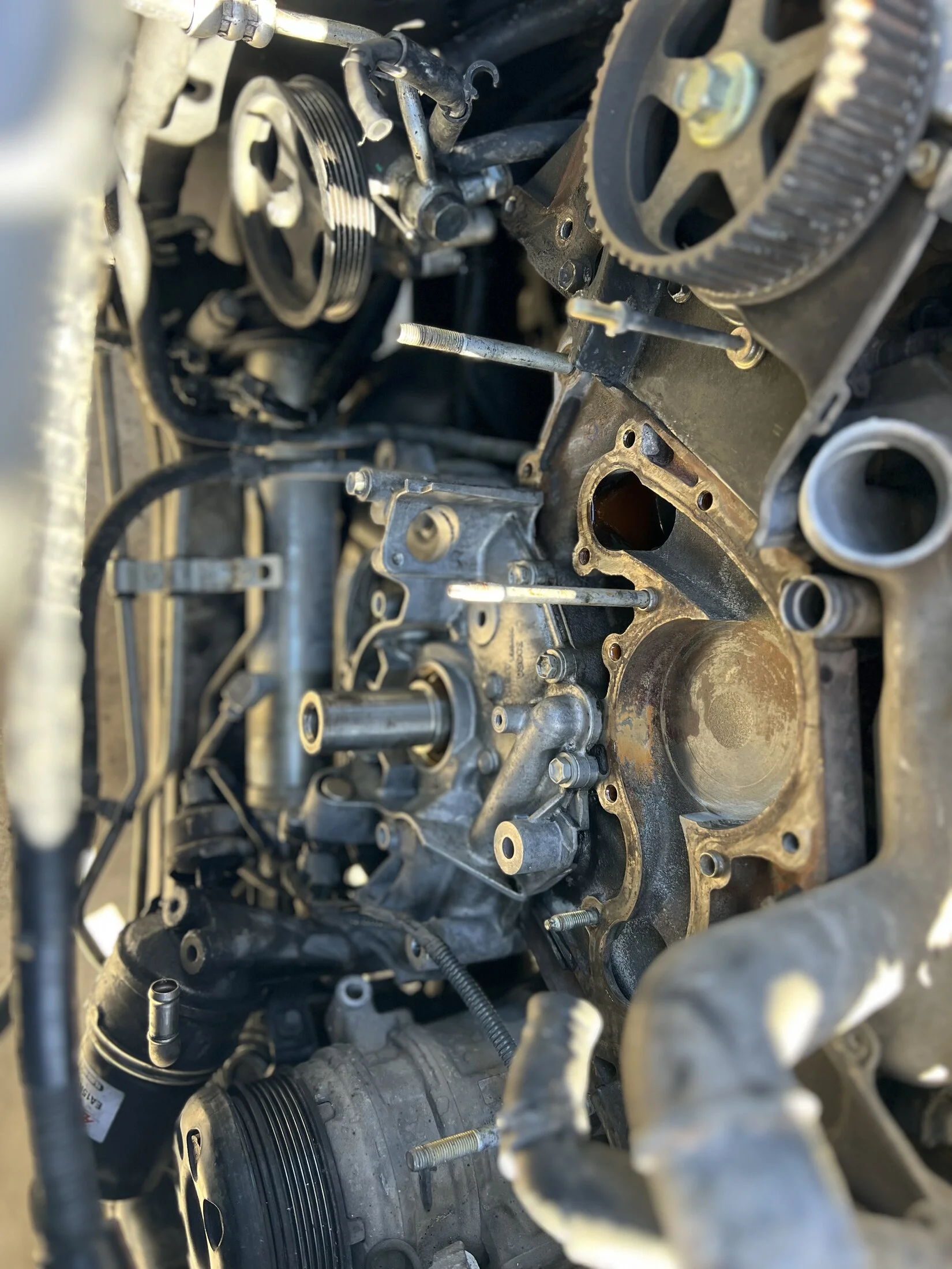

I just rebuilt a 2uz and installed. After install, I had to remove the crank pulley and fix a front main seal leak I had, which is on the front of the oil pump. I was able to do this by removing the top timing covers, loosening the timing belt, removing the tensioner, crank pulley and lower timing cover. That gave me access to the majority of the oil pump. If I had to remove the entire oil pump, then I think it could be done by just removing the rest of the timing covers, idler pulley, tensioner pulley, alternator, and power steering pump. Then pull the oil pump, clean off the fipg off the top of oil pan #1 and front of engine, then install. Don't think you'll need to drop the diff or mess with the water pump or coolant hoses.

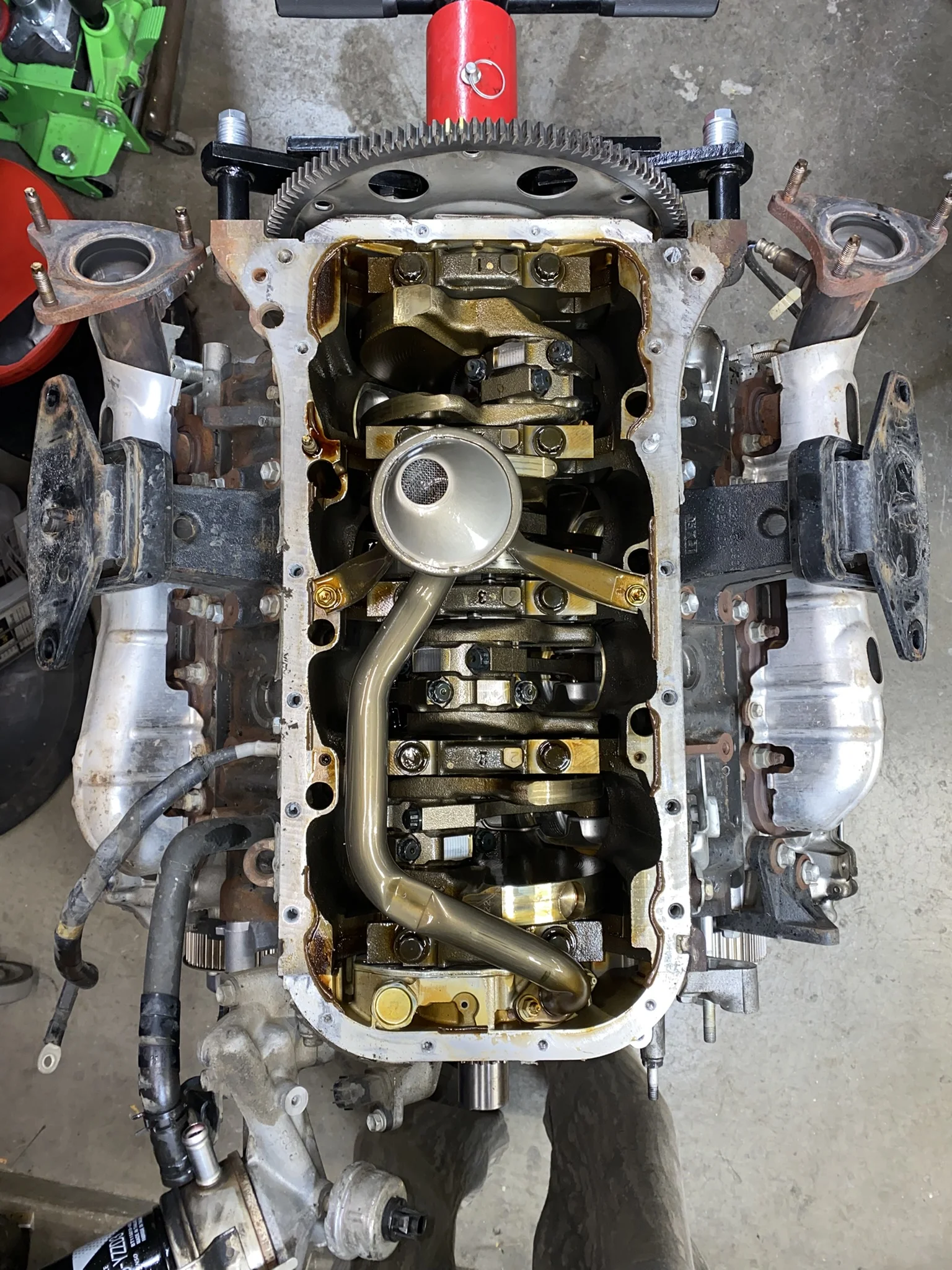

I’m talking actually replacing the whole oil pump in RM it’s states removing both oil pans and removing oil pick up strainer to actually remove the oil pump behind the crankshaft seal I don’t want to pull the engine so I’m asking if anyone has removed the oil pump while the engine is still in the car.

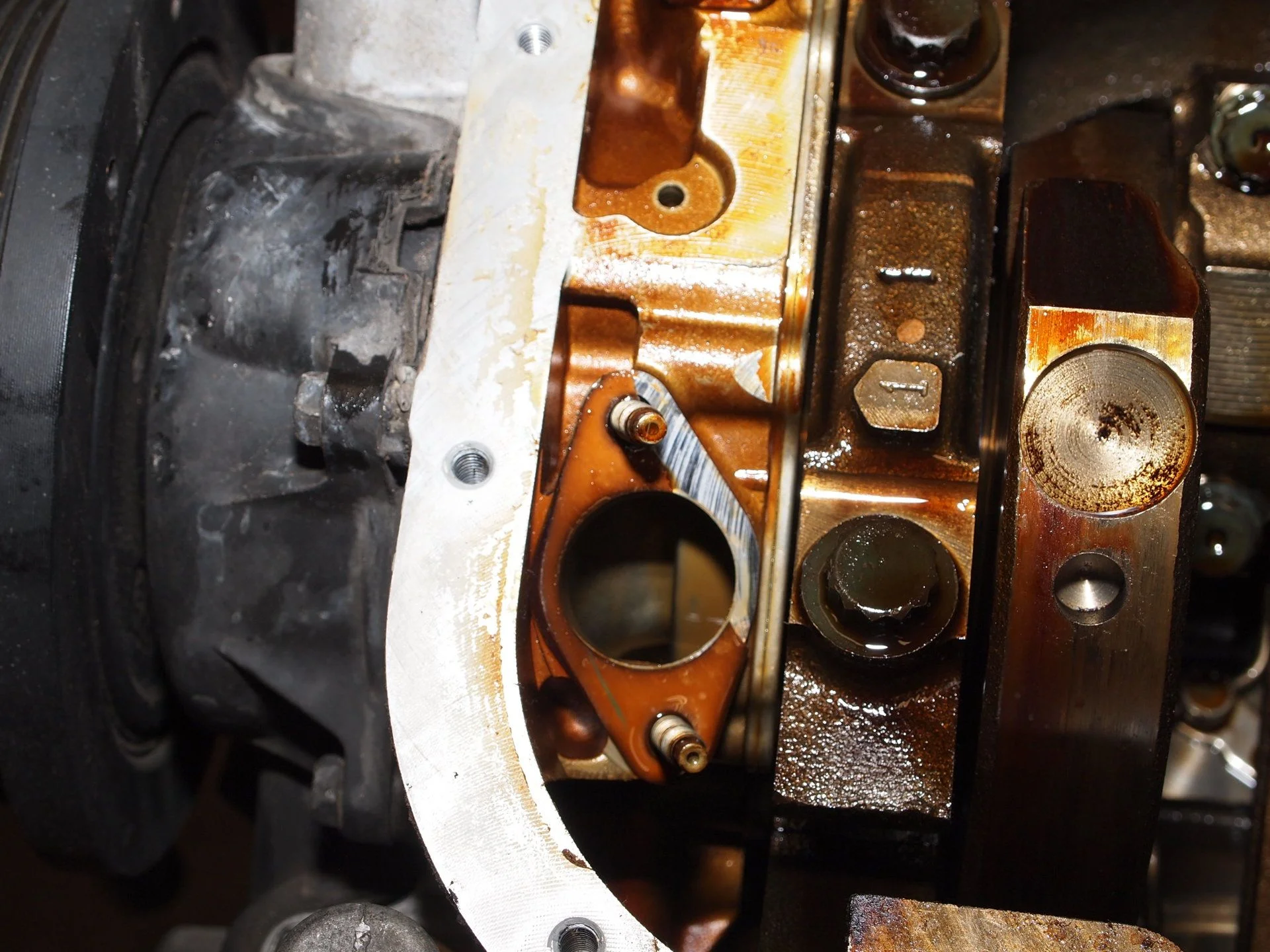

Oh thats right. Forgot the oil pick up bolts to the bottom of the pump with two nuts. I'm not sure if you would have the right angle on the pick-up nuts without removing the pans, but you might because there is quite a bit of space once the pump is removed. I would try it first without removing the pans, if you don't have enough access on the pick up nuts, then remove the pans.
Actually, if the pans have never been removed, then I would probably remove them just to refresh the fipg gaskets. (fipg 103)
That’s what I’m thinking Moore80 it will be a decent amount of work after looking at it debating on replacing oil pick up while I’m in there no point not too I just don’t wanna get into it and realize that it won’t work so I’ll do some research.

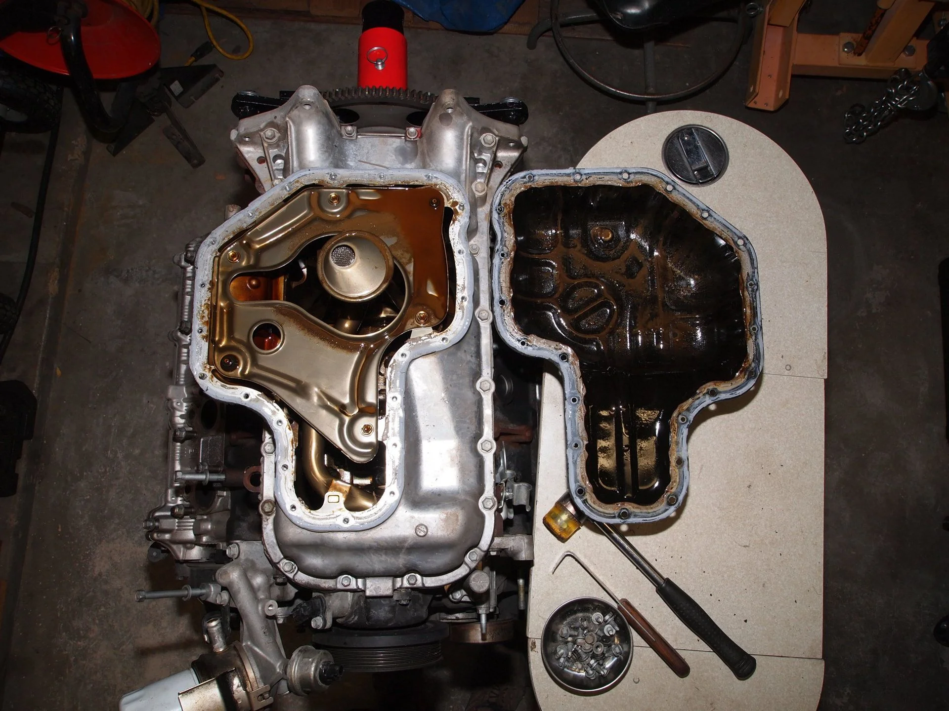

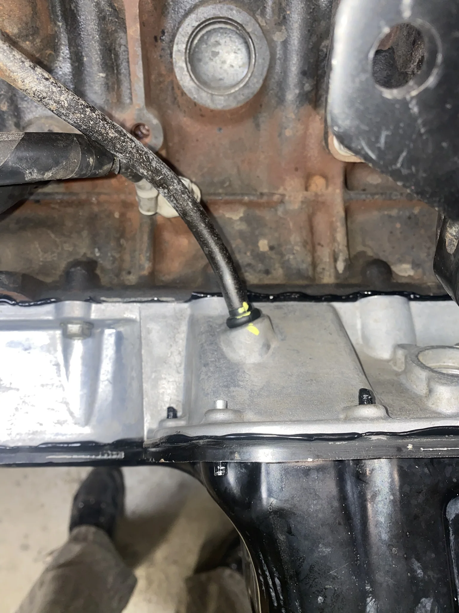

I have my original engine sitting on a stand at home... I'll look at it when a I get home and see if I can take some pics with the pump off and pans on to see if it's possible to access the pick up tube nuts. I'll send you some pics if I get a chance tonight.

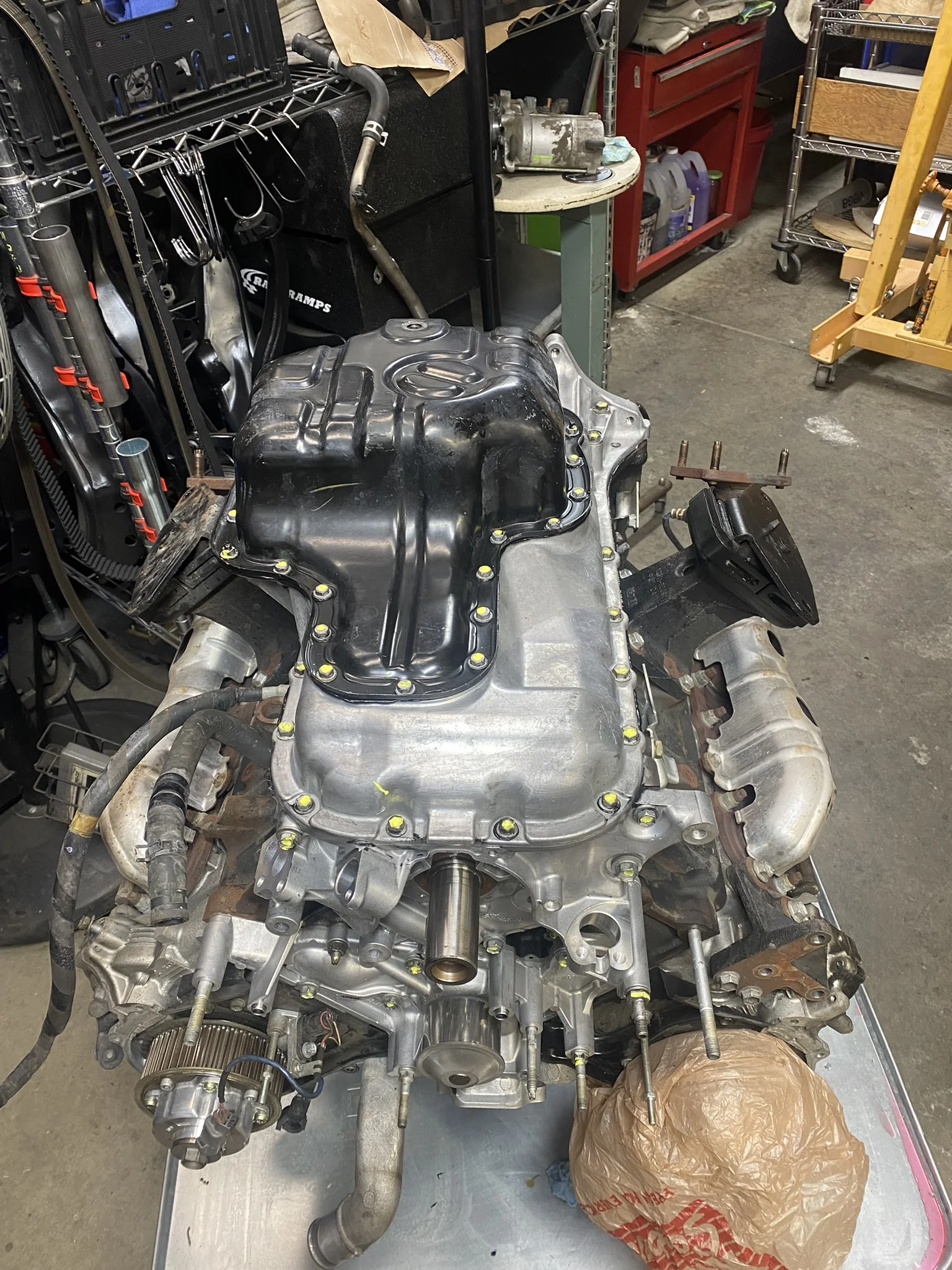

You can not remove without dropping both pans. One guy in mud (bust a bolt) so pulled pans while engine in (or so was my understanding). But it would be tough. Sometimes short cuts take longer.

It’s leaking out from behind the oil pump and not the front crank seal so I have to remove in order to seal it back up looked on ‘tis and says to remove engine don’t want to do that trying to figure out an easier way than taking out diff

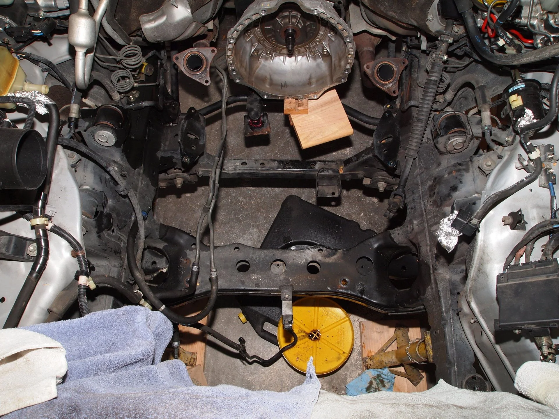

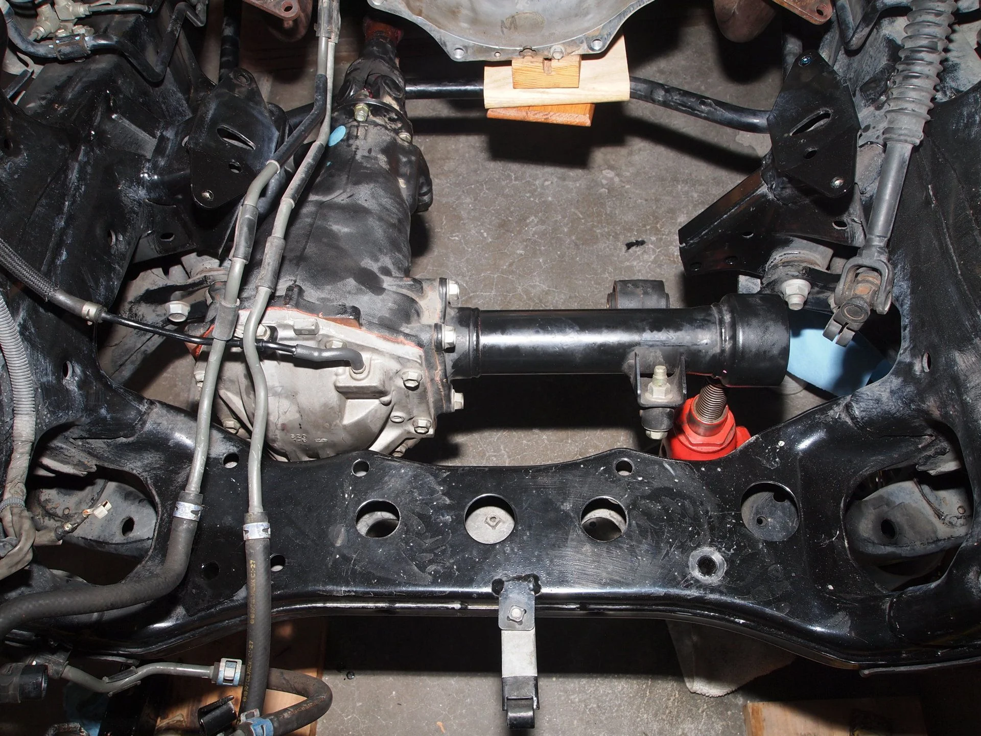

You'd sure have more room to work if you pull front drive shafts, diff, #3 cross member. Look around mud to see if you can find they guy that did this without pulling engine. He may have some insight.
I know he pretty much had everything out I’m not trying to pull drive shaft since I just replaced them and converted my truck to Part Time I’m gonna look closer and see if I can just take out cross member but we will see
You can just take out #3. These may give you a sense of room you'll have.

Getting the pan seal cut, is a bear. Pulling the front diff and drive shafts does open it up nicely. The added room would really be nice here!

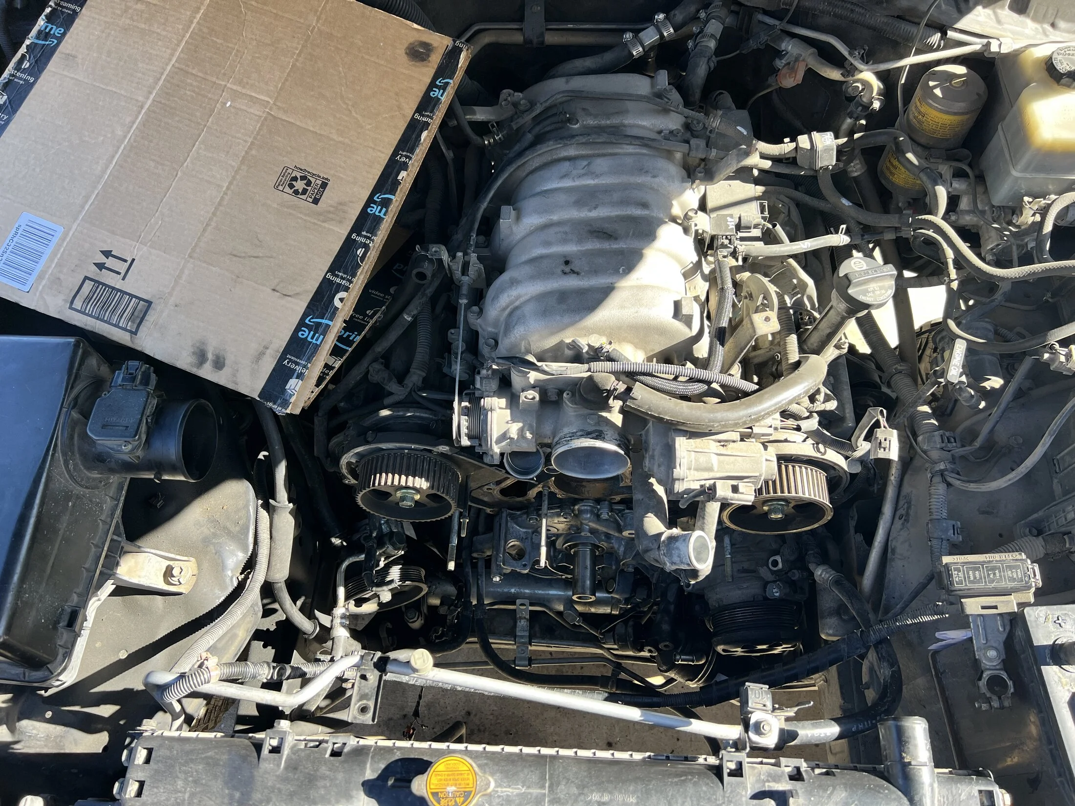

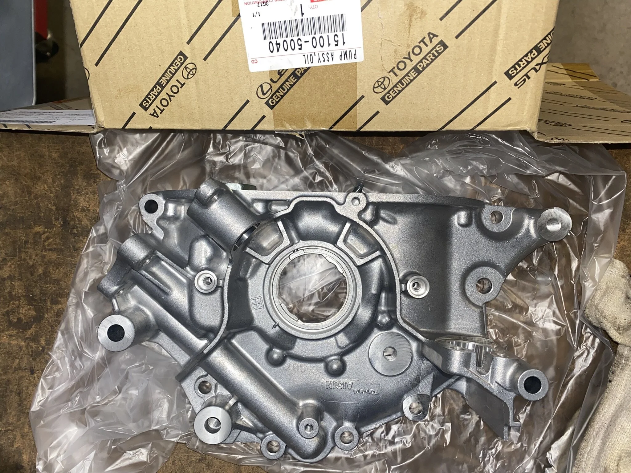

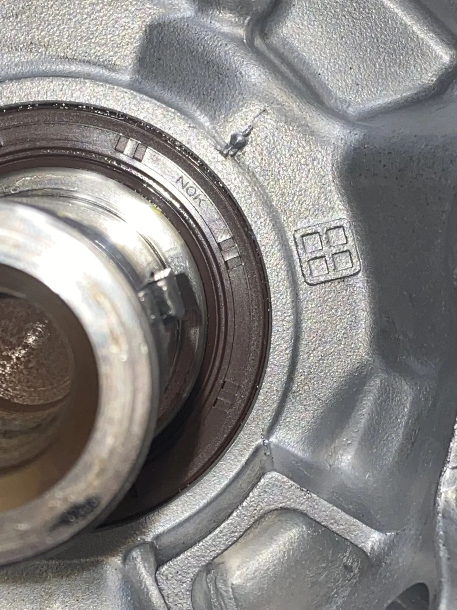

Realize this is an old post from about five years ago, but wanted to add for anyone who finds this and has the same issue. Yes - You can get to and replace the oil pump as part of timing belt change. As part of timing belt change, you have to remove the fan the fan shroud, the fan clutch bracket, the water pump, all timing covers, Which leaves plenty of room and access to the oil pump with the engine and the vehicle. Follow the instructions for timing belt replacement along with crankshaft oil seal, combined with the instructions for replacing the oil pump from the FSM.

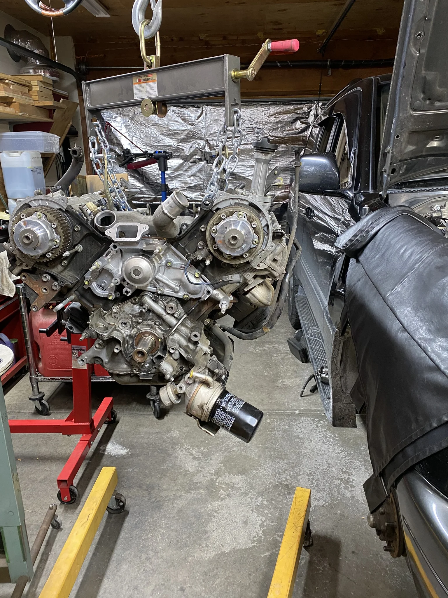

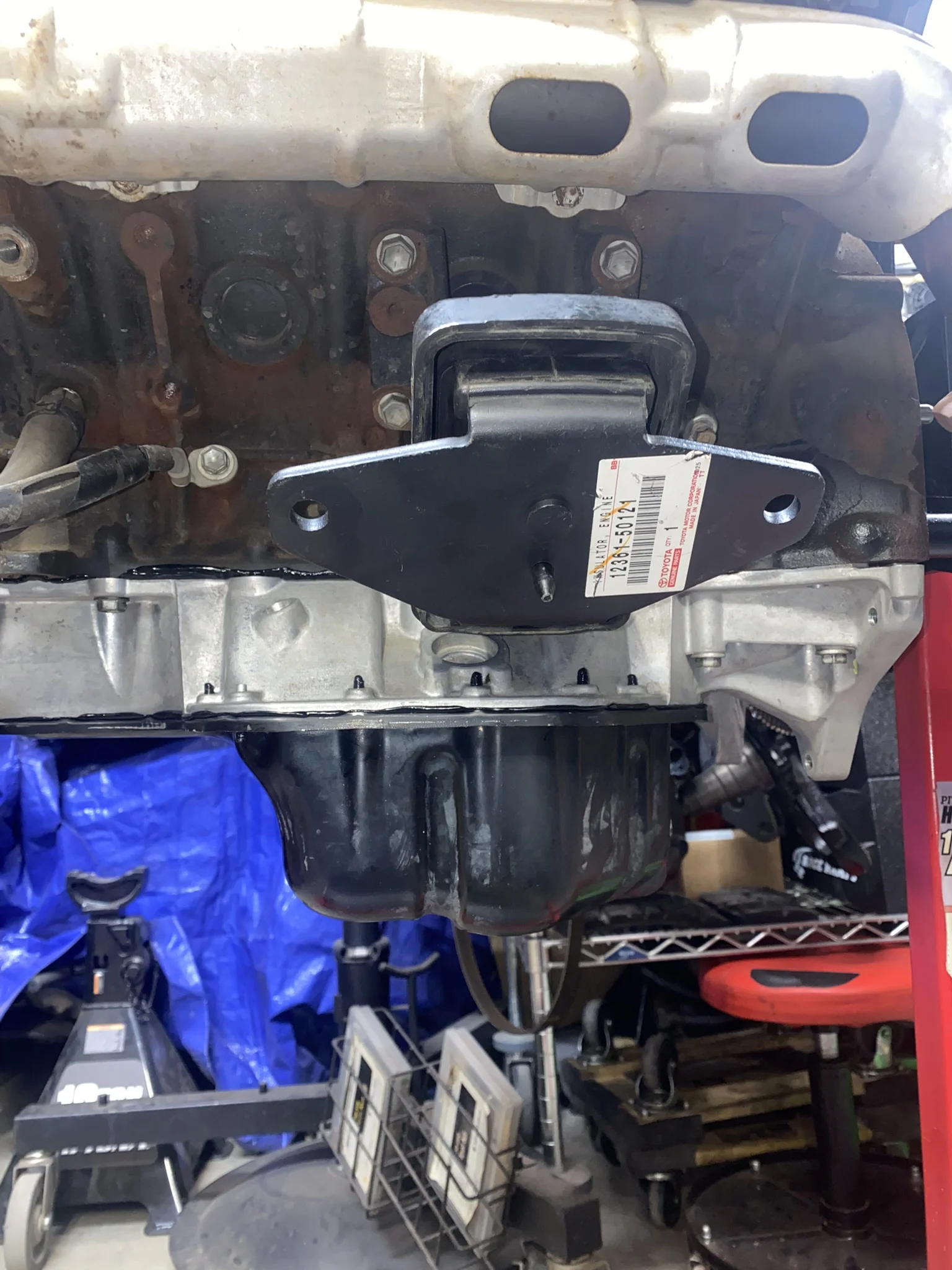

Following FSM to R&R oil pump. Requires pulling engine, place on engine stand, roll over and remove pans. PITA job.
Just finished one today, required due to cross thread tensioner bolt.
