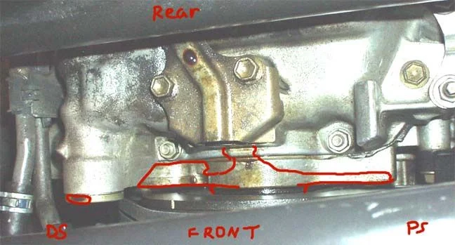

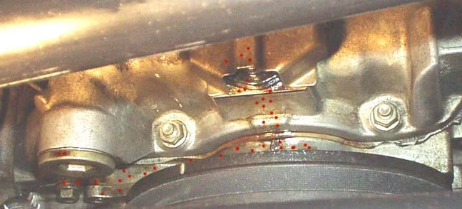

update - pictures
OKay, here's some photos.
Top photo shows the crank pulley and surrounding area. Areas outlined in red are wet with oil.
Second photo shows another view of same area - dotted areas are wet.
The crankshaft (behind the pulley) is wet - but it was wet before and I can't get a rag behind the pulley to dry it - so don't know if this is new oil.
The area of the timing chain cover to the right (passenger side) of the crank is relatively dry. However, the pumpkin and passenger side of the axle are spotted with oil. Which way does the crank pulley spin?
The front area of the oil pump cover that is not covered by the crank pulley is dry, but as you can see the area below the pulley is wet. Is this leaking from above, or perhaps being flung up there from the pulley?
Thats what mine looked like when my front seal leaked.
I had an oil leak at the arch on the pan where you see the oil on yours.
I went from dino oil to RotellaT syn and that leak stopped.
