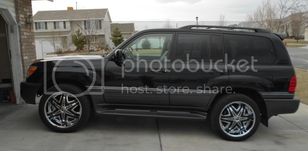

This is the current look of my LX
Some good advise>>>>>> dont show a pic of those rims again on this site
Not sure how serious above is, but I believe one can't argue with matters of taste. If that floats the owners boat then more power to them.
I know 90% of the crowd here likes to rock nearly identical OEM wheels (myself included.)
Now, if the poster is looking for input as how well those rims will serve for off-roading, then we can get beyond taste and debate the merits of metal on rock vs. rubber on rock :-)
I say keep the pics comin :cheers:

I take pride in what I drive and how the car looks. As I previously stated, the after market 22" wheels are solely for city driving and I love the looks of it on my Lexus. Mind you, Diablo Elite are Brand Name wheels if I may add.
Now I am in the process of acquiring a second set strictly for snow and off-road terrain. That’s all.
