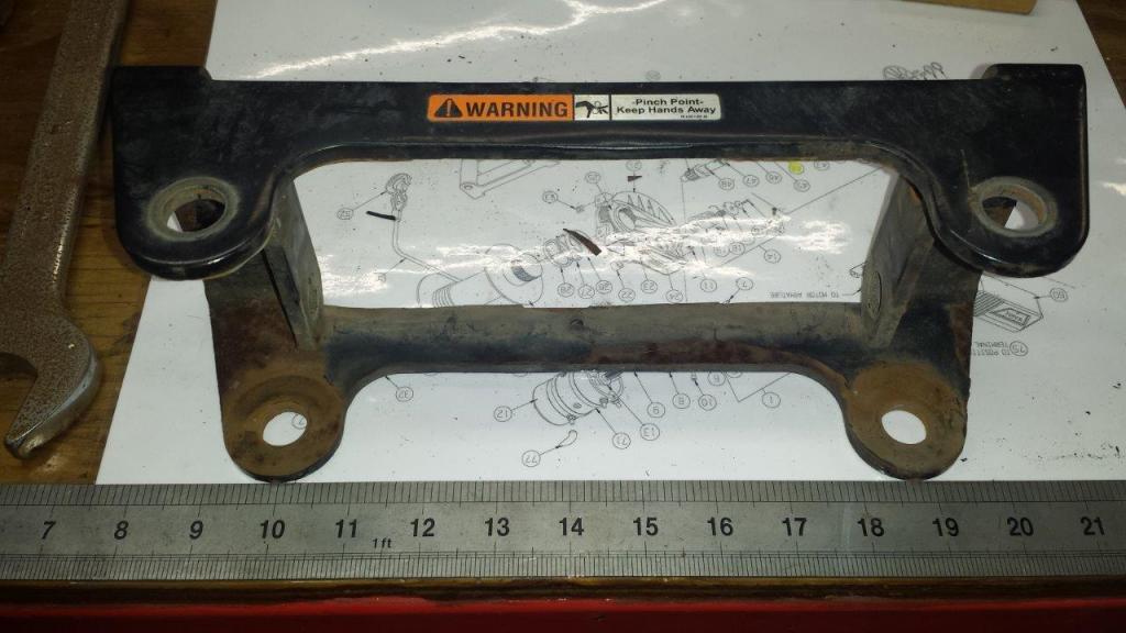

The original WARN winch and fairlead:-
* fairlead had an opening between the rollers of 7 1/8" = 181mm
* WARN 8274 drum is 8 1/2" wide between the flanges = 216mm
* ∴ fairlead opening is 35mm narrower than the drum.
I understand the need for the fairlead to to be a little narrower than the drum to avoid side loading, but after looking around for a few hours on google I couldn't find any definite reasoning for having it so much narrower than the drum.
Does anyone know why this difference is so great? Is this just a generic compromise to allow for a wide range of winches to fit the same fairlead?
I've heard a few stories of people having troubles to re-load the rope across the full width of the drum with a considerably narrower fairlead opening.
Unless I have missed a fundamental principle of engineering, I would say that the ideal opening need only be about one (1) rope thickness narrower than the drum. This will ensure that there shall be no side loading, and also ensure that the rope can be re-loaded across the full width of the drum, especially when applying the recommended load - 5% of rated rope capacity - when reloading.

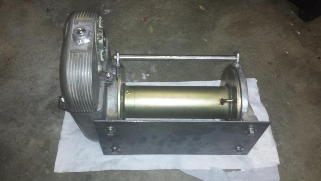

So, with the widened Gigglepin I calculated how far I thought the roller fairlead needed to be widened:-
* GIGGLEPIN widened drum is 11 1/2" wide
* The fairlead opening should (I think) be 1/2" smaller than the measured drum width between the flanges
* drum width of 11 1/2" - 1/2" = 11" = 280mm
* 280 - 181 = 99mm
* ∴ fairlead shall be widened by ≈100mm to achieve the 1/2" difference
Since I am lucky enough to work in a fab shop, I am machining up new pins from SAF 2507 and new rollers from INCONEL for improved strength given the longer span of the horizontal rollers.

Gigglepin replied this evening and it's pasted here:-
Thank you for your mail and apologies for the delay in replying.
The reason fairleads are actually smaller then the drum itself is to protect the winch. When winching, the cable can stack into the side of the drum and then pull down into itself creating huge loads on the drum plates. These plates then flex against the housing and either break the housing or in extreme cases cause the gears to point load and break as they are now out of alignment.
Gigglepin defeat these problems in two ways. Firstly you will notice the drum end plates do not hug your winch casings. This is to allow some flex in the plate if stacking occurs. We also upgrade the drum plates from 4mm to 8mm to again reduce the risk of this happening.
Steel cable is less likely to cause this problem compared to its synthetic counterpart as it is less likely to deform under winching. Unless slack cable is allowed on to the drum, this can then cause exactly the same problem.
The drum you have measures 282mm between the plates. Our Gigglepin fairleads measure 230mm in the throat.
I would strongly recommend not making your fairlead throat any larger than this due the reasons already given.
I hope that helps and if you have any further questions please do not hesitate to ask.
Makes sense to me, so I'll build it as recommended.
