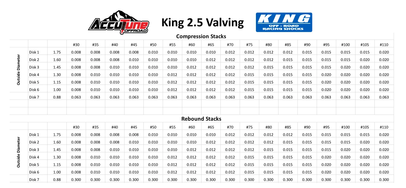

For anyone interested... spoke with KING and this was standard valving without compression adjusters for the 2.5's
Fronts
Comp .012 .012 .008 flutter .015 x5
Rebound .012 x6
Rear
Comp .010 .010 .008 flutter .015 x4
Rebound .012 x6
Fronts
Rebound .012 x6
Rear
Rebound .012 x6

Revisiting this as I’ve started to get around to it…Accutune sells stacks, looks like the KING OTS stack I quoted earlier for the fronts are 80# compression, so I definitely plan on dropping that down, the rear is just as high with a slightly softer entry
It’s hot af down here right now and no hvac in the garage currently setup, so I’m in no rush…Just thought I’d update as I hadn’t noticed Accutune sold custom stacks, everywhere else I saw you needed to purchase full stacks at each thickness and then combine from there.
Scratch that last comment….Accutune DOES NOT sell custom shim stacks, I grossly misread their sites information and they only sell shims like everyone else, you buy a stack of 6 (or a multiple sets) in every size you plan to use…looks like there isn’t anyone who I’ve personally found with actual experience tuning KINGS for an LC200.

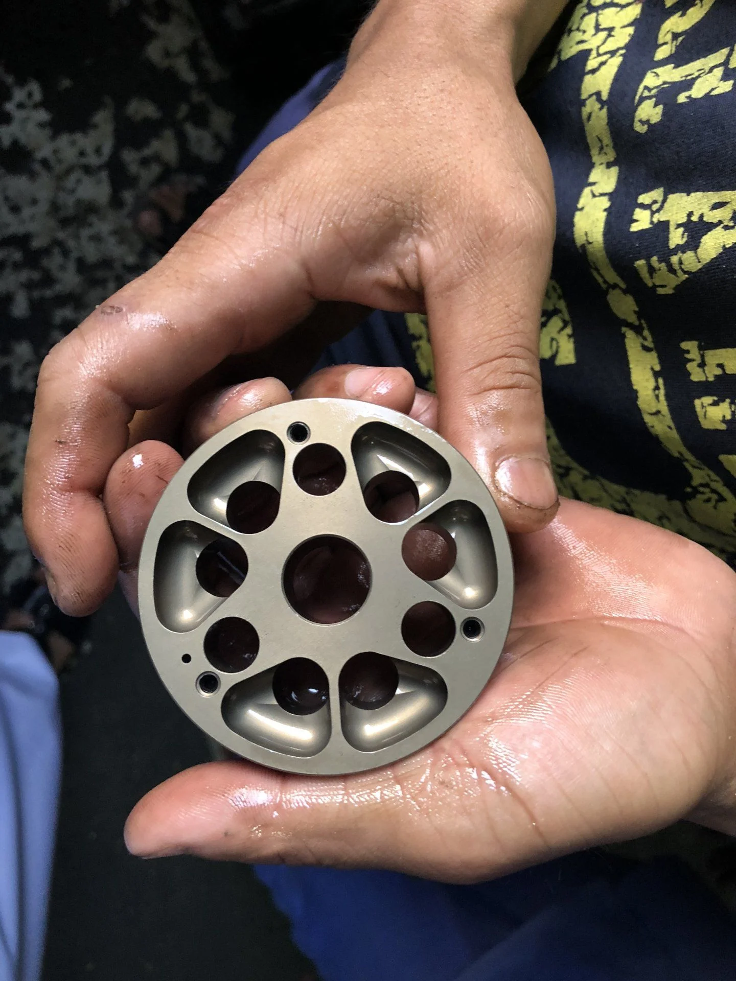

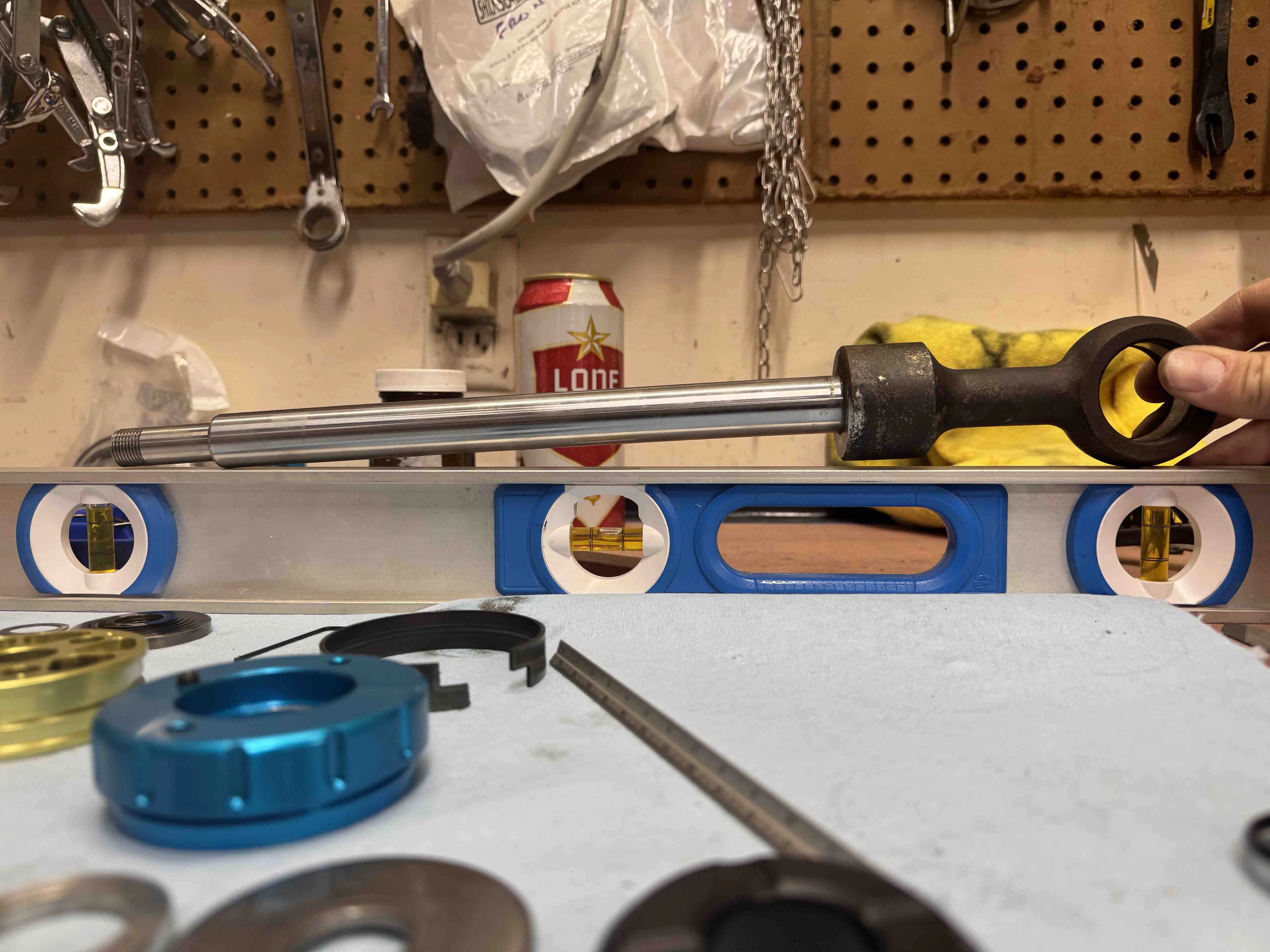

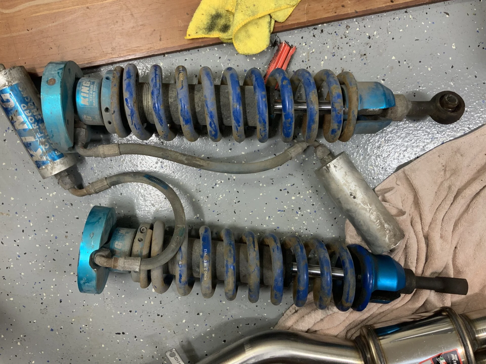

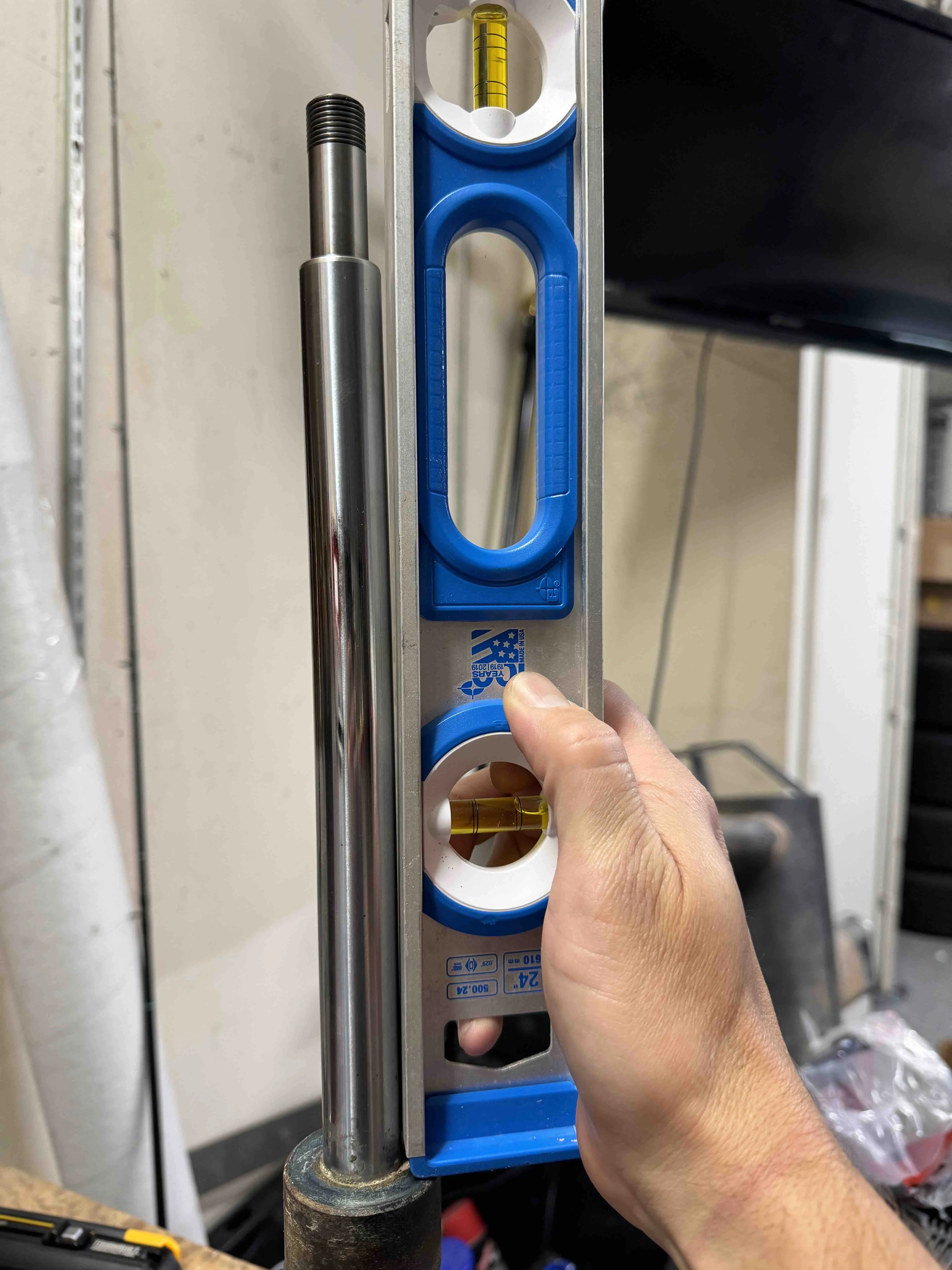

finally got around to breaking these down... both front shafts bent, likely due to the little hard "stops" that were epoxied on to limit droop. Nice.

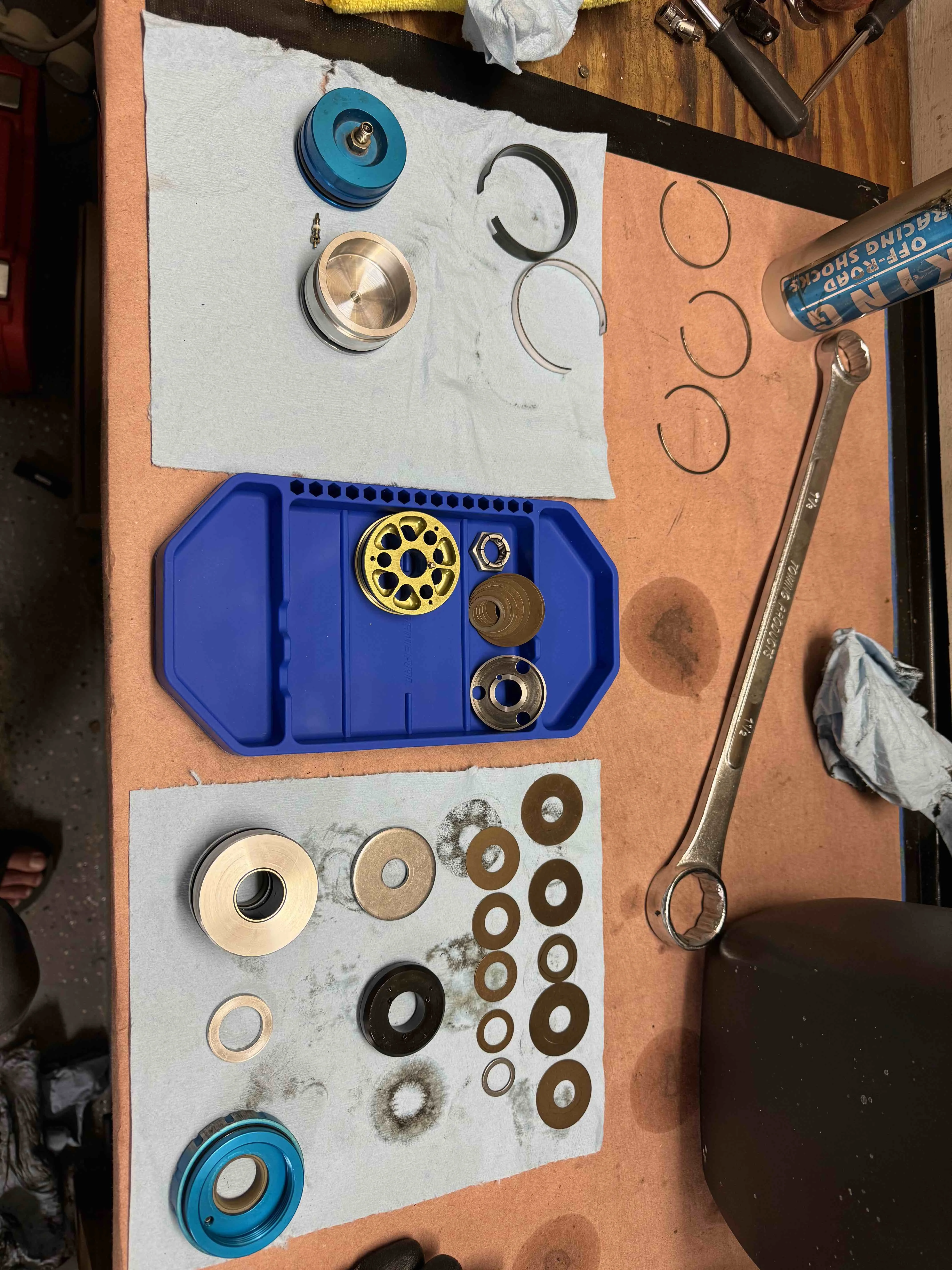

Valve stacks - looks to be just a slightly adjusted KING standard valving,
Compression; 12,12, 08 flutter, 15,15,15,15,15,15, 60
Rebound; 12,12,12,12,12,12, 20
