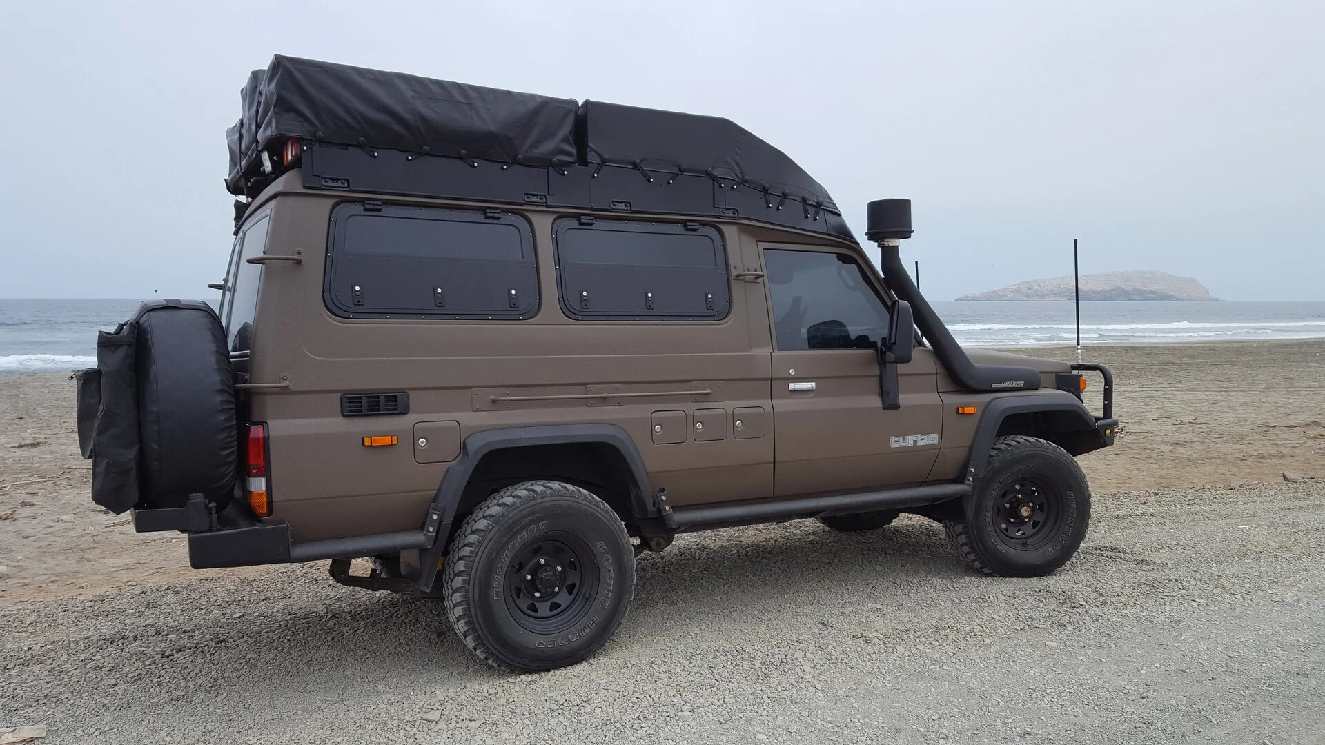

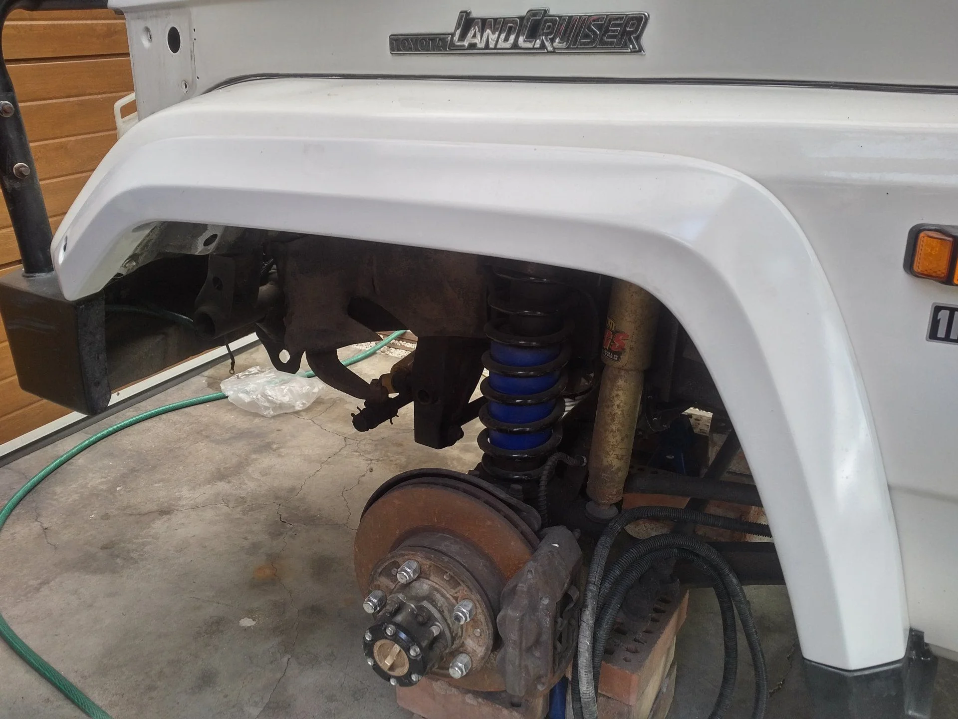

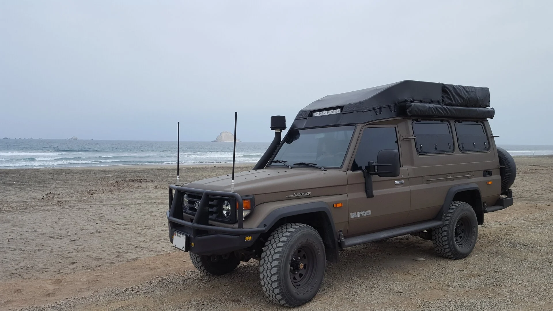

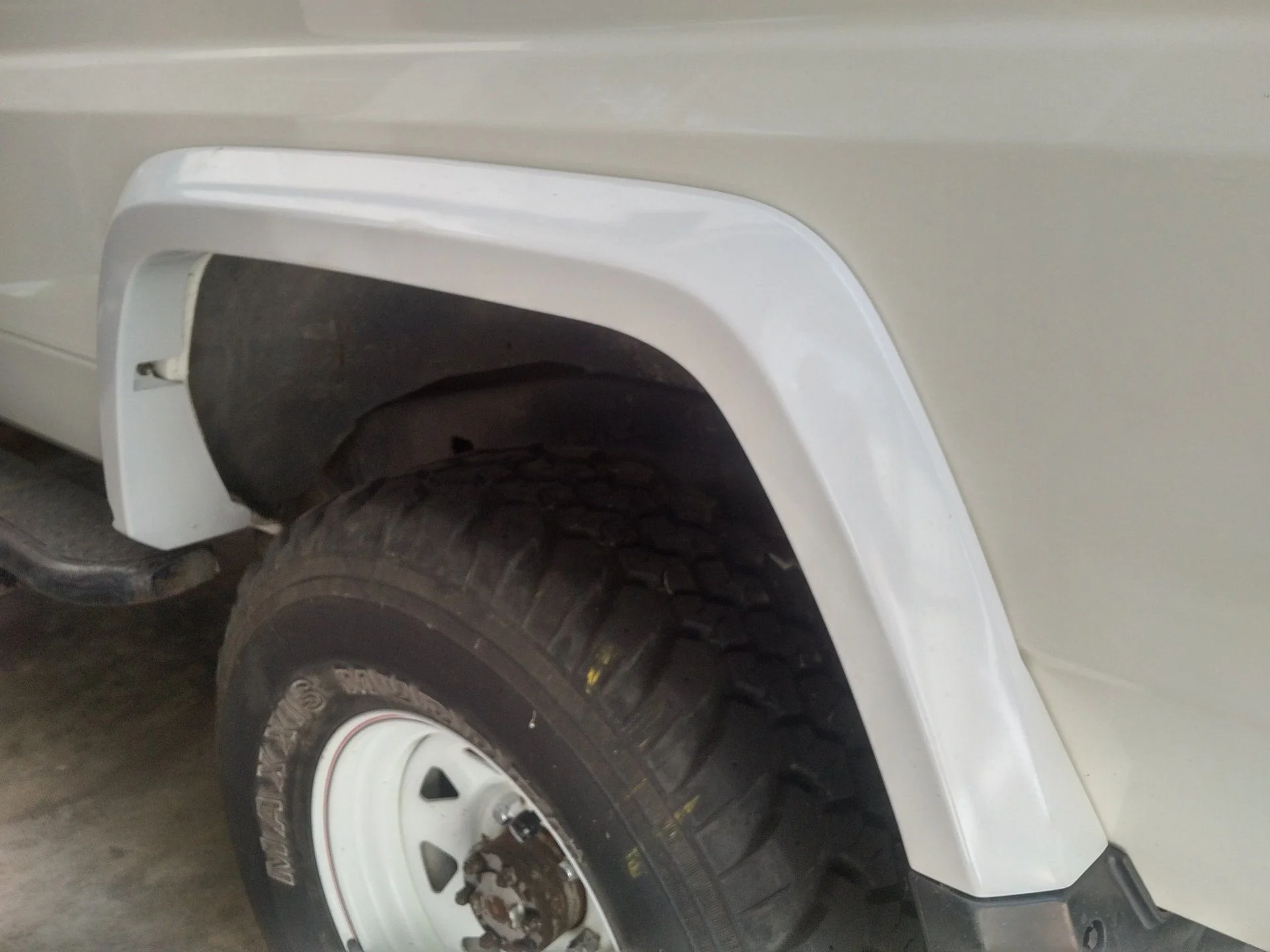

In a nutshell they fitted perfectly, both front and rear, although there was a lot of eye-balling to get them lined up. I also think I fitted the front fenders a little farther back (as far as they would go) to accommodate my 285/75/16s .
The only issue I hadn't realised was that the front mudflaps have a moulded insert to receive the factory side steps. I needed to improve my side steps anyway, so I will be realigning them so they slot into the moulding
