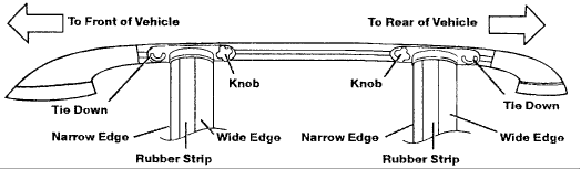

There's a TSB out there that addresses minimizing noise.
Steve
Check to see if the cross bars were installed in the correct orientation.
attachment.php
