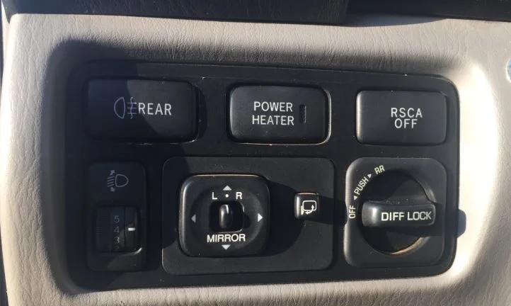

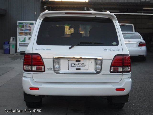

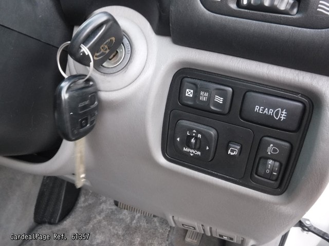

From a European or JDM LC/Cygnus:
So the fog light switch is in that panel...Looks like they can't open the side windows independently though. (headlamp adjustment...drool....)
Looks like the integrate the rear fog lamp into the rear inner back up lamp lenses.
