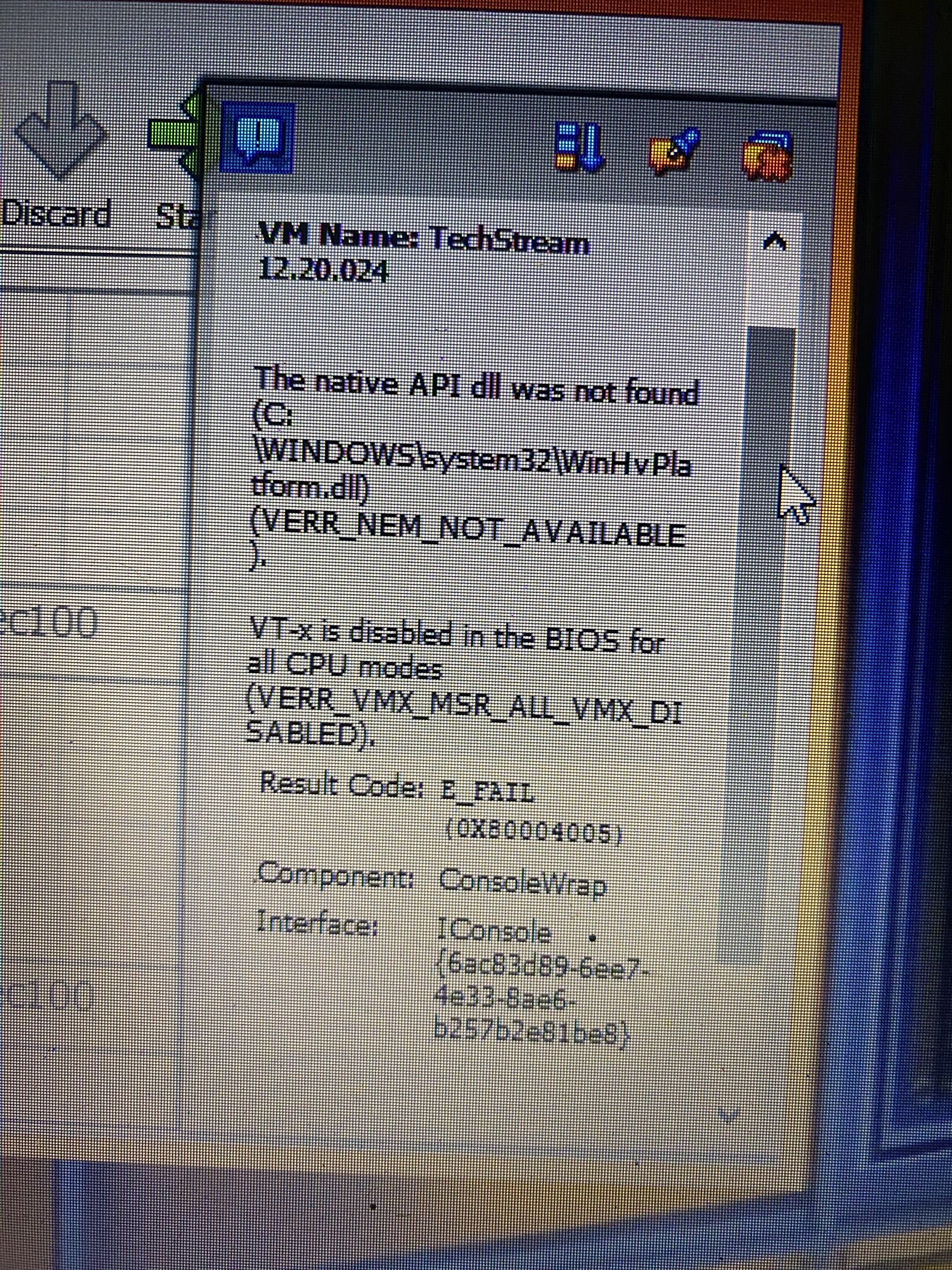

I’m having a headache accessing the software please see attached
Even if I turn firewall off
Any clues peeps?
Thanks guys
Any clues peeps?View attachment 3795568
You probably need to enable virtual box in bios settings, i think im explaining that correctly...
