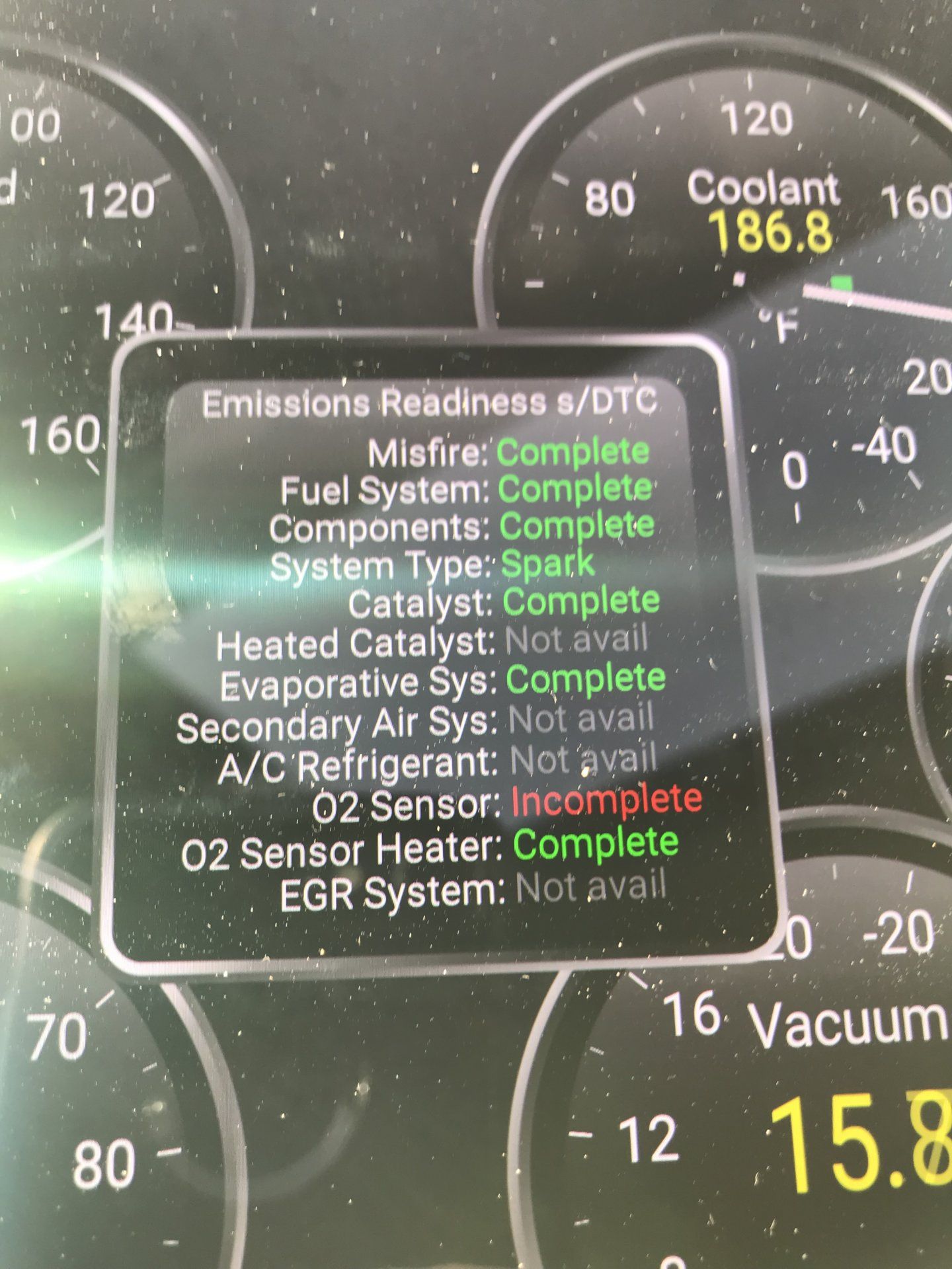

Any thoughts on this?
My 2003 LC with 170,000 miles on it is coming up with the O2 sensor test incomplete in the OBD system. I do not have any codes stored or a check engine light on. All the other tests are showing completed . I have in the past changed the O2 sensors with Denso sensors. Any help would be appreciated!

The criteria to complete a test varies from sensor to sensor. For example rpm has to be at a certain range at certain speed etc. . All you have to do is drive the truck. It will show complete. Sometimes it can take 150 miles with regular driving.
I’m baffled I’ve read the articles and have driven the vehicle in accordance with the suggested patterns. I haven’t had a check engine light on at all nor have I disconnected the battery in at least 6 months. What made it incomplete in the first place? I drive a combination of highway and city driving every day totaling at least 35 miles a day
Temp is 185 degrees which is correct and I’ve used multiple scan tools and am getting the same reading
Did the problem start after you replaced the sensors? Your 2003 model uses a different upstream oxygen sensor from the previous years. Maybe there was a mix-up?

I wanted post an update for anyone who may run into a similar situation going forward. I set up my torque app to read the voltage on each O2 sensor. I discovered that my bank 2 sensor 2 was measuring at .015 and not responding and not throwing a CEL. I replaced the sensor and now the voltage is mirroring measurements of bank 1 sensor 2. So far all is running fine. I'm currently putting mileage on it to complete the monitors, fingers crossed!
