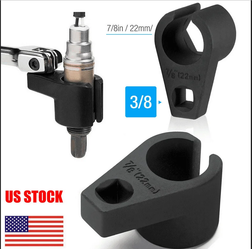

I used an O2 tool which made it easy.

I've struggled with more than a few connectors. The O2 sensor socket is well worth it for the $10 or so!

  • O2 Sensor tool (Harbor Freight sells them - get one like in photo)

Use O2 sensor tool and 3/8" ratchet and remove O2 sensor.

Tighten O2 Sensor using O2 Sensor tool.
