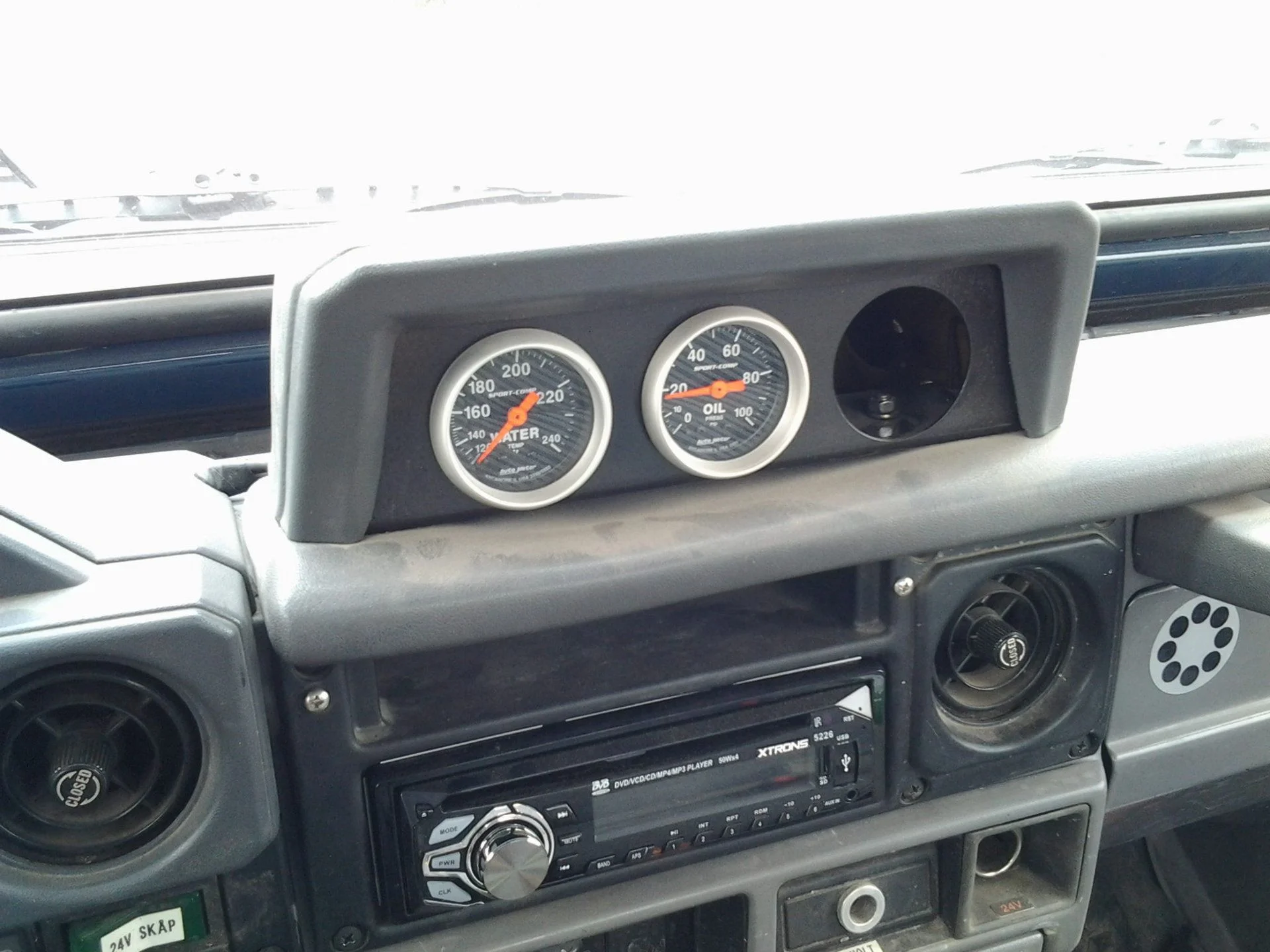

I don't think braided hose will work because of the necessary adapter and couplings: hard to fit into over-dash gauge pod.

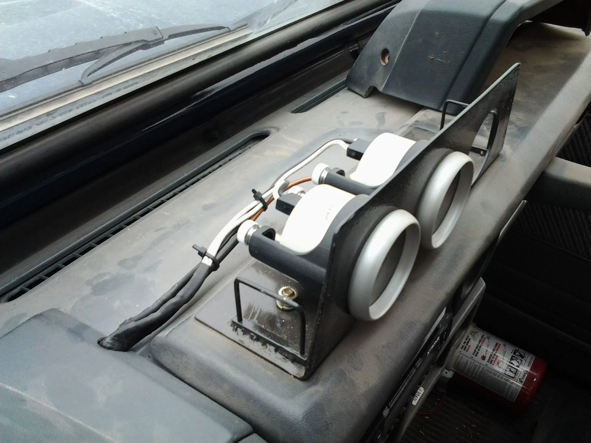

I blew one right at the fitting years ago in a bj70 due to the 3Bs vibration (I assume), luckily it was in a parking lot and I noticed the leak when I backed out. I now use the copper tubing that autometer sells for my mechanical oil pressure gauges.
Running the copper in and around things in the dash not too difficult?

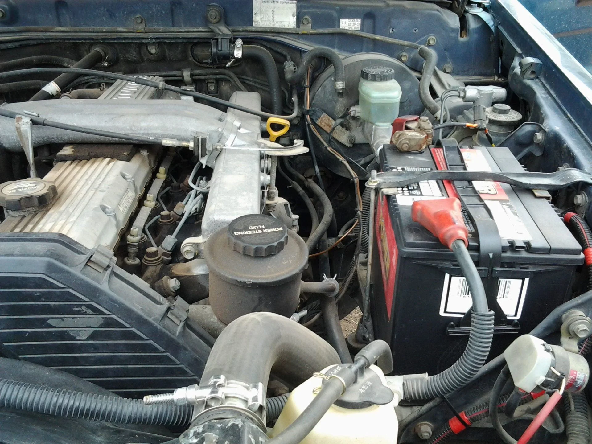

My route is center of dash, go right and over steering, then into the engine bay via firewall grommet far right.
Whatever I use I will probably add braided sleeving from McMaster Carr to counteract rubs.
No sir, not too difficult at all. The braided sleeve is a good idea, I may need to look into that!
