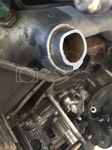

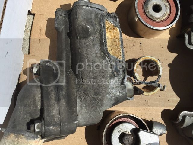

After having the coolant changed to green at one point in its life, it appears it may have been the only time it was ever flushed. The corrosion and build up at all hose connections was nasty and it froze the joint from the thermostat housing to the water pipe it plugs into. Had to mini hacksaw a relief into the broken peice and then was able to pry it out. Found a local replacement from a low mileage Tundra.

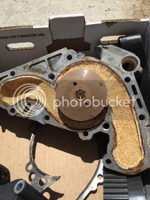

Flush your damn coolant people! I figure this is the original water pump. The nuts and bolts didnt have a single mark or indication they have ever been touched. Either had the crank bolt.

I searched real quick and the belt I removed was one of the worst non-failed belts I saw. Rumor has it, Toyotas requirement to the belt supplier was that it should be able to last double the recommended 90-100k service interval. If thats actually true, 200k was really pushing it. Do NOT, ever, take a timing belt that far. Just look at the pic! It's amazing it didn't snap.
