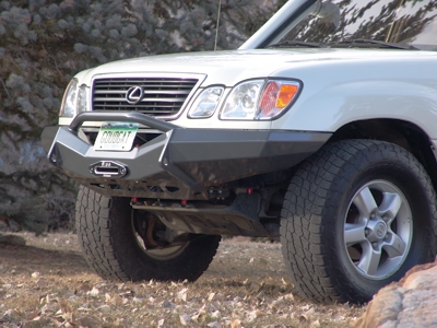

@benc Is making one of the best looking bumpers for a 100 I've seen. He's giving his customers the option to choose between just the bumper, a small stinger, or a full grille/headlight guard. I'd definitely check his stuff out.
BenC I would love to see some pics of how the DIY kit will ship. I'm just curiuos to know how extensive the welding/assembly will be/how assembled the different pieces will be. I guess my question is, will all the pieces be fresh off the water jet/plasma table and nothing welded together (giant pile of random shapes of metal) or will there be certain areas/pieces that come already welded together? I want to be able to set aside the right amount of time to weld it all up.
Nothing will be welded. The center section and wings are all formed in a cnc press brake so there is minimal welding on those. There are alignment slots and tabs on most of the pieces so you can literally weld together without even getting out the tape measure. This isn't like most DIY kits where all joints and bends need to be welded. Any piece that could be bent is bent so there is very minimal welding.
Only the vertical seams will need welded, all horizontal are bent. Also notice the little rectangular slots, there are corresponding tabs the fit into these slots so it's pretty fool proof!
That is fantastic. It looks like the bends on the wings will need to be welded, correct?
