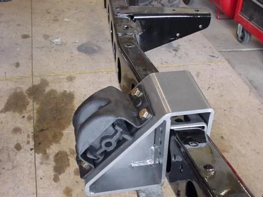

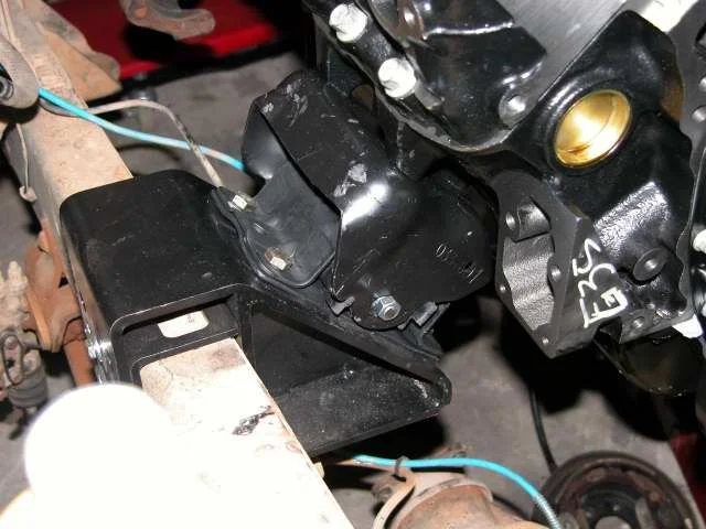

i really liked the over the frame setup. mainly because i could put the motor in and easily keep adjusting it till i got it right where i wanted it.
here are a couple pics
Wow. Those are nice. I don't know that mine would come out as nice. Are those 3/16" plate or 1/4"? I would probly use 3/16 for mine. Plenty strong. Are they height adjustable?
I have a welder and cutting wheel and torch, but no break to bend the metal. I could cut out the pieces and then put them together I guess.
you can shim it up, but i don't think it is made to be adjustable.
