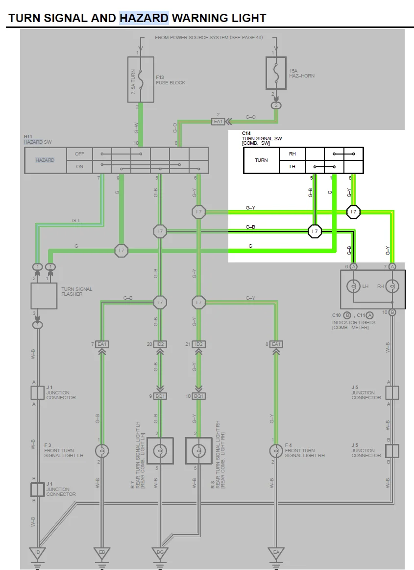

You could be having a problem with your combo switch, which controls turn signals and high beams. I'd think that if your hazards work then the rest of the circuit is pretty much proven. There's info on the part in this thread:
yeah that’s what I was thinking. I haven’t been able to locate any issue in the wiring. Thank you, I’ll check it out
If your hazards work properly then everything greyed out must be working. All that's left is the combo switch.

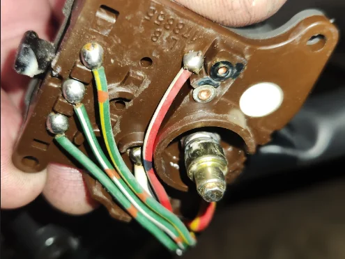

These are the three combo switch wires referenced in the wiring diagram above. I believe G is +12v, G-Y is RH signal, G-B is LH signal. For some reason my 94 has G-W instead of G-B. You should be able to activate your signals by shorting G to one of the other two terminals, as the switch should be doing. W-B is your ground, but if your bights work then you know it's good. R-W and R-Y on the right control the high beams. The lubricated black nub on the left gets flipped up and down by the turn signal stalk.
This is probably more answer than you needed but I recently spent a bunch of time figuring this thing out.
