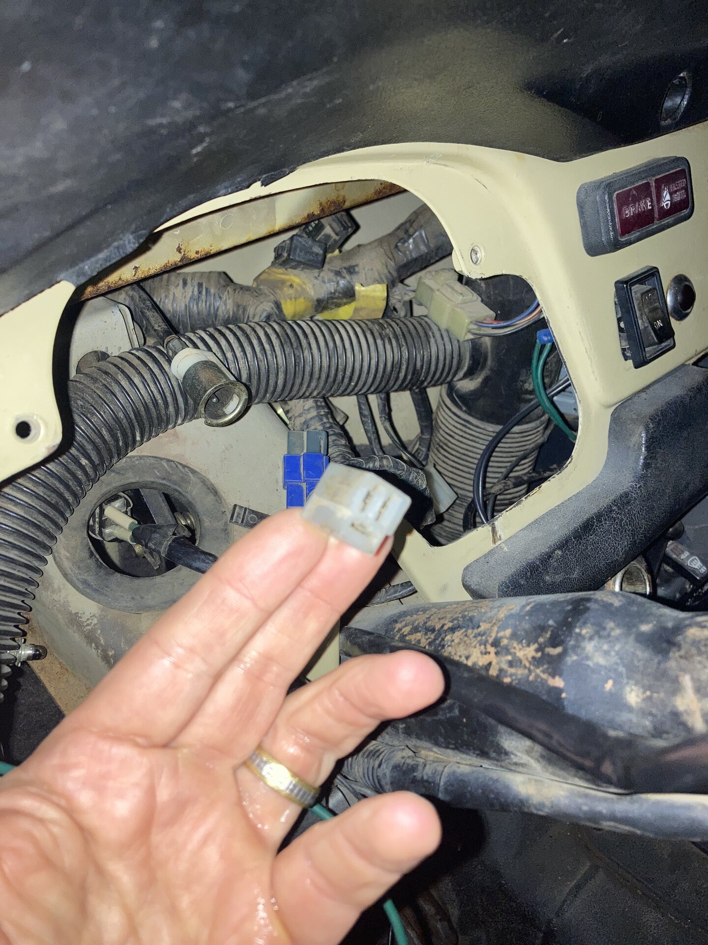

In process of finishing engine install of the original 3b from the 13B that blew a hole through the piston. Had the 3B running and after I pulled the instrument cluster without disconnecting the battery ground, now I have no power when I turn the the key. No power to any fuses/fuse box. I checked the fusible link, and fuses coming off the battery in the engine bay and I am getting power to those . I don't have power to anything in the cab with exception to this wire I am holding in the pic below. -see pic below. This wire is hot with or without key in ignition. Any help will be greatly appreciated.

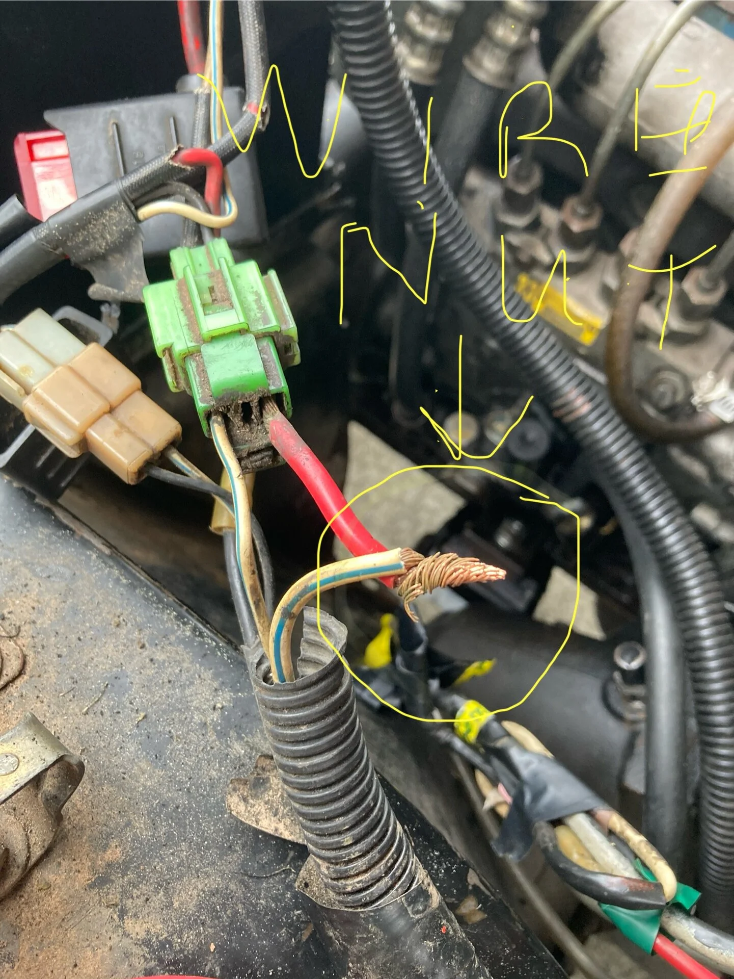

Thanks. My buddy found it while testing the wire that connects to the other side of the fusible link. It was an added wire by someone and it was secured with a wire nut and electrical tape. When I was pulling my primer pump to try and fix the leak, just before I removed the instrument cluster, I must have put enough pressure on the wire while leaning over the truck and I loosened the connection under the electrical tape. When my friend was moving the wires around testing them , he moved it enough to get sufficient contact and I was able to get all the power to the cab as usual. I removed the wire nut and connected it properly and now all is good...at least with that area of the vehicle. There are several other wire nuts here and there and I am trying to pick my battles.
Here is the photo of the problem that we fixed.

Thanks. My buddy found it while testing the wire that connects to the other side of the fusible link. It was a added wire by someone and secured with a wire nut and electrical tape. When I was pulling my primer pump, just before I removed the instrument cluster, I must have put enough pressure to loosen the connection under the electrical tap. When he was moving the wires around testing them , he moved it enough to get contact and I was able to get all the power to the cab as usual. When removed the wire nut and connected it properly and now all is good...at least with that area of the vehicle. There are several other wire nuts here and there and I am trying to pick my battles.
Here is the photo of the problem.
that's not generic factory attachment! 😁M
Most definitely. I am still in dire need of an exact BJ42 wiring diagram. Any leads to getting it would be greatly appreciated.
