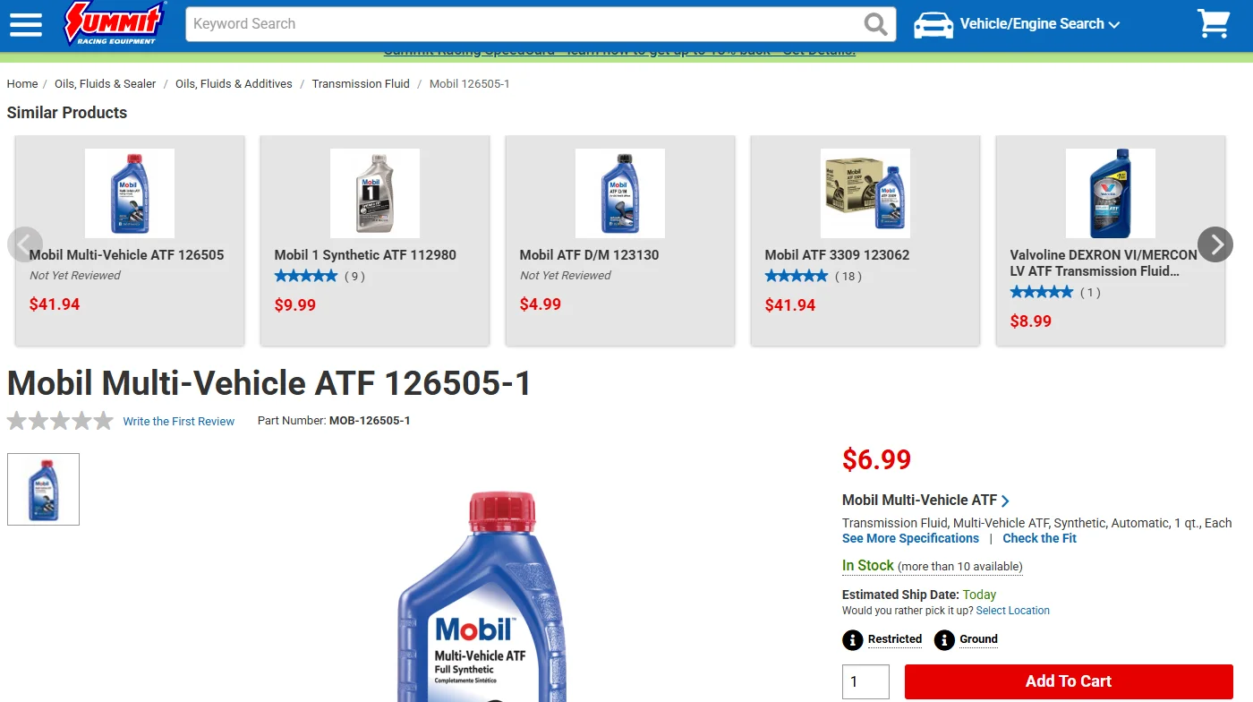

The first thing to do is check your transmission fluid. If it is not at least dark red (new fluid is bright red), or if it hasn't been changed within the last two years, it shoud be changed. It's not sufficient to simply drain the pan; you can't get all the fluid out that way. The best way to do it yourself is to use the transmission pump to exchange the fluid. You'll get almost all of it out this way. There is no filter, as such (there are three small strainers in the valve body and one large strainer on it, but those rarely need to be cleaned. You'll need 12 quarts of ATF; I use Mobil multi vehicle ATF (126505):
Summit has the best price I've found.
