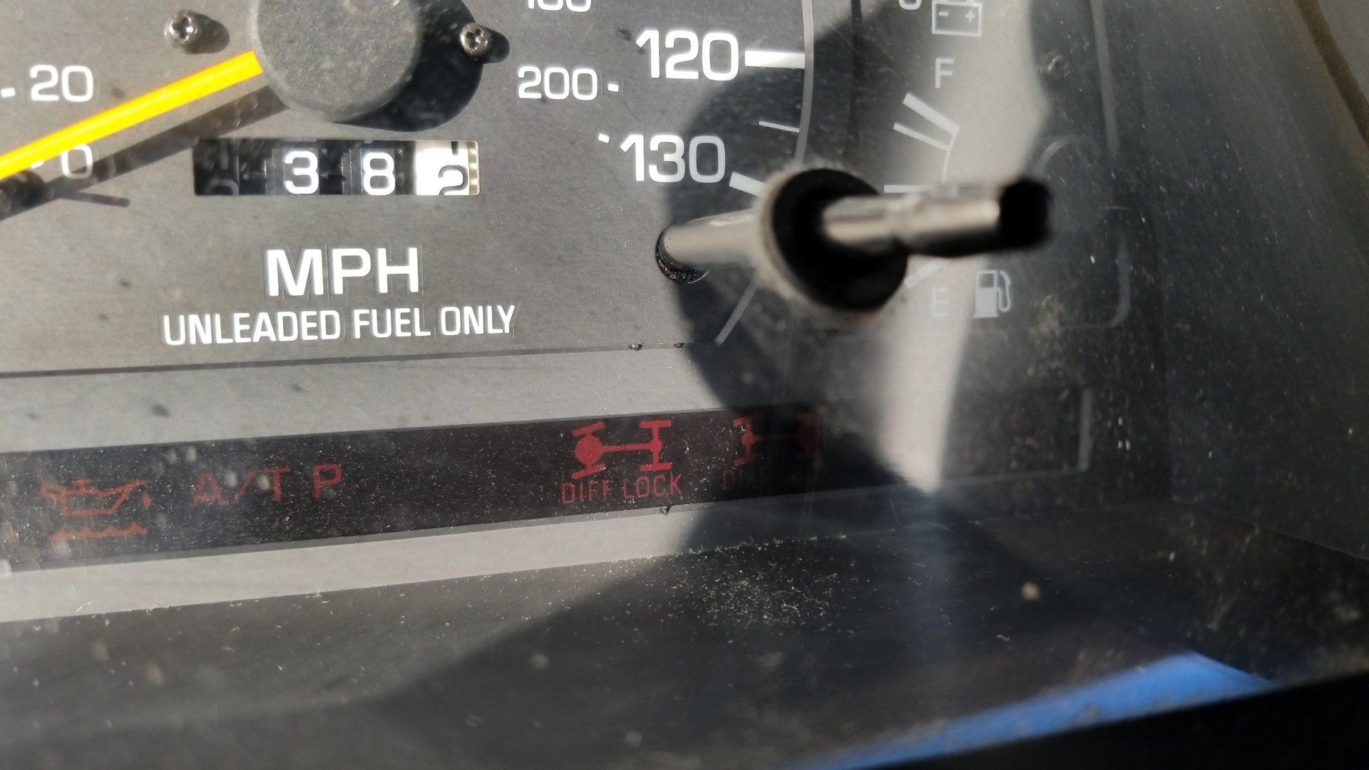

I was just curious as to why my unlocked fzj80 has a diff lock light on the dash anyways? Is it because it was an added option? Or for aftermarket install? Just wondering.
They all have the lights!
They all have the icon in the dash, but the unlocked ones do not have the bulb in the socket behind the icon - at least the ones I've rummaged behind the dash of. The wiring is present behind the cluster, so you can fairly easily insert a bulb and holder, tap into the wiring and make your locker lights work with your ARBs, Harrops, etc...
