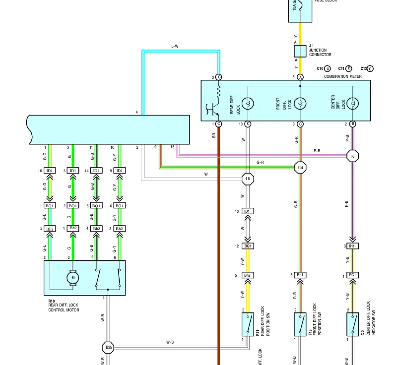

Couple days ago I was driving down the highway and noticed my front locker light was on. Made me jump off a second. Realized locker is not on, just light. I would go away sometime and flicker back on.
The CDL light is not on. The locker is not engaged. If I shift into low I can turn the front and rear lockers on with out issue. Sometimes when I turn off the light goes out and sometimes it doesn’t. I believe I have short in the sensor for the locker but not sure. I have have unplugged at locker harness and up on fender and made sure both are clean. Next step is to source another locker harness and see if that clears it up. Any other experience with something like this. Can not find result in search
that light comes on when switched to ground. You have a short bewteen the light and it's switch or the locker ECU.
Somewhere on the green and red wire.
Thank you . I will proceed along this line
