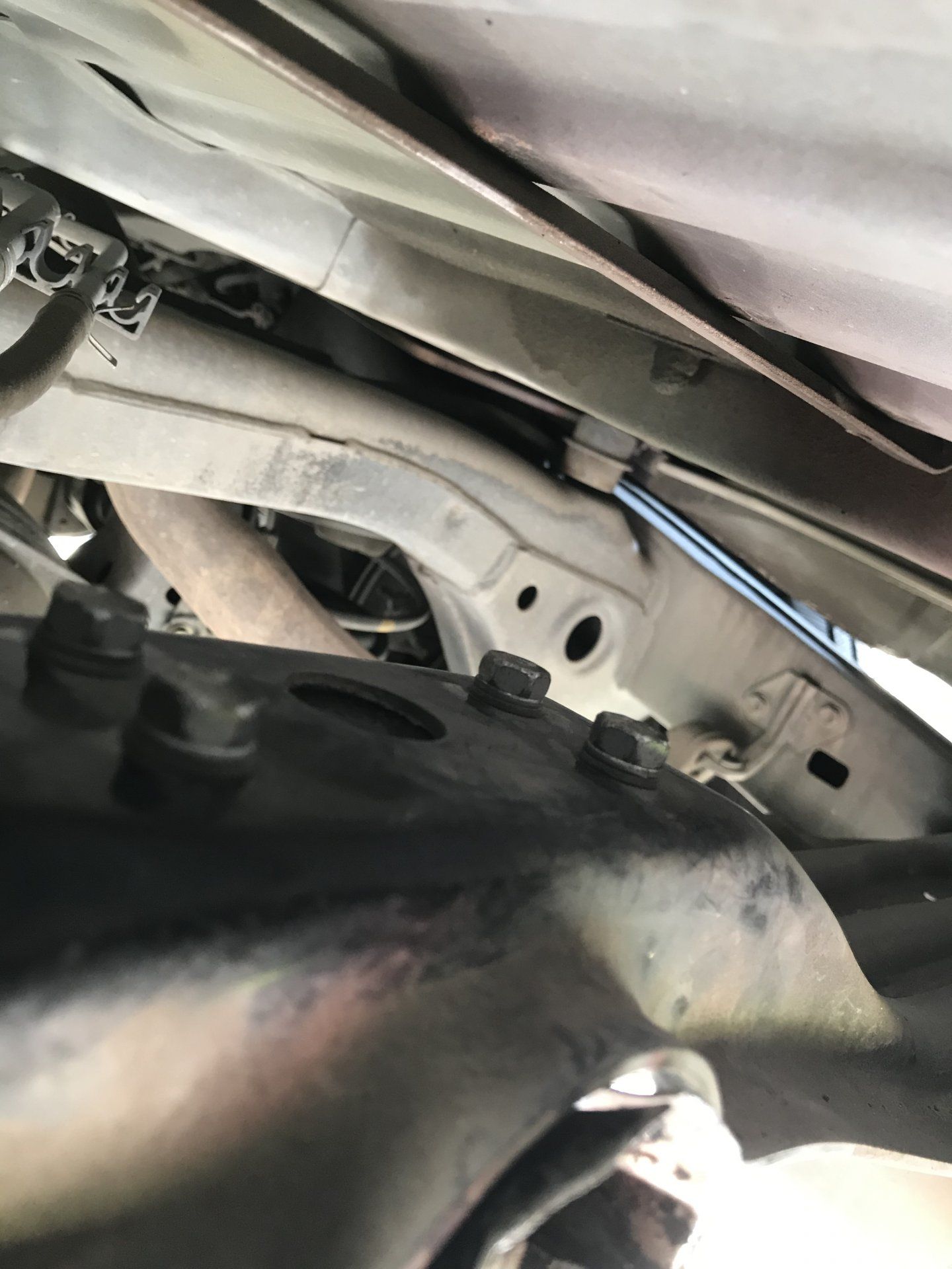

This is the actual spare tire holder that you want to remove . Its attached to the cross member with 4 bolts
Here are The 4 bolts on top of the cross member for this removal. You can approach this from the driver side rear bumper by passing your hand above the tire And easily undo the bolts. BE CAREFUL the tire will fall down and is pretty heavy. Have a jack stand under it to prevent getting crushed

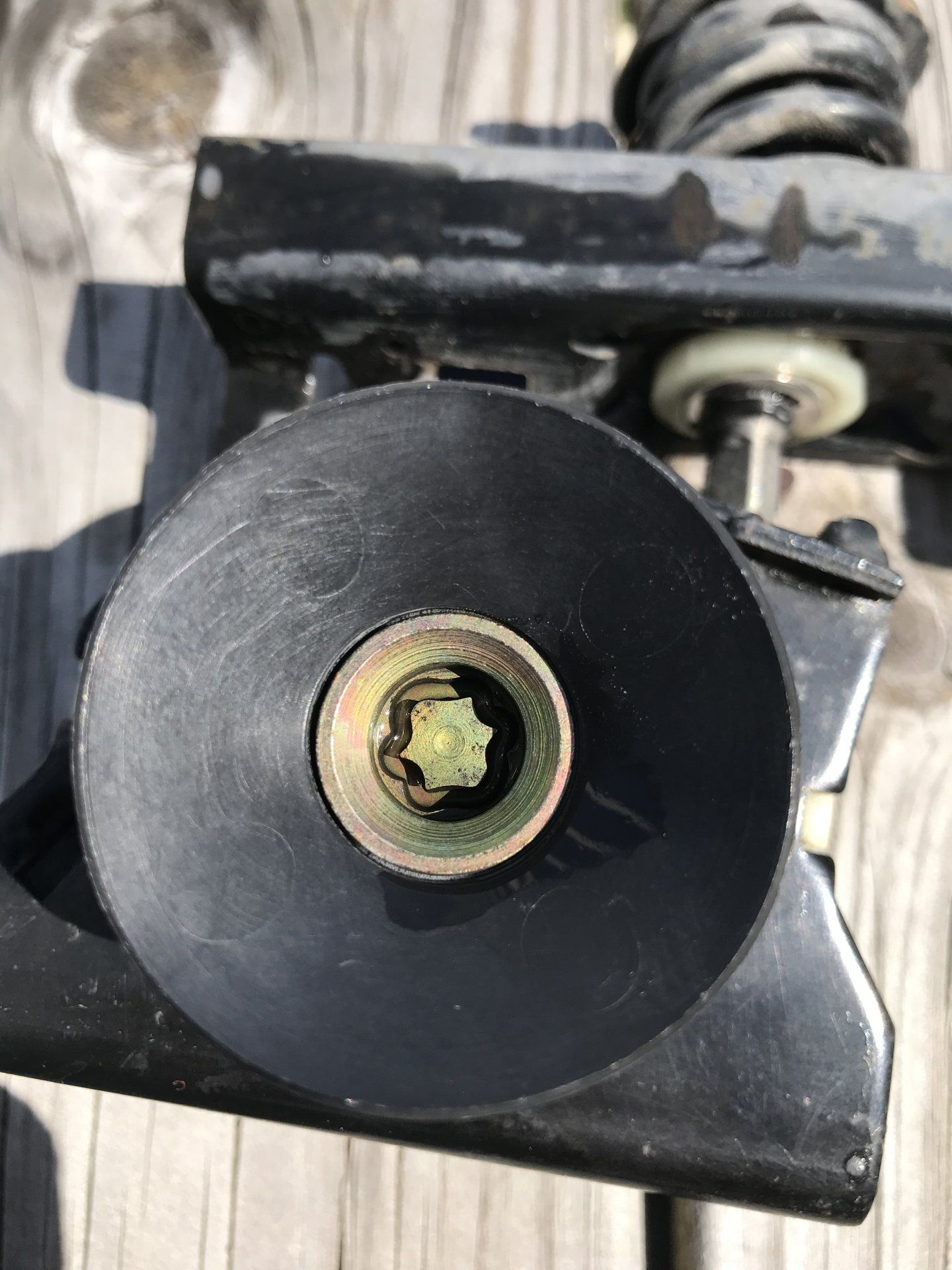

Once thats done you will get to this

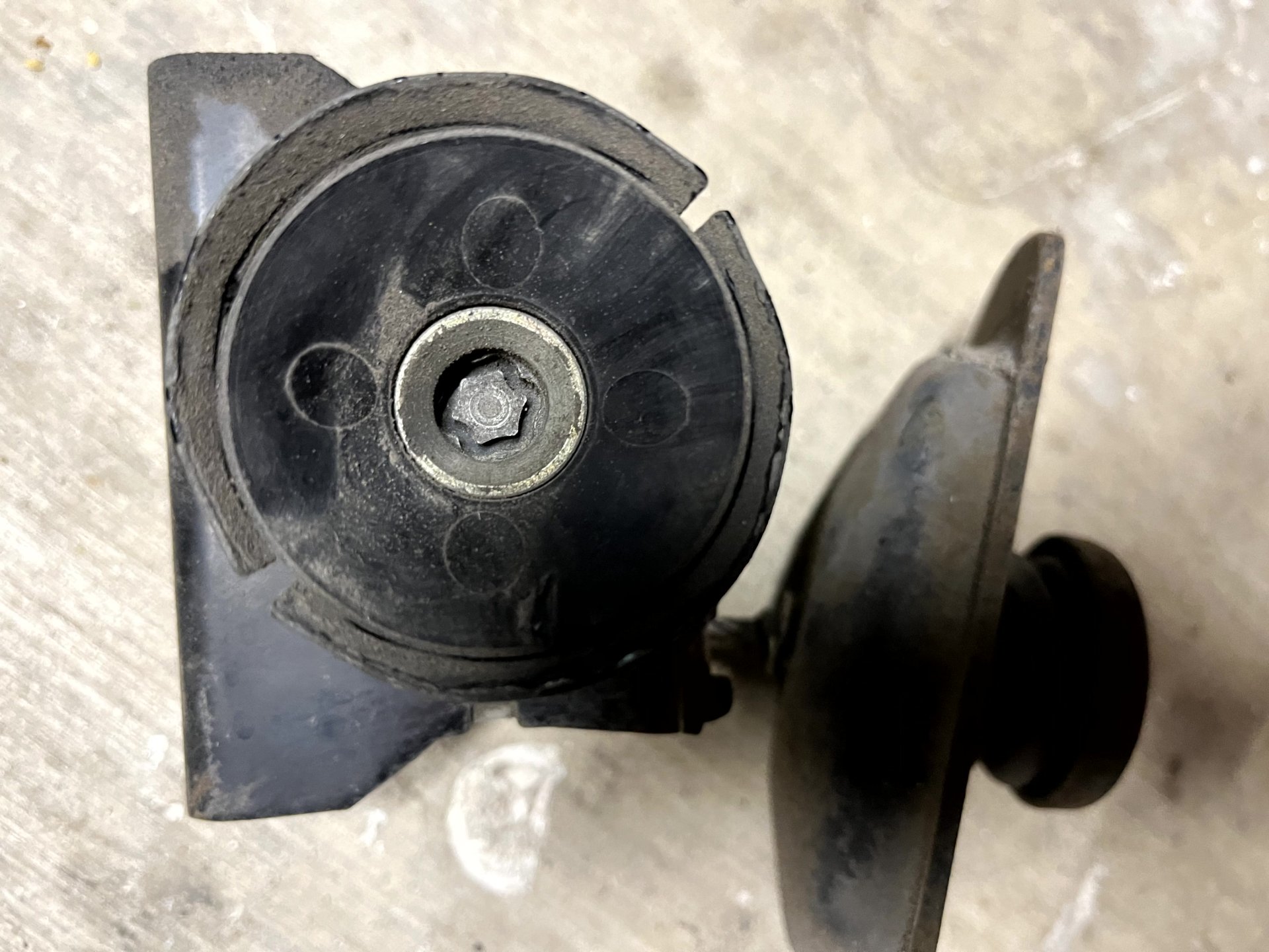

Now to remove the lock key just pry off that black rubber funnel like thing and use a flat head to hammer down on the star shaped washer holding the lock nut in place.

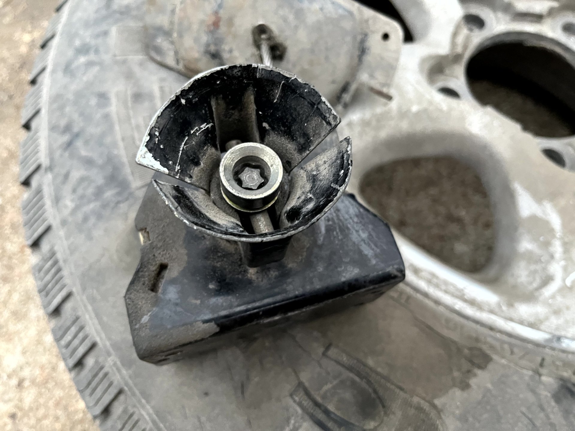

Thanks for the tips here. Just wanted to provide a little more detail for others interested in removing the lock.

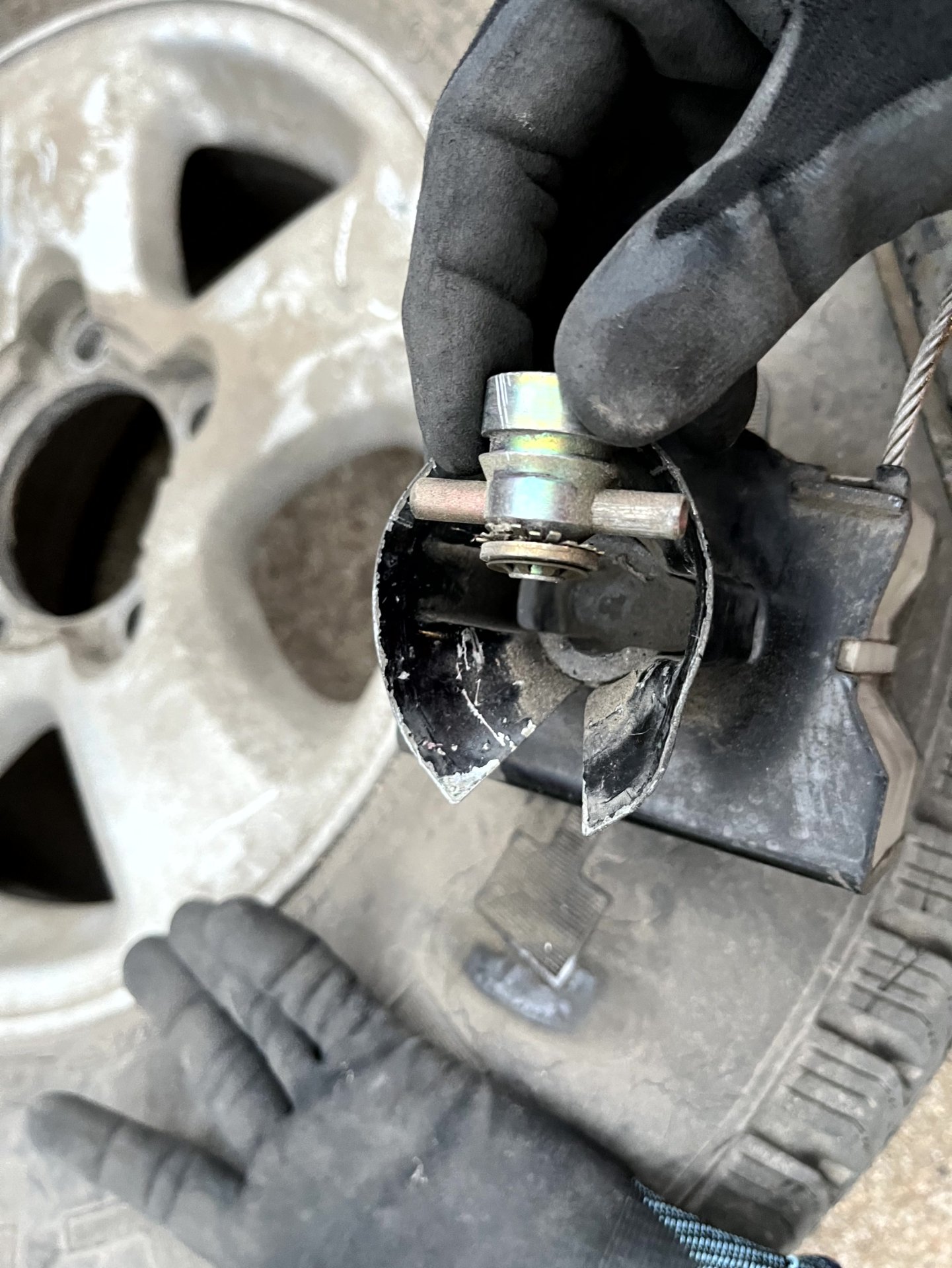

I cut the plastic cone with a razor, down the slit on the metal cone. Came out easier than prying it out. Don’t need that cone anyway.
Here’s that star washer that holds it in place. It appears when I hammered it down with a screwdriver I basically broke a few teeth or weakened them so they would bend as I pulled the lock out.

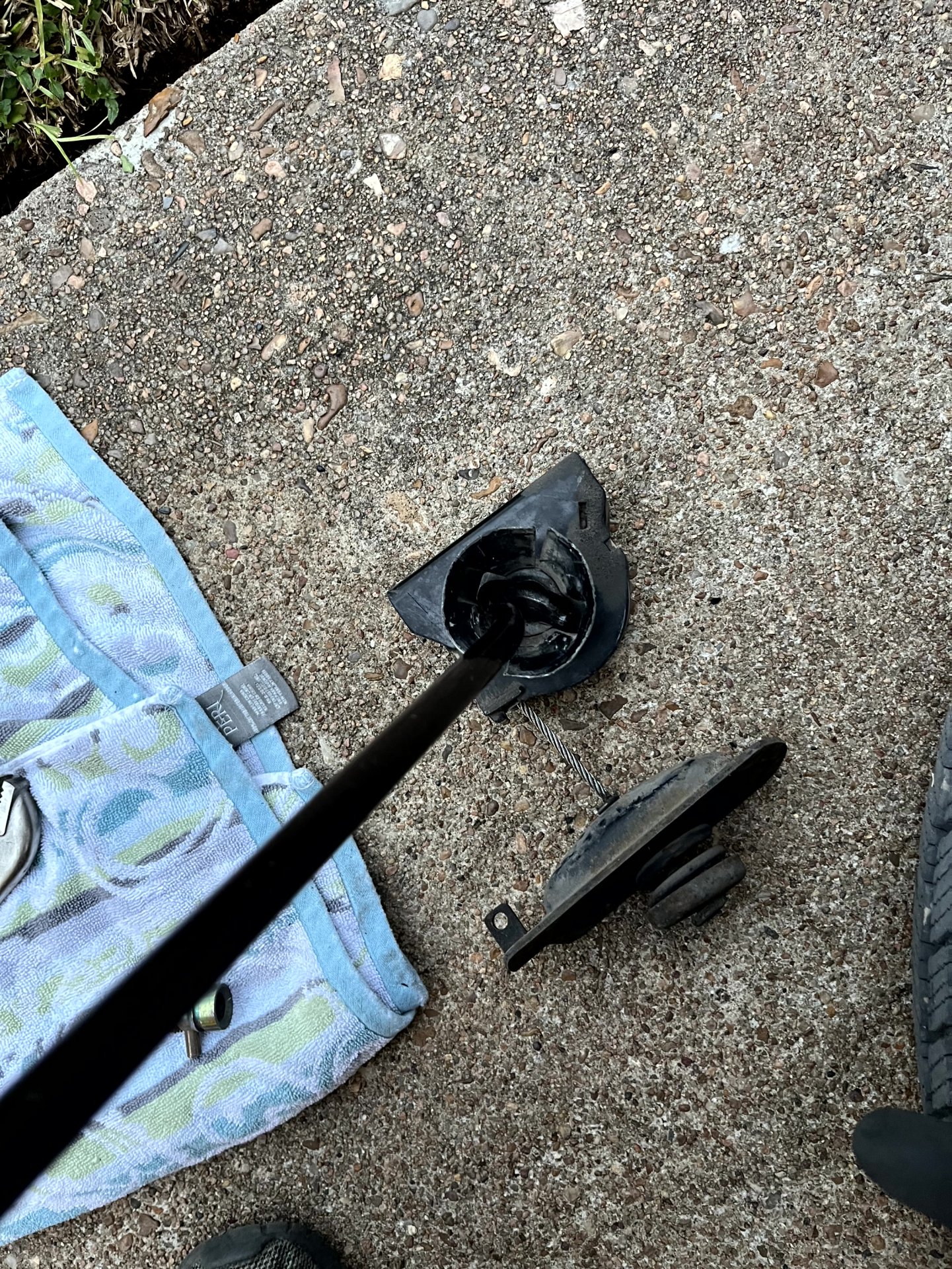

Am I just a moron? My bolts are rusted so I'm trying to do it from underneath the truck, but for the life of me I don't see how you get at the star-shaped washer? I've got the plastic collar/funnel off and here's what I'm looking at:
I don't understand how to get at the star washer since it's on the other side of this lock. Am I supposed to be able to pass the screw driver between the metal collar and the lock? Doesn't seem to be working for me.
The serrated washer sits down in a bore, just rock the anti-theft key back and forth and in awhile it will distort the washer where can pry the whole thing out.
