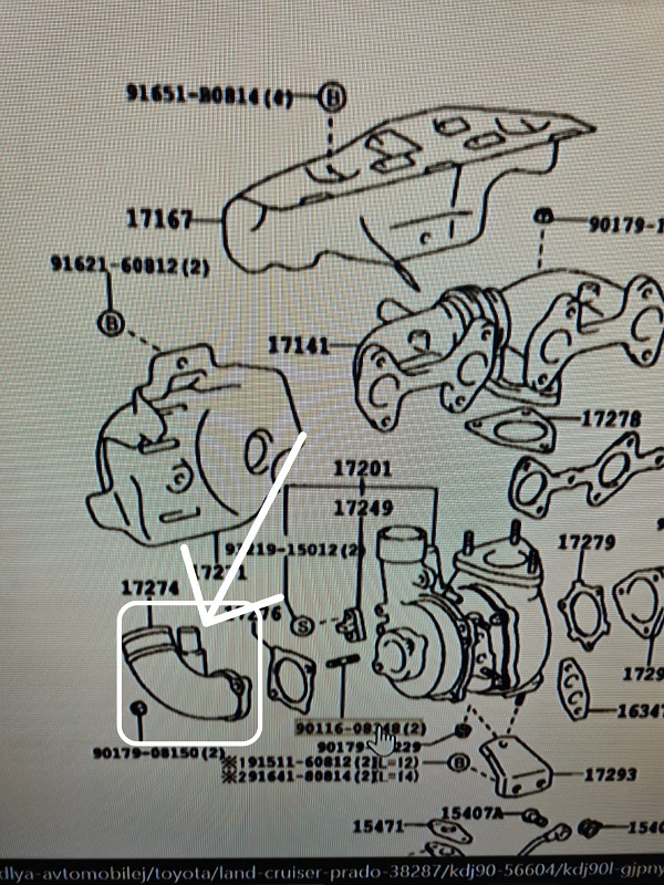

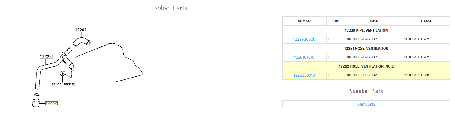

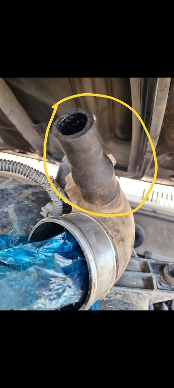

Hello guy's,
I'm searching for a friend of mine a hose that connect from an elbow near the turbo, sadly i didn't found any references to this hose on any catalogue or website.
thank you for all your help.
samual
It is probably serviced as part of the 17274 elbow.
Get a new elbow. It should include the hose.
That's how you get sub-components that are not serviced separately. You buy the assembly.
Other avenues would be try to find a good used one or engineer some type of field repair of the original.
