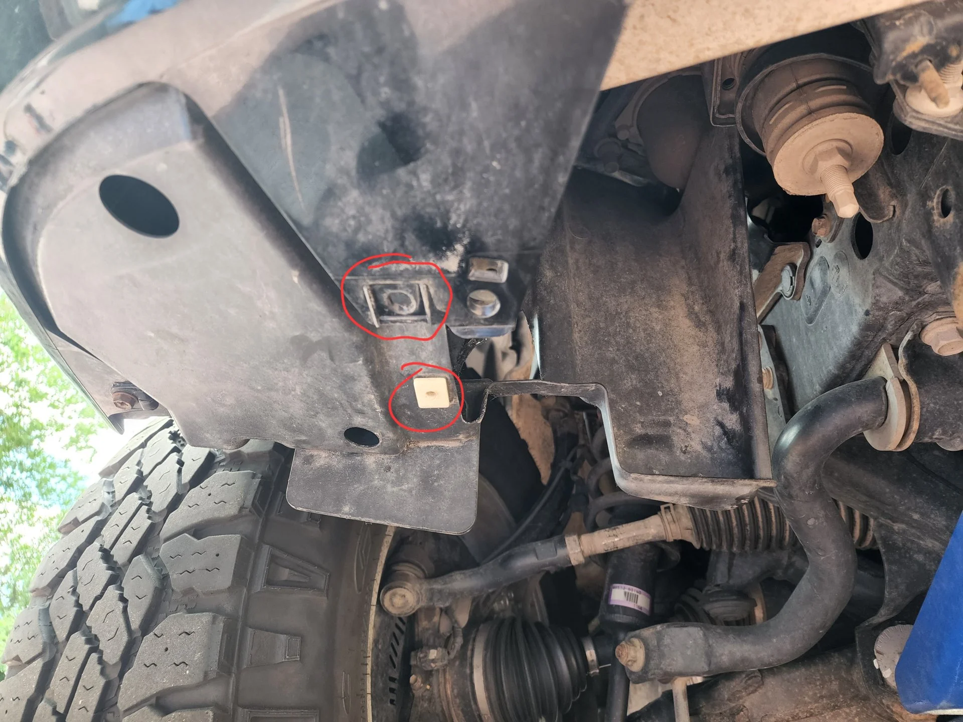

Just put on some spidertrax spacers to try and get rid of some inner tire rubbing at full lock and in the process found excess rubbing on the front fender liner.

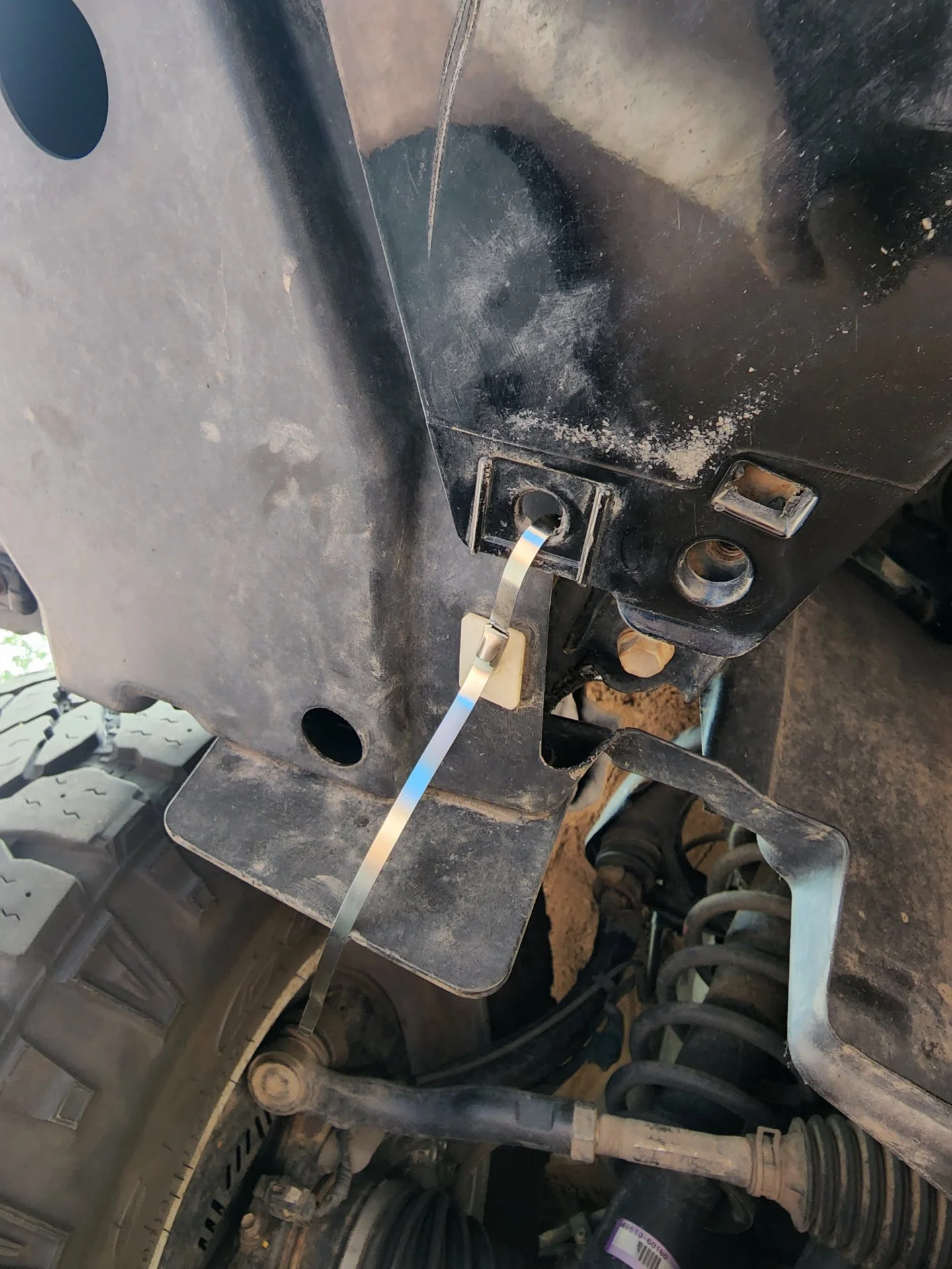

I read some threads from @TeCKis300 and others that were either cutting, heat gun or in @TeCKis300 case, drilling. None of these were daunting, but as I was playing with the liner I found a simpler path with just a zip tie. I had some metal ones on hand, but may replace with heavy duty plastic to avoid any sharp ends.
All I ended up doing was re-aligning two of the holes and it made a significant difference. Plenty of clearance now on 33s (275/70/18), can't promise what it'll do for 35s.
Nicely done. I like how it just pulls the liner forward as you tighten the zip tie!
