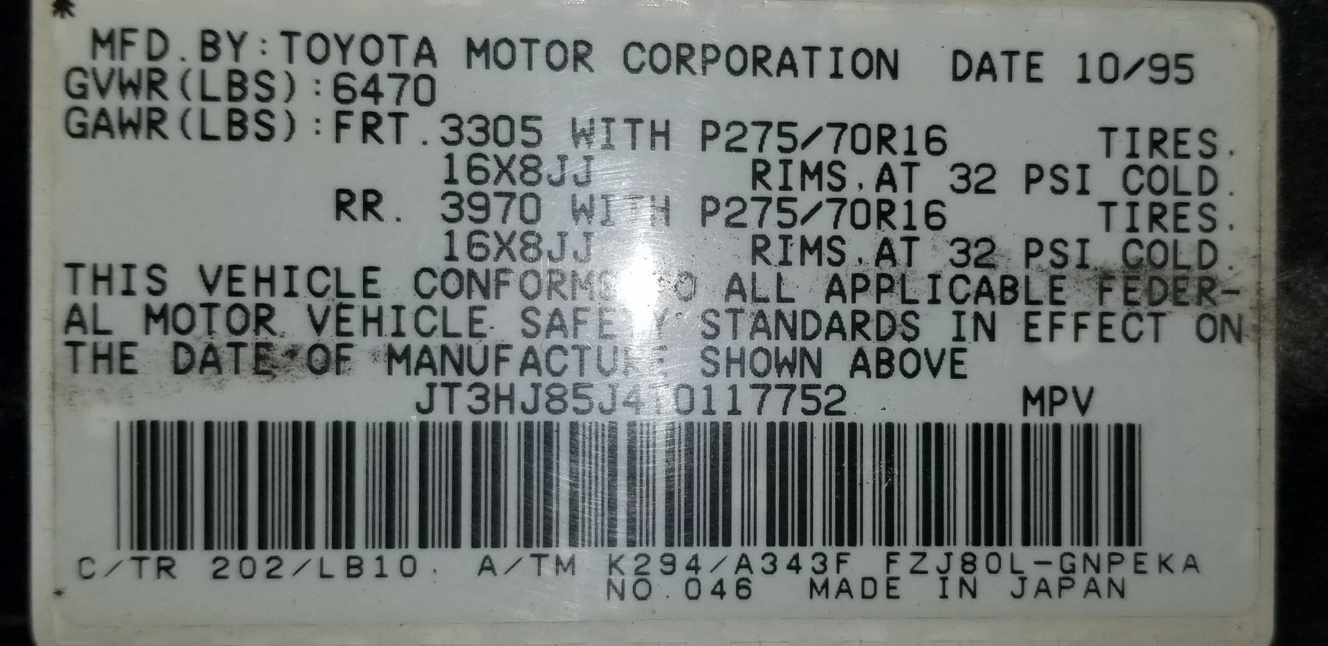

Here you goThen it was probably a '95. Post a picture of the door tag and/or port.
Here you go![]()

Build date 10/95 either could be a 1995 or 1996. Most likely a 1996
It's a real gem alright... I just dont know what would cause the no CELA "T" in the 10th position of VIN indicates a 1996 model

I'm sorry... I was mistaken... the door tag in the pic is the recipient . I'll get a pic of the donor door tag donor tomorrow. Thanks for the heads up on the starter fluid posts. I'll read through them.What is the VIN tag from the truck you are trying to make run?
You showed one with 10/95 which is a 96, but you are referencing a 10/94 which is a 95.
If you actually have a 94 I'd be willing to bet it's the VAF/MAF/SMF whatever the hell it is for that year.
