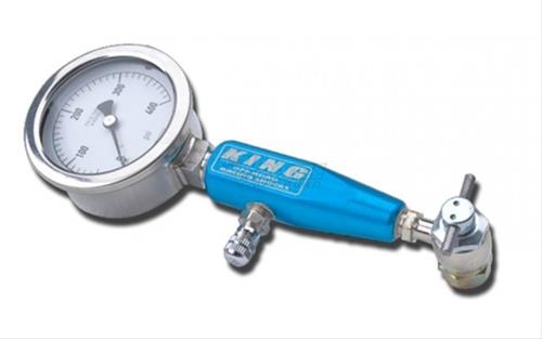

Edit2: I looked at the King manifold but you still need to have a schrader chuck off your nitrogen regulator and hose. screw-on versions of those, which are needed for these pressures, weren't cheap. That's why I got the manifold I did, as it's all built into one.

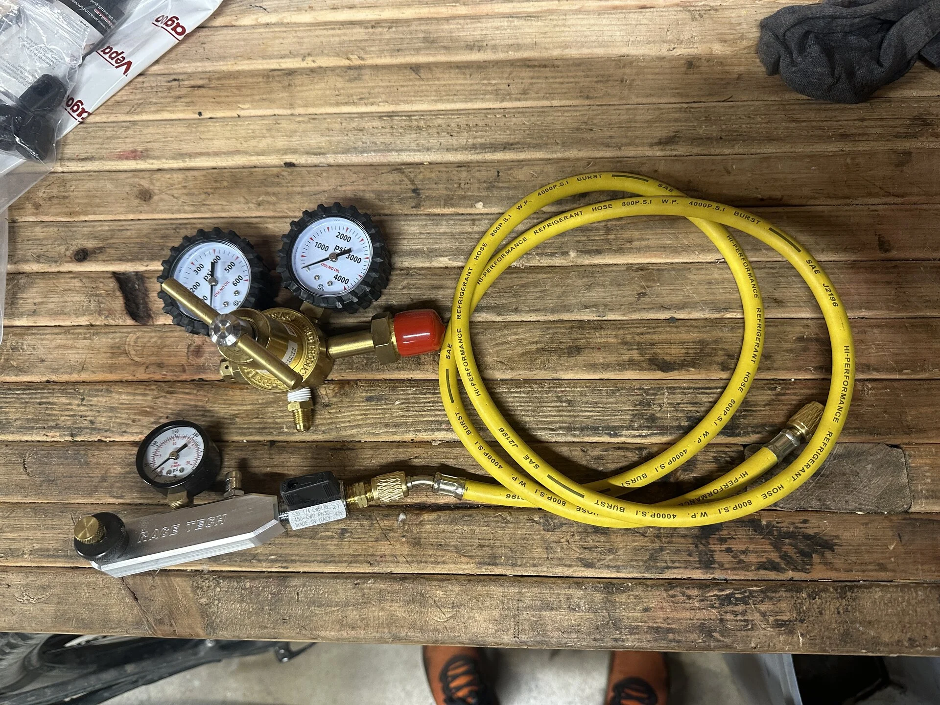

The regulator itself off the cylinder doesn’t need to be super high precision. If you overfill you can just bleed back down to your set pressure. What needs to be quality, from my messing with things, is the schrader adapter and gauge. We are putting a lot of pressure through this fitting and virtually any leakage during disconnection will noticeably bleed down the reservoir pressure.
Also standard air line will usually do the pressures we are working with but waste a lot of volume and tend to grow quite a bit. Using AC type hoses and fittings works better. A short J2169 hose is what I got.

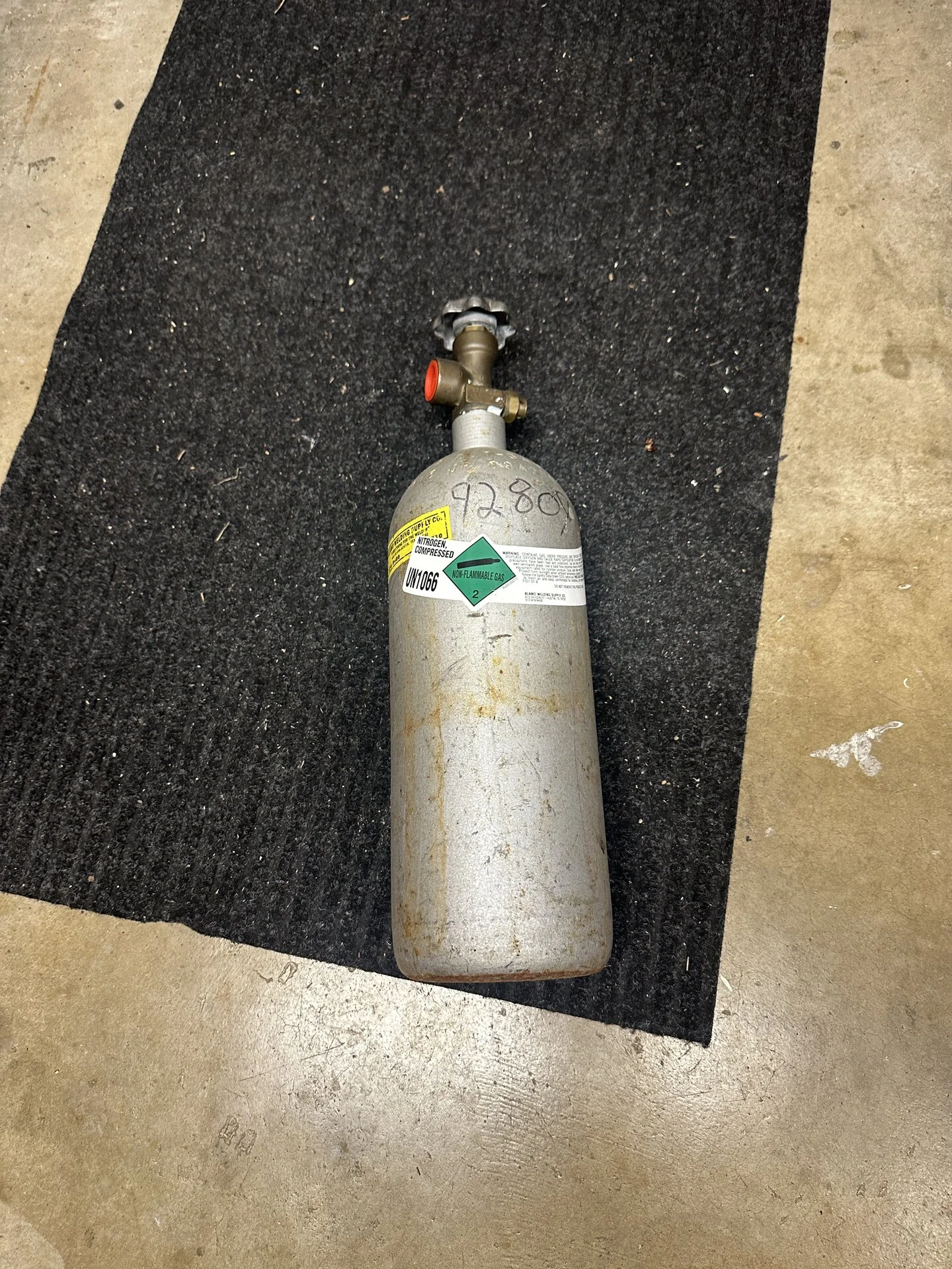

I bought a uniweld 400psi nitrogen regulator on Amazon for about $90, then a nice Race Tech Pro gauge and adapter for about $130. A used (but still well within hydro test) 20 cubic foot cylinder from a local welding shop.. I can’t remember how much but it was cheap.. then nitrogen refills are really cheap.

I scrounged up quality American made parts and made my own kit. I didn't want a made in China kit even though I could get them for less. My welding flow meters that were made in China only lasted a few years. My Victor that I got in 1987 is still working.
The regulator is a Harris 25GX-500-580 Nitrogen Purging Regulator. I got it for $95
An Ashcroft 300 PSI gauge for $18.99
A SS high pressure mini ball valve for $17.55
A Genuine Schrader 556 No Loss connector for $25
I had a few old R12 A/C gauge sets off the tool trucks that I used for the fittings and hoses.

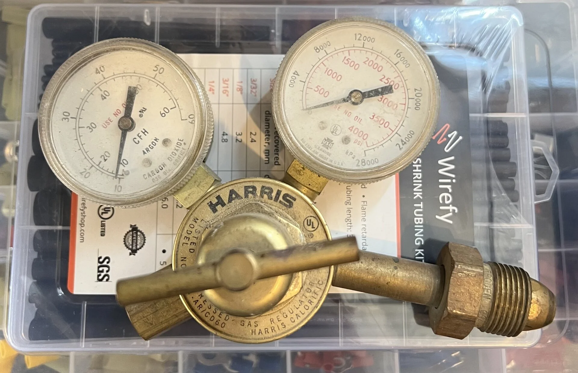

Could I use this if I swap the CFH for psi guage and the inlet to the CGA-580? Or am I being foolish and should just buy a properly setup regulator?!
I have this left over from a portable tig setup I used to own.
Great info in this thread! I now have a new shopping list. I agree with avoiding anything Chinese. For AC work, I paid the premium for Yellowjacket manifolds after hearing stories of faulty Chinese manifolds/regulators leaking or being off 6-5% and as a result people where chasing leaks in their system that were not there.
I haven’t taken a flow meter apart yet, but was taught they are different internally. This makes sense given their different functions.
I think you’ll need to do some research. Please post your findings..
IDK if you can use the flow meter type regulator. I searched welding supply websites, found American made regulators, googled the part numbers and looked for the best prices. I found all my stuff on eBay. I also had to buy new barrel seals for my old A/C hoses.
