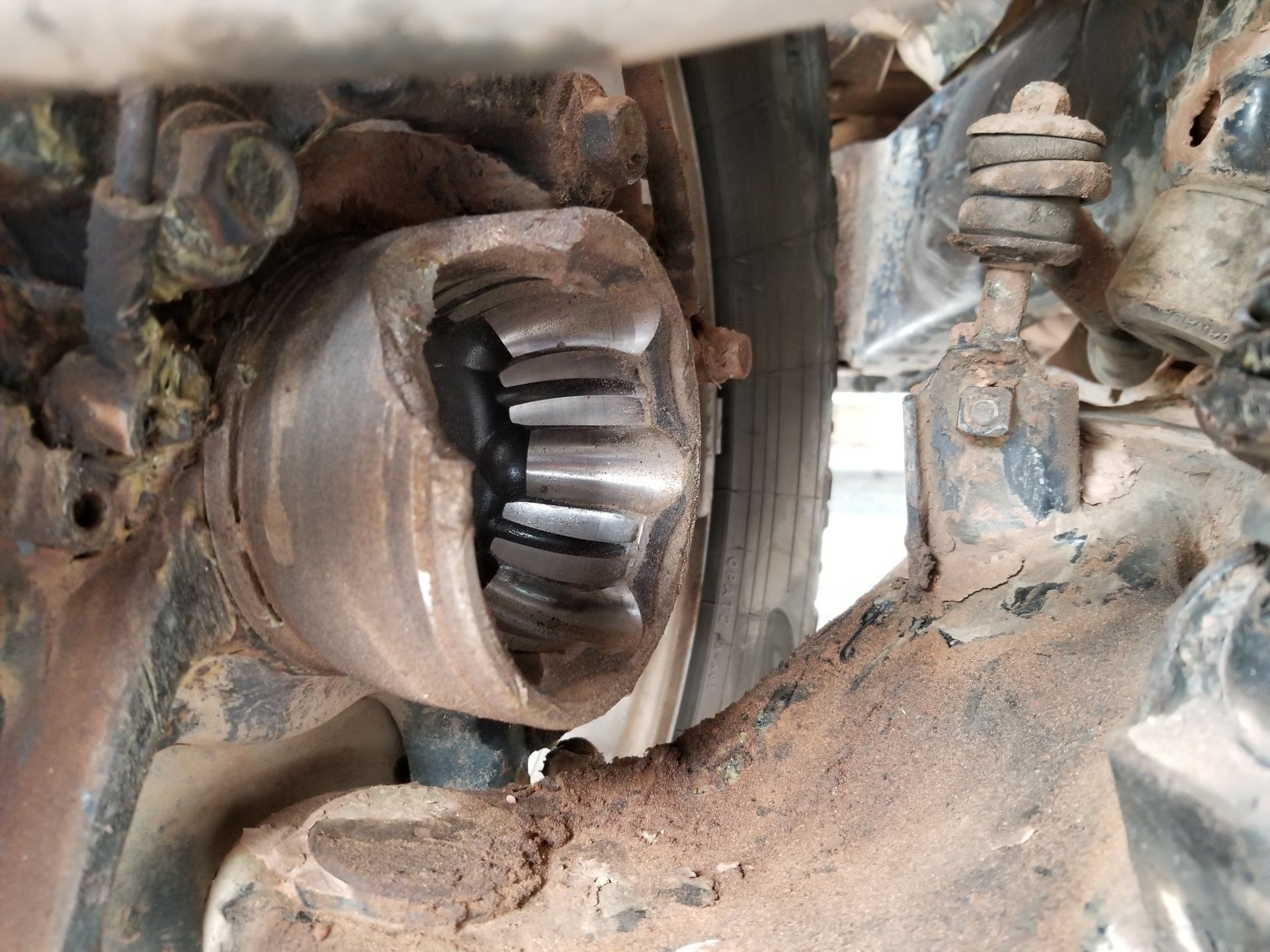

See if you can figure out where it failed ;) Unfortunately, it also took out my passenger speed sensor... Bummer.
1970887

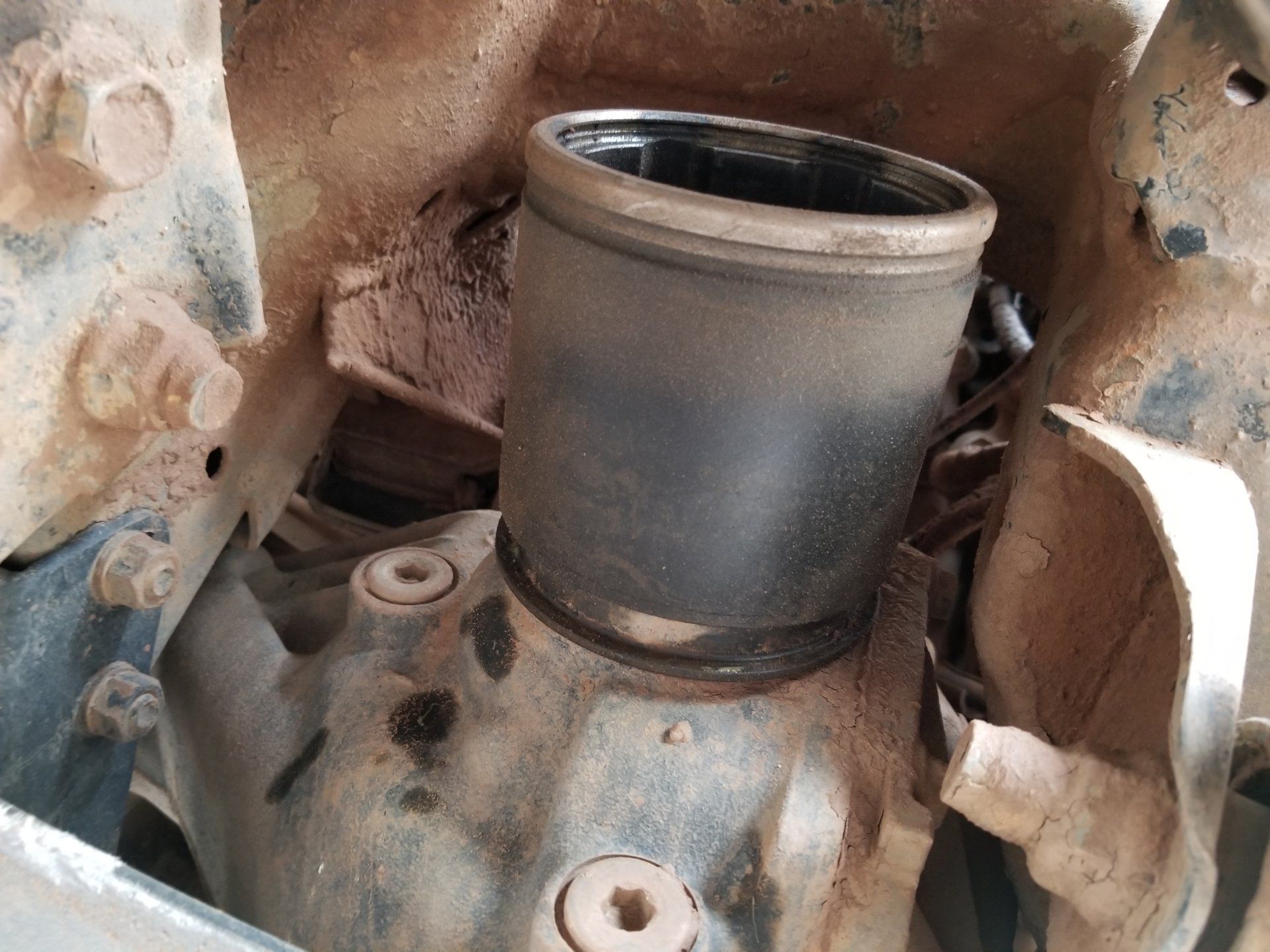

Here is a shot at the diff. There is a c clip at the end of the cups that hold everything in. You can just remove that and the shaft and bearings will just slide out. Make sure to wipe out all of the grease so it doesn't sling all over the truck and pollute the trail.
1970890

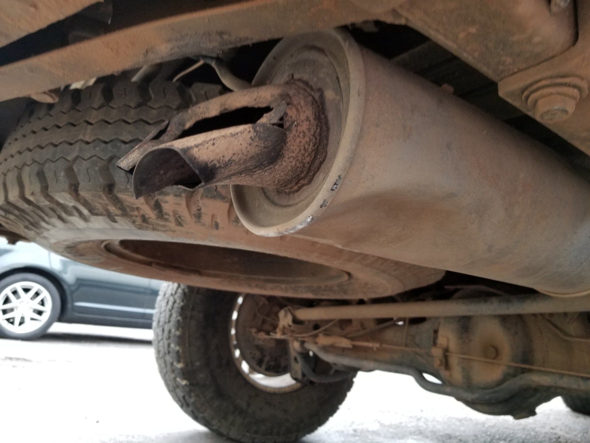

Also, I might have tapped my rear muffler a few times....
1970891

I had it at full lock going up an obstacle. I gave it a bit too much gas and the breakage was the result. Too much gas combined with near full lock was my mistake and a learning opportunity. Oh well and no big deal. It is time to find another CV.
