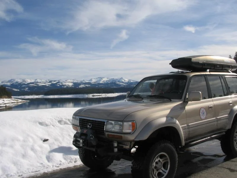

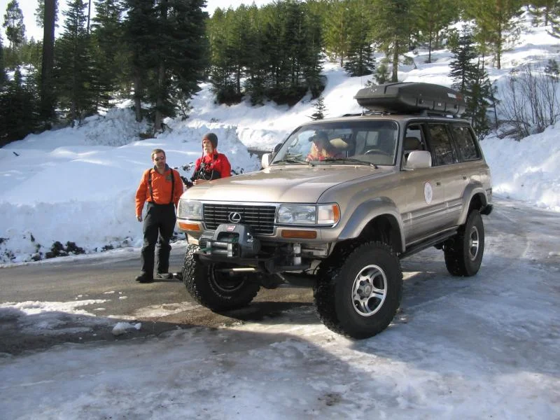

Some Pics
OK let's see if I did this right.....
1st Pic is just a canyon or two over from my house on trip with my Dad. Hmmmm.... cut my hood off, oh well nice canyon. Next two were on SAR excersize up near Union Valley Res. just below Desolation Wilderness and not to far from the Rubicon. I forgot to take the cool pics of the 40 series leading us (jeeps and me) on the snow run:whoops:

Nice rig!
