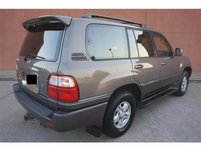

I picked up a 99 LX back in December, and this site has been a great resource both before and after purchase. I wanted to wait until I had something to contribute back before posting up.
Details: 1999 LX 470 195k miles. Smoky topaz (I know, I believe it has had quite a bit of repainting done already). The only paint issues it had when I first looked at it were on the "soft parts" The C pillar vents had the typical fading issues, and all of the clear coat had blown off of the side mirrors. The dealership did quite a bit of paint and body work prior to me taking delivery. Here it is the day I picked it up late December.
And back home:

I have the exact same vehicle (year model and paint color). Its amazing how different Smoky Topaz Mica looks in different light settings. I also happen to like the Factory Head Unit just fine. You are the first person I've seen actually tear into one though. Most Radio Repair shops won't touch them.
Nice, I like your truck! You're right about smoky topaz mica, it looks completely different based on lighting. Yours looks nice without the chrome wheels and with the rear window deflector. Does your CD changer work? As I tried in vain to find a service manual, I did turn up a couple PDFs from Fujitsu talking about how this was the first compact in-dash 6 disc changer on the market.

Wow, that paint looks great. Congrats on the purchase (albiet I'm late to the party on congratulating you). Seattle/Tacoma has a lot of LC's, and is an overlooked area for people when searching as the vehicles purchased and native to that area are usually quite rust free.
