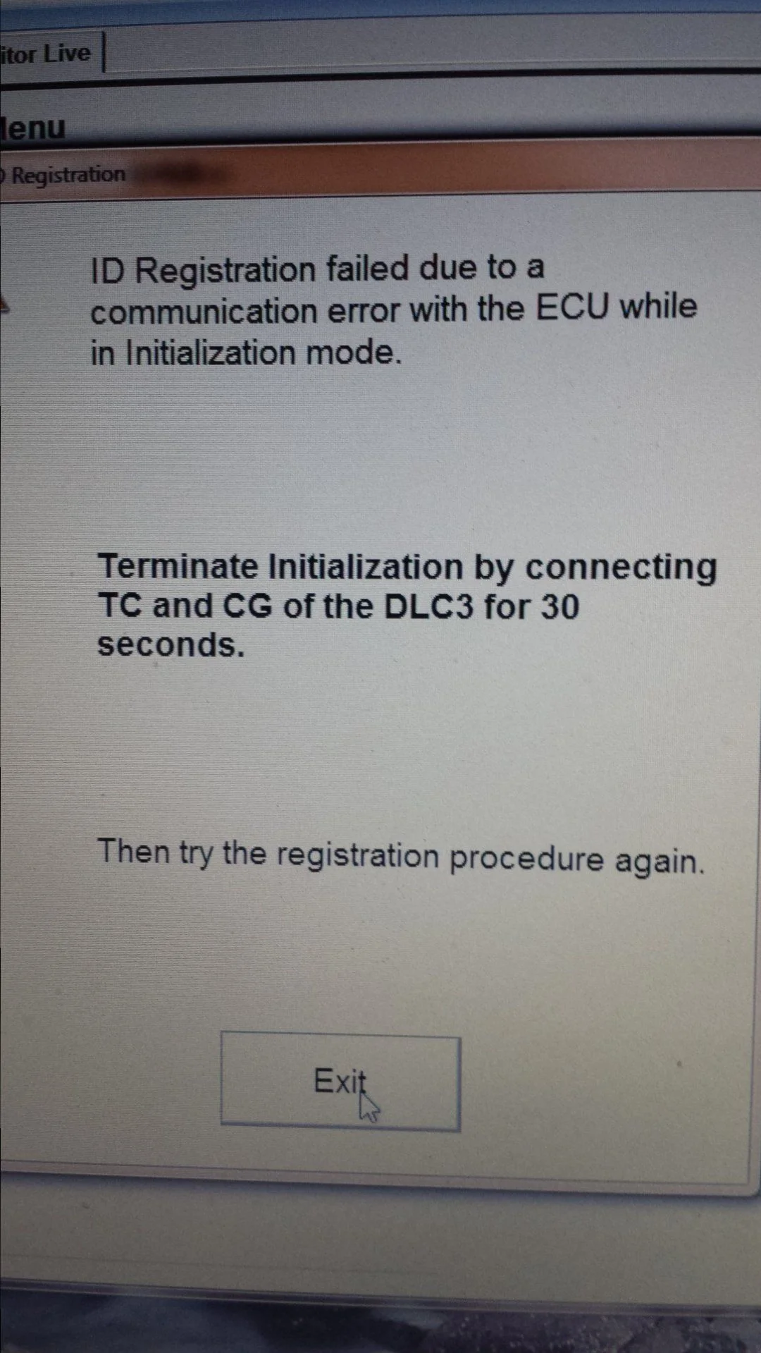

I've tried the exact same thing. I put the codes in quickly (within the 5 minutes) but get an error (been over a year since I tried so I don't recall what the error is). Others have reported the same issue I have had in a different thread.
Edit: Here is the error I get. I first tried with a 1.4.1. cable, which I was told would not work, so I paid a good amount more to upgrade to the 2.0.4 cable but still get the same error.
