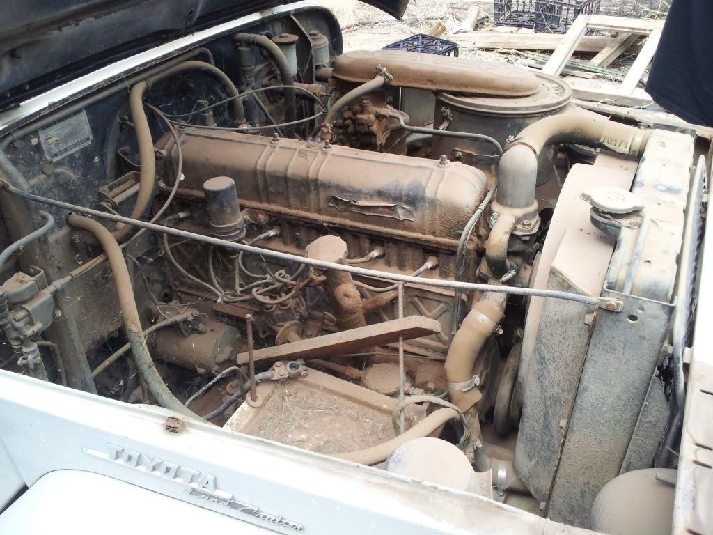

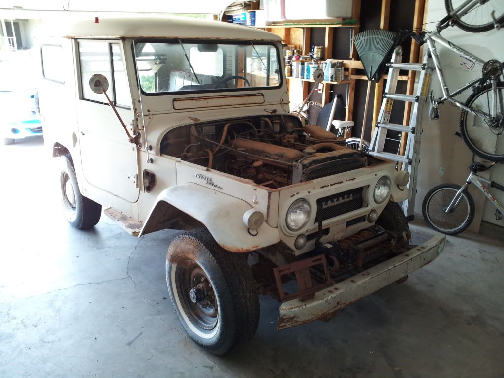

Hey, it was recommended I post my early 40 here. I just picked it up about a month ago. Towed it home from its 15 year resting spot in someones back yard. Appears that it was well taken care of, and someone of a daily driver till that point. I have it running now with a Weber carb, however holding on to the original to likely have rebuilt and put back in later on. Waiting on a gas tank and brake and clutch master cylinders to arrive and I get to take her out for a maiden voyage hopefully this week :bounce:. Then its down to my parents house to install a 4" spring lift and 33s (not possible in my garage as it wouldnt fit out the door). I plan on driving it the way it is till next fall or winter when I will pull the body off to patch, clean and paint sky/smurf blue. Heres all the pictures I currently have, first few are at the POs house where it sat for 15 years
Nice looking rig, but if I may...why the 4" lift and 33s??
This looks like a very stock rig, (a very clean looking original '65...and a prime candidate for a true restoration) and I get the feeling that by the time you are happy with what you want, you'll have changed the axles to mid '70s, with discs all around, 4 speed, 2F or 350, buckets seats, roll cage...etc, and so on...wouldn't it be easier to buy a rig with all of those already on it, and save this one for a restoration??
Not looking for an argument, just wondering why you chose a '65 :beer:
Looking at it again, I think you have a '64 titled as a '65...are you sure you want to mod this...that is a very clean looking '64...
like Dean stated, you have a fairly unmolested early rig that especially in this section is going to be viewed as an exceptional candidate for a more pure restoration rather than a modification/alteration.
I'm sure you could sell this vehicle and pick up a more appropriate rig (even already modified to your liking) with perhaps money to spare.
at the end of the day it is YOUR rig to do with as you please, you just won't get much support from this section as it is mainly devoted original equipment vehicles.
very nice FJ by the way:beer:
Like Dean said it looks like a 64. Does the VIN start with 4? It's your cruiser to do with as you choose but throw away anything you take off. Others looking to bring their cruiser back to stock are always looking for stuff. One man's trash is another man's treasure. Haven't seen anything that isn't stock. Once you put the 4" spring lift and 33" you might not be happy with the power. While Toyota made the claim these could run down the highway 85 MPH all day these old engines really shine creeping off road at low range.

I checked the vin, it does start with a 4, thanks for clarifying that for me. How could you tell it was a 64? Is it the windshield vent? I noticed pics of other 65s Ive seen didnt have that.

That is a very rare rig in that pristine condition. I wouldn't even paint it, as it look like the original paint that is still on it...a true find as stock as she still is...hence all the comments to keep her stock...very rare find indeed. I would just clean it up really well, make her safe, and enjoy her. I read in your other post that you got a polly tank...I have read a lot of negative comments here on mud about those tanks...take care when installing it.
Oh, the vent in the windshield was on until mid 1965, that is when the the new generation 40's started (around summer '65). The telltale signs for me that this was a '64 were the short running boards, no heater air intake vent on the passenger side of the cowl, and lack of decals on the rear driver's quarter.
