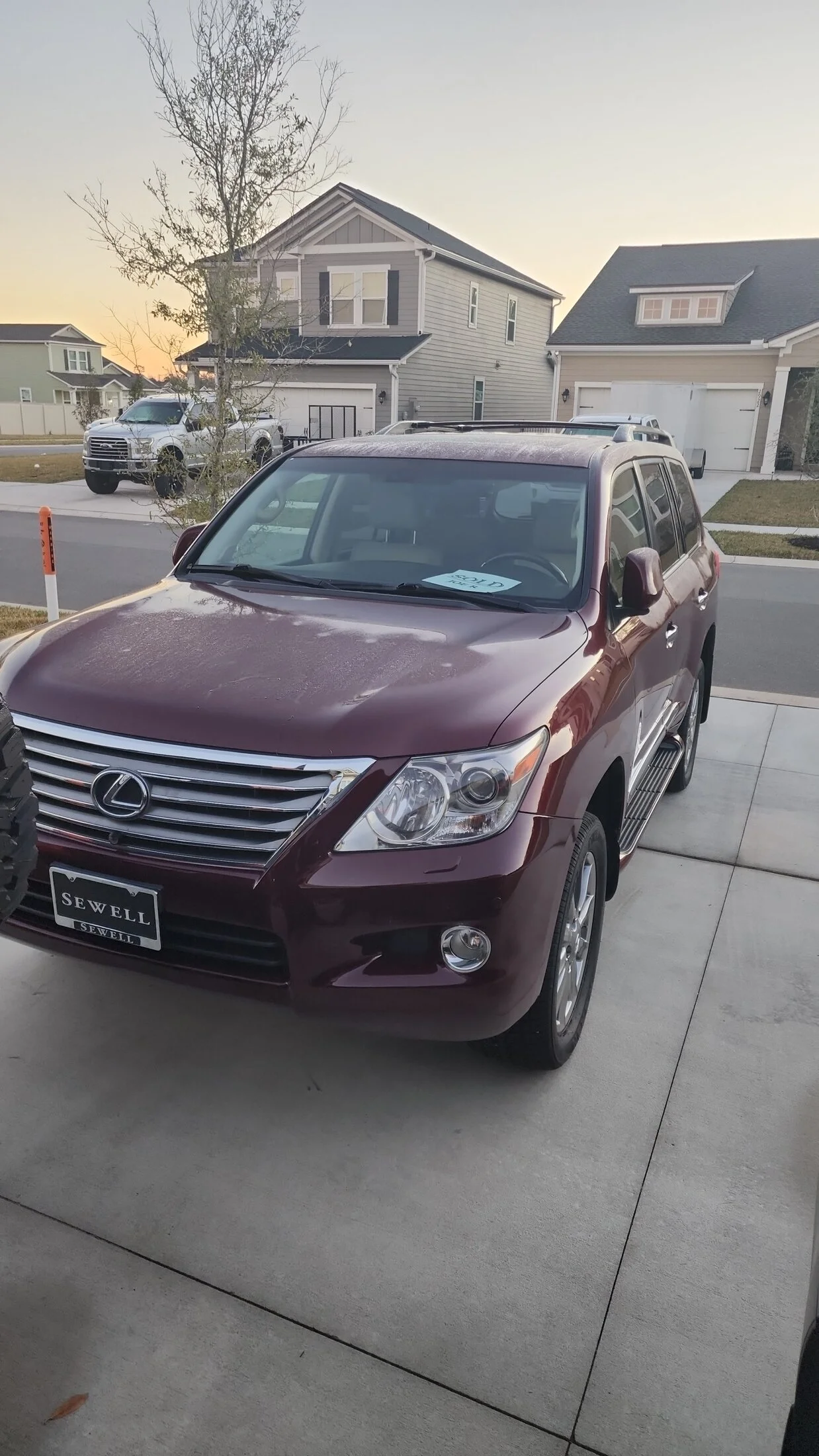

Just picked up a 2011 lx.
Bought some wheels and tires.
Nomad 17in, 0 offset, on 285/75r17 incoming.
I've read alot, but want to ask just in case.
fender liner rework, bmc and sensor lift will be all that's needed to make that size fit?
Planning on the nst spec 1in body lift eventually. As well as the front 13mm spacers for preload.
Was also looking into the terrain tamer 100 series coils, or possibly the e & e offroad rear strut spacer. To keep ahc pressures in check.
Anything else I'm missing. Please chime in. Not doing any rock crawling. Mainly simple to medium intensity trails for camping and exploring.
