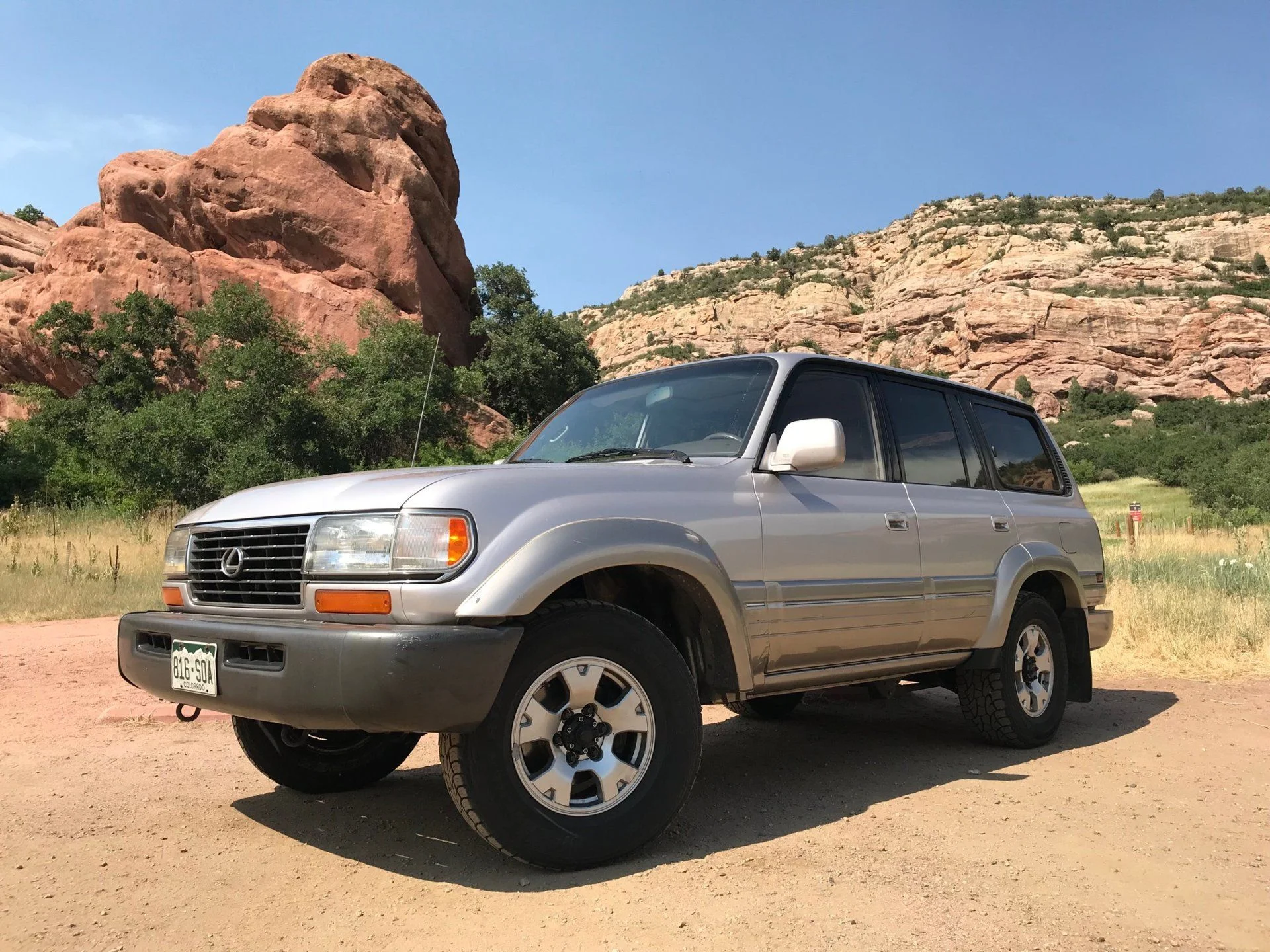

Hi all, I recently after about two years of looking and saving pulled the trigger on a 96 lx450. I recently moved back to the mainland from Oahu, and have been looking for a 80 for ages. I'm currently living in Denver, and would love to meet up with some people and find some trails, and wrench.
I was lucky to find a already baselined, and well taken care of rig. Here is a picture of the first trail we did, the Switzerland Trail in Nederland. It's amazing how capable this trucks are stock, even with the soft suspension.
New door trim moulding goes in tomorrow, I have already added a scan gauge. I'm considering having Slee install a OME lift, but I do have experience in building cars. I'm just concerned about the caster bushing install. I'm stoked to be apart of the community mud and in Colorado.
Thanks!
