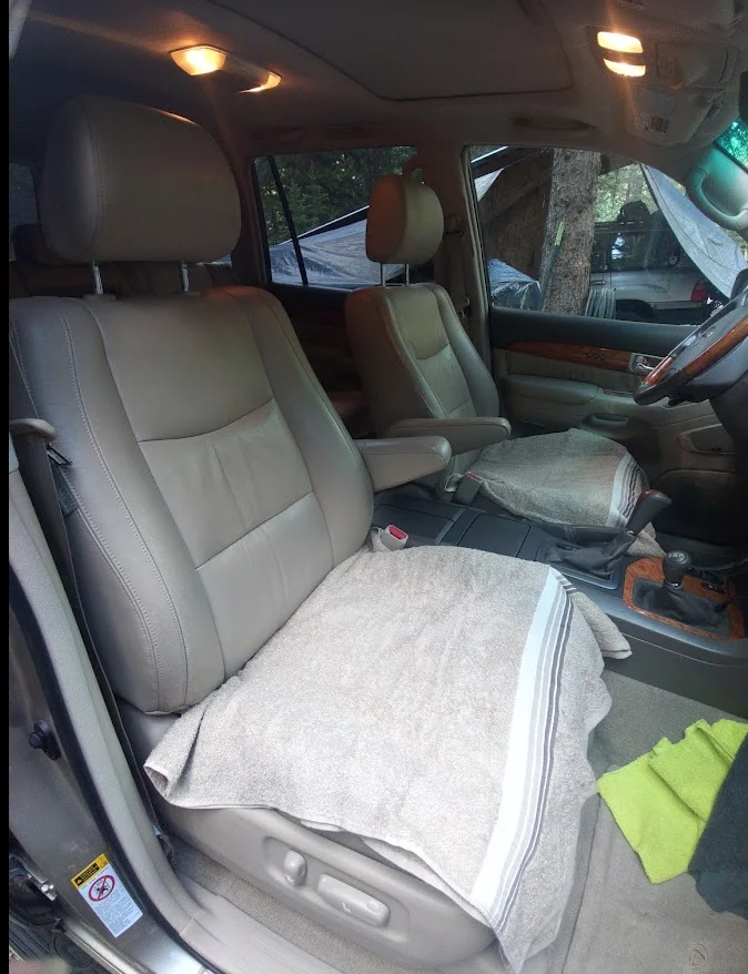

Next up, one of the classiest seat cover installs you will ever see. We still haven't decided if the dog is allowed in the truck. So far, he's not allowed
Undercarriage looks great, no real rust to be concerned with. The suspension bushings are a little bit cracked but otherwise all the rubber looks to be in good shape. I gave the engine bay it's right of passage by washing it all down and seeing if any parts cry out for help. Once I fired it back up I got a little squeak that went away after a few seconds . nothing to worry about, next time I'm in there I will see if the idler or something needs to be replaced.
