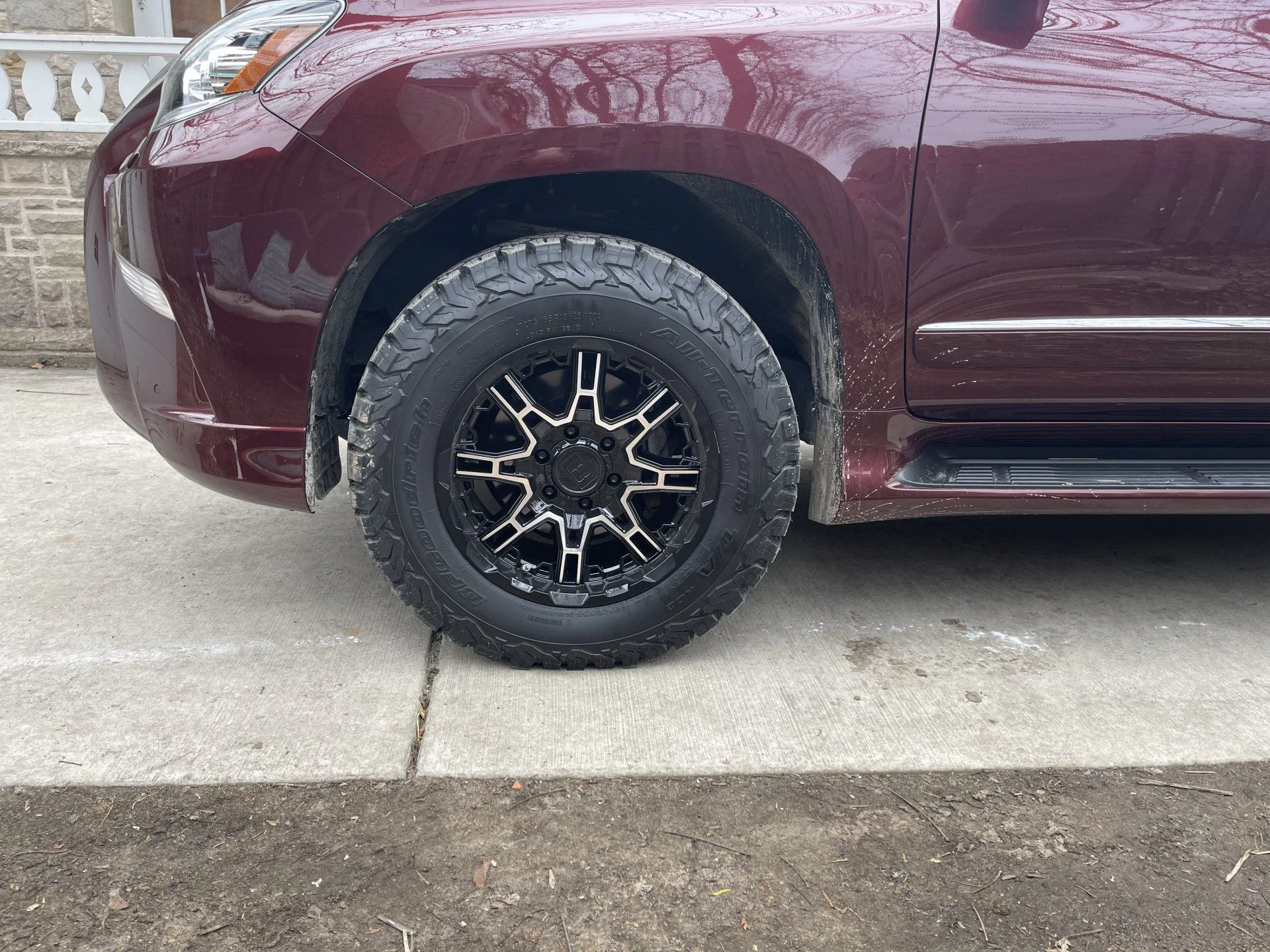

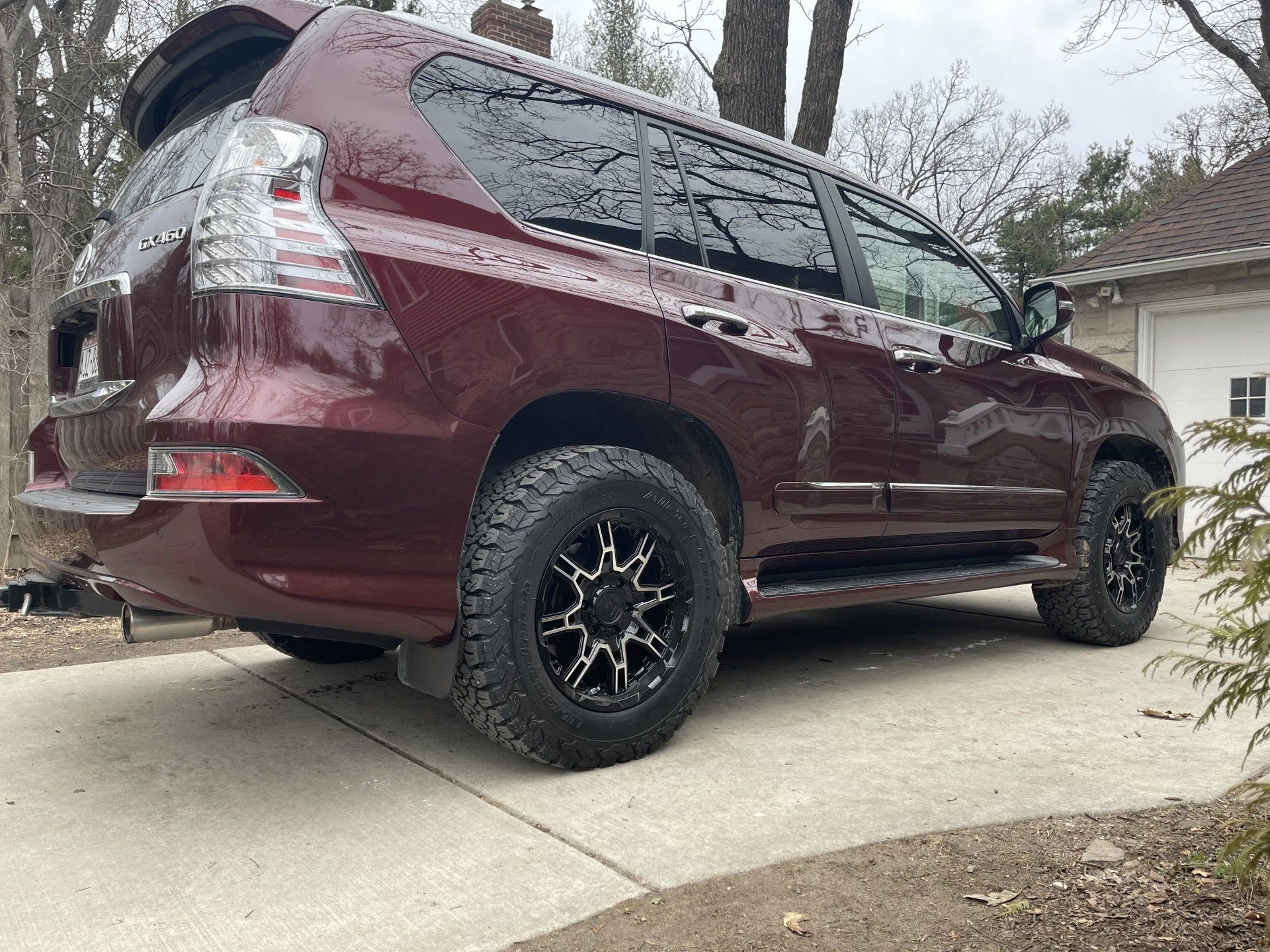

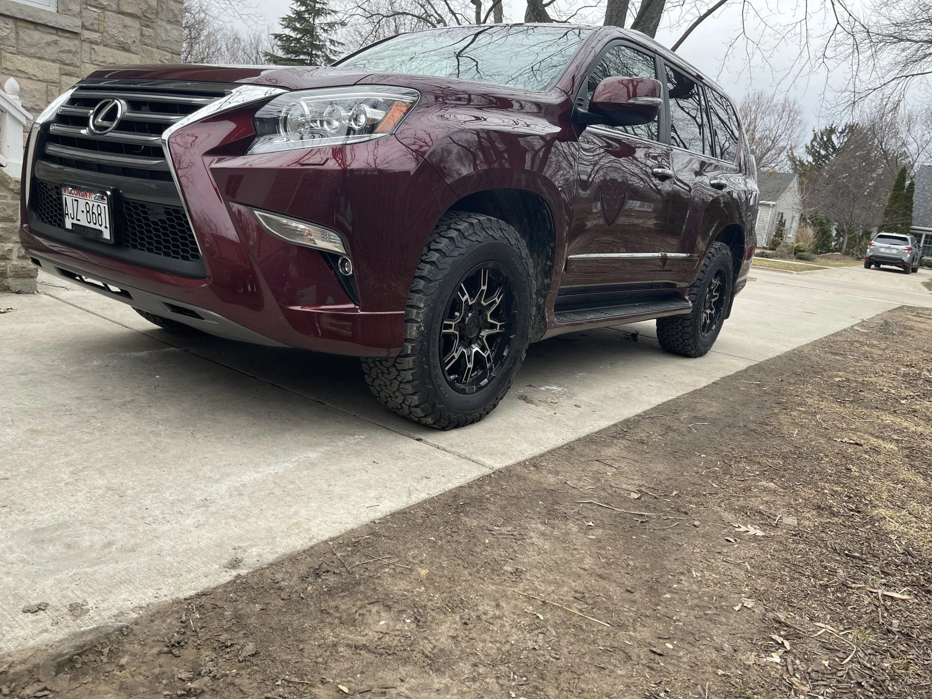

I just purchased a 2017 gx460 premium and wanted a little more clearance. After reading some threads on this site and elsewhere, I thought I would go with 275 65 18s in a BFG KO2. As others have indicated, it required some heating and a couple of bolt removals (one per side) on the wheel well lining. I have a couple of questions though regarding this setup on which people might have insight:
1. Tire pressure:
The KO2s I found are an E rated tire that can be filled to 80psi. The tech at discount tire said that 40 is ideal for my GX. He indicated that running a higher psi would unevenly wear the tires and cause a worse ride. I would have thought that a higher psi would make for better/smoother steering, less tire wear and better performance towing (and I two with some degree of regularity). Does anyone have any insight? I am planning on increasing pressure to 65 and seeing if that changes anything.
2. clearance in fender lining:
After massaging the wheel well lining, the clearance is still pretty close. I was wondering if snow would collect in there and cause issues. I kind plan on running snow tires since I replaced the wheels, but maybe not. I was thinking about lifting the vehicle a couple of inches with a lift kit, but am a little hesitant messing around with the suspension (especially the kdss). I would like more clearance but as it is I have a pretty good clearance at the front and rear bumpers and if these tires will ride well with stock suspension, I am inclined to keep it that way for now.
Thoughts?
Thanks!
