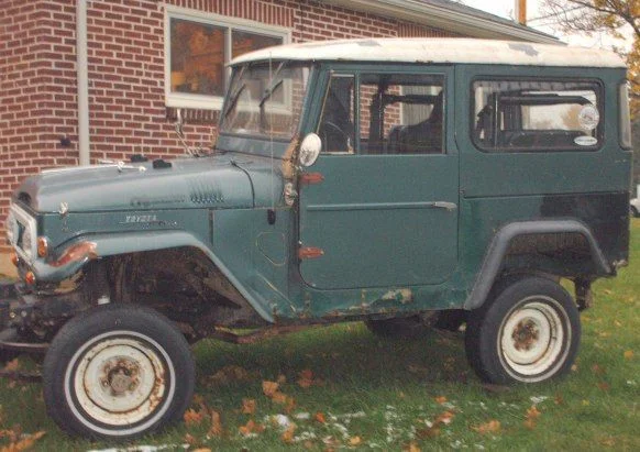

Looks like I'm the proud new owner of a new project :)!
I just bought Sean's '66 FJ40. Well, the body and frame atleast. I'll be picking it up sometime next month once I have a trailer lined up. I plan on doing a "frame-off" rebuild. Going to start with the frame (strip, galvanize, paint) and bodywork as that's what I have at the moment.
