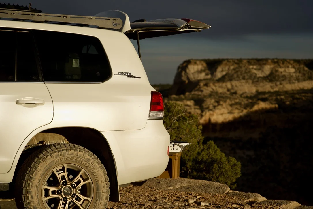

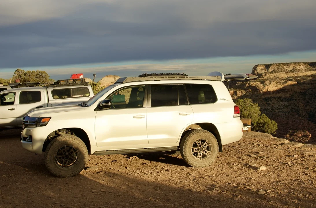

Hey all,
Been over a decade since I’ve been on these forums. I sold my beloved, Proffitt’s restored ’81 FJ40 here 12 years ago and haven’t been back much since. Been so long that I couldn’t even recover my old username…
Found myself eying Heritage editions this year and quickly pulled the trigger a few months ago on a nice one with with some pre-built additions that I had already wanted. Expensive, yes, but a great starting point for what I’m hoping is a very long-term vehicle. My wife hopes for this as well.
Previous Owner:
Icon Stage 6 kit (guessing a 2” + lift, but have no way to compare)
Ridge Grappler 285/70/18
LRA 12.5 tank (squeaky, unfortunately)
ARB twin compressor under the hood
Prinsu Rack
My Recent Additions/changes:
Slee Step Sliders
ARB drawers
New Dobinson rear coils to combat sagging under tow and camping loads and get back to a slight forward rake that was lost by previous owner
Ride height adjustments in front
1.25” Wheel Spacers (and some fender liner work)
Icon reservoirs moved to better locations, both front and rear
Prinsu accessories added for Maxtrax, awning, etc.
Rear door LED light install (thanks, @Brendan!)
Took it on her maiden voyage last week to San Raffael Swell for a 4-day off-road trip on both sides of I-70 and she was fantastic across the board, especially on some of the more technical terrain. What a beast. Wedge Overlook pics below.
Here’s my question/problem:
At some point when working on the ride height (lowering the front suspension primarily) and relocating the Icon reservoirs, I have developed a strange shimmy in the steering wheel at low-speeds. My local shop thinks it’s driver’s side CV that needs to be rebuilt/replaced, but they are also not positive. Curious if anyone here with a similar lift has experienced the following:
- At low speeds, when first accelerating from a stop, the wheel continuously jerks slightly (feels like running over small rocks or pothholes)
- Stops around 35-40 MPH
- Worse when accelerating heavily, but still stops around 40 MPH
- Doesn’t occur when turning
- Worse when towing
Basically, when the front end is lifted up at lower speeds/acceleration, the shimmy is very evident — especially driver’s side.
Would love any thoughts from this awesome forum before she heads back into the shop next Monday. Obviously, I want to fix it quickly, but am also curious if something in the set up caused this in the first place. I don’t want a reoccurrence, obviously.
Thanks a ton in advance for any advice.

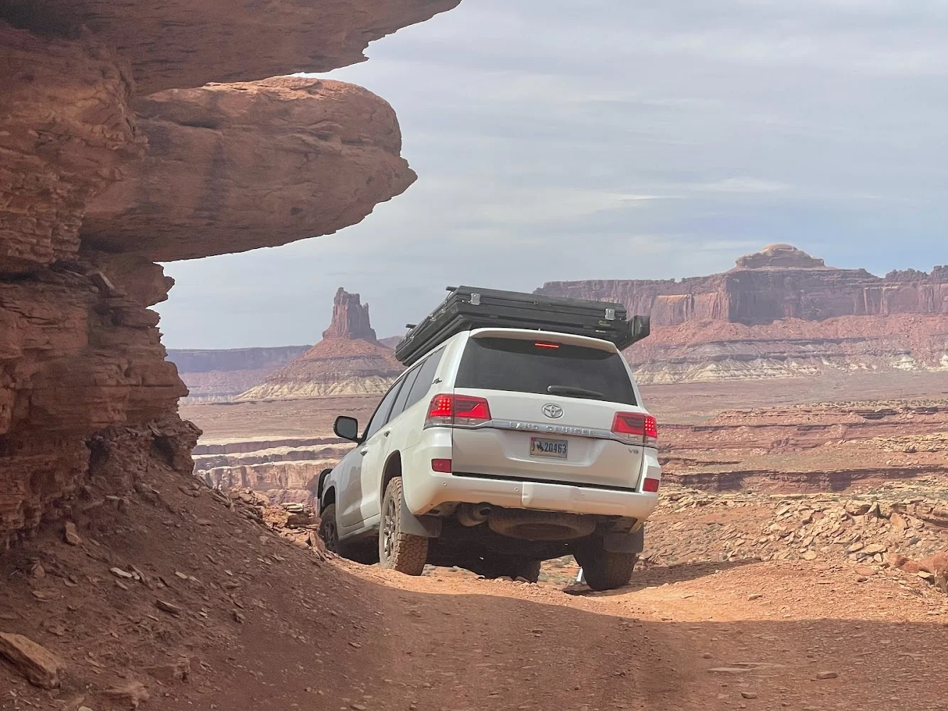

Great! You have a beautiful truck. But I'm Partial.
Can’t wait to hit Canyonlands as well. Sweet rig!
Yeah it was amazing. I wanted an aux fuel tank already but after that trip even more. We took White Rim and would have preferred to explore a couple more offshoots of the main trail but was limited by fuel range. Rolled back into Moab on fumes. Scheduled the aux fuel tank install when I got home.
